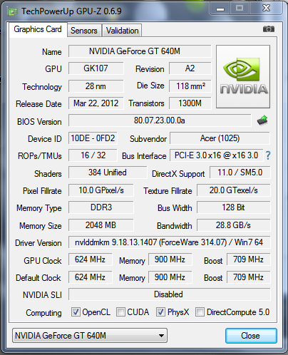

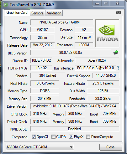

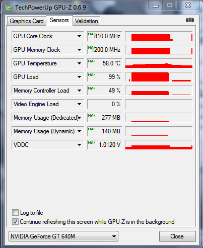

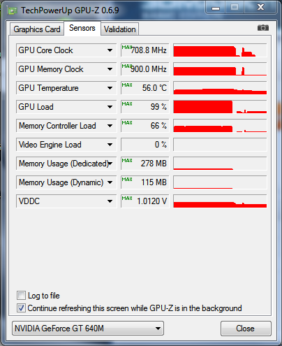

yeah, hello guys! my brother has got the Acer V3-571G. (i5-3210m, 8GB RAM, GT640m) so i told him that there is a nice vbios for the gt640m. i flashed it for him... and it works pretty well!! Before: NVIDIA GeForce GT 640M video card benchmark result - Intel Core i5-3210M Processor,Acer VA50_HC_CR score: P1821 3DMarks After: NVIDIA GeForce GT 640M video card benchmark result - Intel Core i5-3210M Processor,Acer VA50_HC_CR score: P2059 3DMarks (i only overclocked the memory of the GT640m to 1200mhz. the core ist the ''stock'' from the modded vBIOS) games run much smoother now! BIG THANKS AGAIN svl7, for the great work!!! -

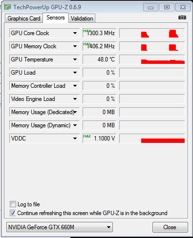

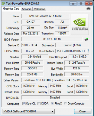

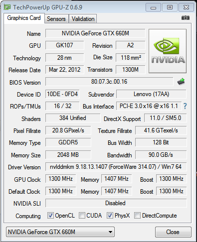

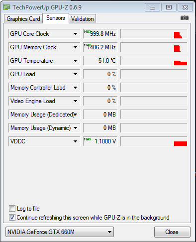

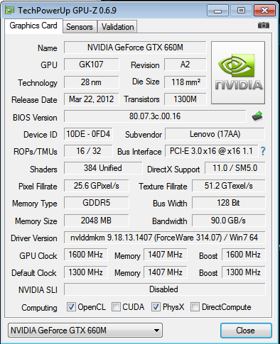

hello guys i think i could mod the vbios with the clocks i want for the 660m but for some reason the core clock stays at the 1 ghz and the voltage stays at stock 1,1 V, although i changed it both in the vbios! so i have to add 300mhz with msi afterburner to get 1300mhz core... then it runs stable at 1300mhz.. but then i also got this?! so svl7, why the voltage and core-clock isn't changeable? what did i wrong? any ideas?
a few posts before you wrote ''The CPU has a cracked corner'' maybe thats the cause, i don't know or the gpu doesn't gets enough power and needs a bit more voltage... you replaced the i5 with a i7... it seems like the i5-version of the Y580 hasn't got the same power supply.... but i don't know, please take a look at your power supply and tell us the specifications (input, output, whatever)
