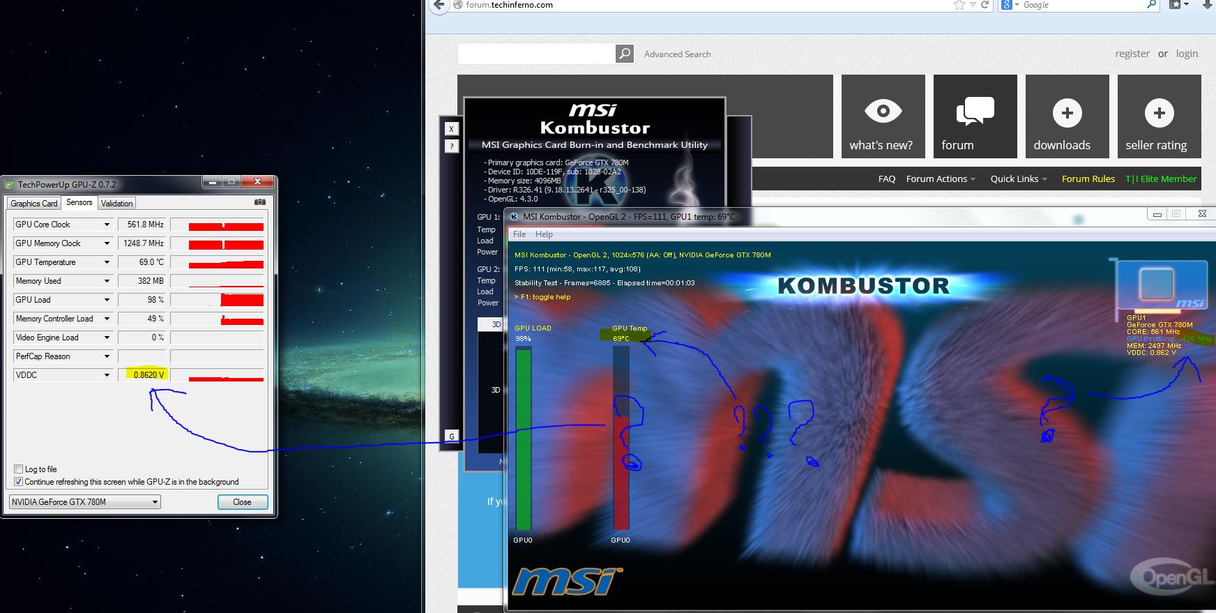

That means it's throttling in the game if it just sits at 92c, the GPU will throttle the core by 50% for a second or so until it drops back under 92c. Running Kombuster i hit 92c on the Extreme setting, i'm not sure if it's that the cooler cant handle it, or if it needs a repaste, i could have sworn i did it well.

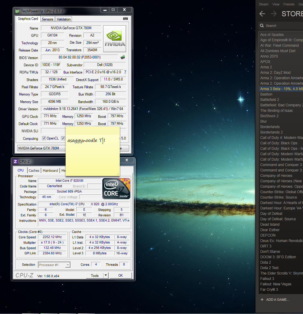

And the moment you have all been waiting for; SUCCESS!!!!! MORE TESTS AND BENCHMARKS TO COME SOON!!! -
