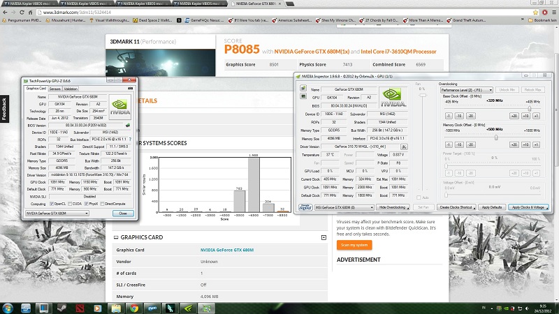

  22. Sorry about the screenshot since this forum only allows me up to 800 x 600 which is 4:3 in aspect ration but my screen is 16:9 in aspect ratio so it's smaller when resized. Nah, I like Nvidiainspector being simpler and allows us to tweak a game profile from the driver It is as easy as using Afterburner. Simply click 'show overclocking' when you open it and then slide the slider to the desired value and then it's done My clocks were 1091 Mhz in core and 2300 Mhz in memory. The offsets were + 320 in core and + 500 in memory. I assume you use the latest vbios made by svl7. Well, that's rather low score. What were your clocks ? Indeed, thank you very much svl7 and keep the good work up
  23. @Bryan I don't think I would use it for daily use. The temps were peaking @ 87C when tested with 3dmark11. I might have bad paste because Shinetsu X23 is very hard to apply @omege939 You mean like this ? I am sorry I am bit new to this stuff
  24. Did that and finally found my limit @ 1091 / 2300 with the new vbios. Racking up to 8500 in graphic score and breaking the 8000p barrier score, I couldn't be happier NVIDIA GeForce GTX 680M video card benchmark result - Intel Core i7-3610QM Processor, MS-1762 score: P8085 3DMarks
