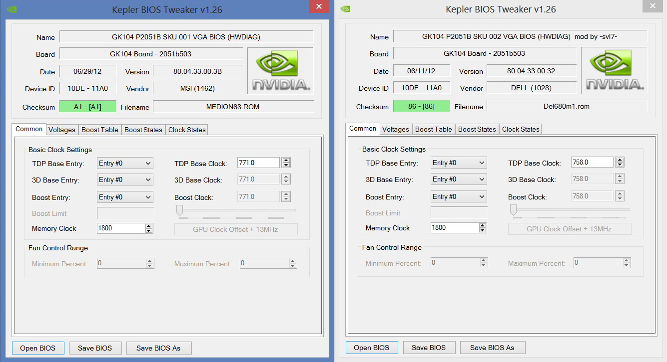

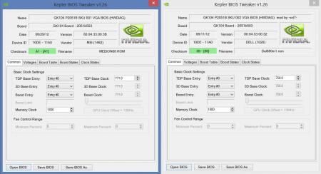

  2. Yeah I did listen, I used Svl7's Dell vbios which is a 2gb version, and I checked the VBIOS version numbers. The last digits don't match, just look at the pic below Remember you are talking to a noob here... so could you be a little bit more clear with the modding of the inf of the driver?
  3. Well I went ahead and tried to flash the 680m with both svl7's Dell and MSI vbios no succes... I first tried the MSI vbios, it wouldn't even let me use this one! And as second I tried the Dell vbios the flash went fine but windows did not recognize the GPU anymore Thank god I made a backup! I'm now looking in to editing the vbios myself with Kepler bios tweaker, But I have no Idea what I'm doing, well kinda... Is there a tutorial or something here on the forums for editing a vbios?
