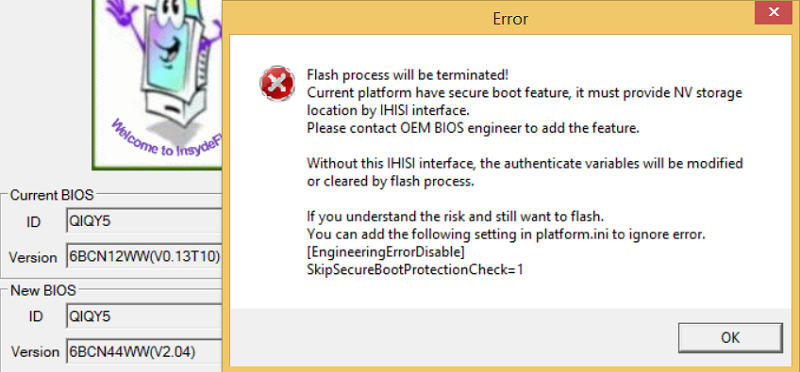

Hi all, thank you for your help but I think I've done it. What a piece of work. Using the Insyde installer from Lenovo's website, I had to do the following: +replace bios filename (V2.04) with the V1.05 version I found, +add the EngineeringErrorDisable switch to bypass the IHISI and whatnot error I was having, +change two EC settings (as I was then prompted with an EC error after getting rid of the old one) She updated, and then updating from V1.05 to V2.04 was business as usual, though the computer did hang on an all-white screen after it was finished, forcing me to remove the battery. I had to change the support back from Legacy before windows would boot but anyway, it's done. Thanks again

Thanks, but that did not work. Perhaps I did something wrong? I followed this guide specifically, and was returned the same error code posted by another user at the bottom of the page (in the comments section): https://forums.lenovo.com/t5/Welcome-FAQs-Knowledge-Base/How-to-flash-InsydeH2O-EFI-under-DOS-enviroment/ta-p/278406 I am certain that I am using the correct BIOS for this unit, as I've done this on this machine once before without any problems. I don't know why this time is this way. -
I tried flashing from a DOS USB boot stick. Specifically, I followed this guide: https://forums.lenovo.com/t5/Welcome-FAQs-Knowledge-Base/How-to-flash-InsydeH2O-EFI-under-DOS-enviroment/ta-p/278406 And, of course, she didn't work. I was returned the following error: "Error: Not support AT-p information CL Registry:0x0." I'm at a loss. I hope there's something I'm missing or not doing correctly.
I just went back in there to look, but I do not have that option! The only thing I have is UEFI boot (which is enabled) and that is required for Windows to boot, of course.
soldatdescieux replied to svl7's topic in Lenovo
Thank you for all your hard work that went into this. I can't wait to try it myself but I do have a question or two. I understand flashing only the modified bios of the same version as that of the machine (ie 2,04 modded over 2,04 original only). But, what if I cannot even get the bios to update in the first place? The bios on my machine refuses to update, period. She always gives the following error: Flash process will terminated! Current platform have secure boot feature, it must provide NV storage location by IHISI interface. Please contact OEM BIOS engineer to add the feature. Without this IHISI interface, the authenticate variables will be modified or cleared by flash process. If you understand and still want to flash. You can add the following setting to the platform.ini to ignore error. [EngineeringErrorDisable] SkipSecureBootProtectionCheck=1 Naturally, I did attempt to add those lines into that file (convenient thanks to svl7 ) but she persists. My bios appears to be 6BCN12WW(v0,13T10), as displayed by InsydeFlash (can grab a photo if need be). v0,13T10?? In any case, I'm afraid to touch anything without any of your insights, even the 650M bioses, because this is unit was already replaced once due to a faulty mainboard (and Lenovo made me pay for it despite it being a common problem with their machines). Not sure how related it is, but since getting this new mainboard I have lost the ability for keyboard backlight and Novo button (off the top of my head). -

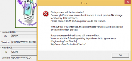

Hi, and thanks for your time =) I'm attempting to flash the bios on my Y500 but am having an impossible time doing so. The first time, I had zero problems. This time, not for the life of me. See, my Y500 had to have her mainboard replaced. Upon booting, it was evident that this board has a much older bios than the one I used to have (Lenovo bios splash screen is completely different, older). When running the update installer from Lenovo's website, this is what happens: I'm not sure if I did it correctly, but I did manage to find all the files in my Temp folder and added the lines to the file which the error states, and still nothing. I even managed to find a v1.05 bios and the same thing, nothing. Any ideas? Thanks
