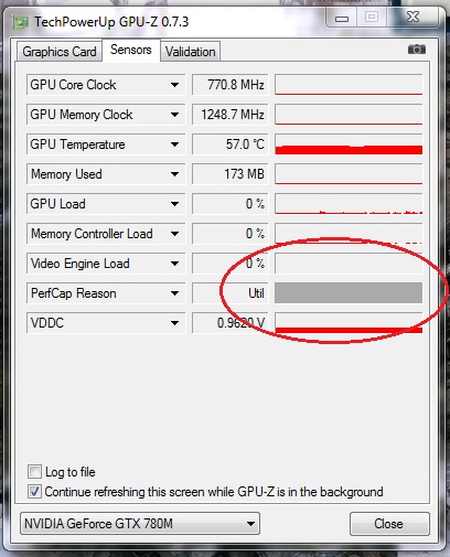

  4. U got this also? I noticed that the limit drops to zero while gaming. Is this something similar to turbo boost for CPUs? But opposite. I.e. It downclocks when not at load then goes back to normal when in game?
  5. general... for the best gaming results i should use the 327.23.......... and bf4 ONLY, i should use the 331.40? sooooooo, i installed the 331.40 drivers right... and i switch on gpuz to see what's up and i see this: any idea what that is? my guess is that its just saying that the card's not running at full or something and doesnt limit the card when i play a game because when i play a game, the bar drops to nothing.

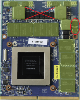

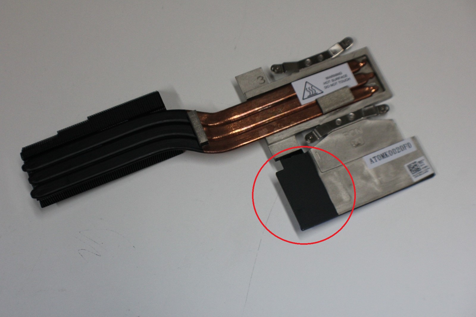

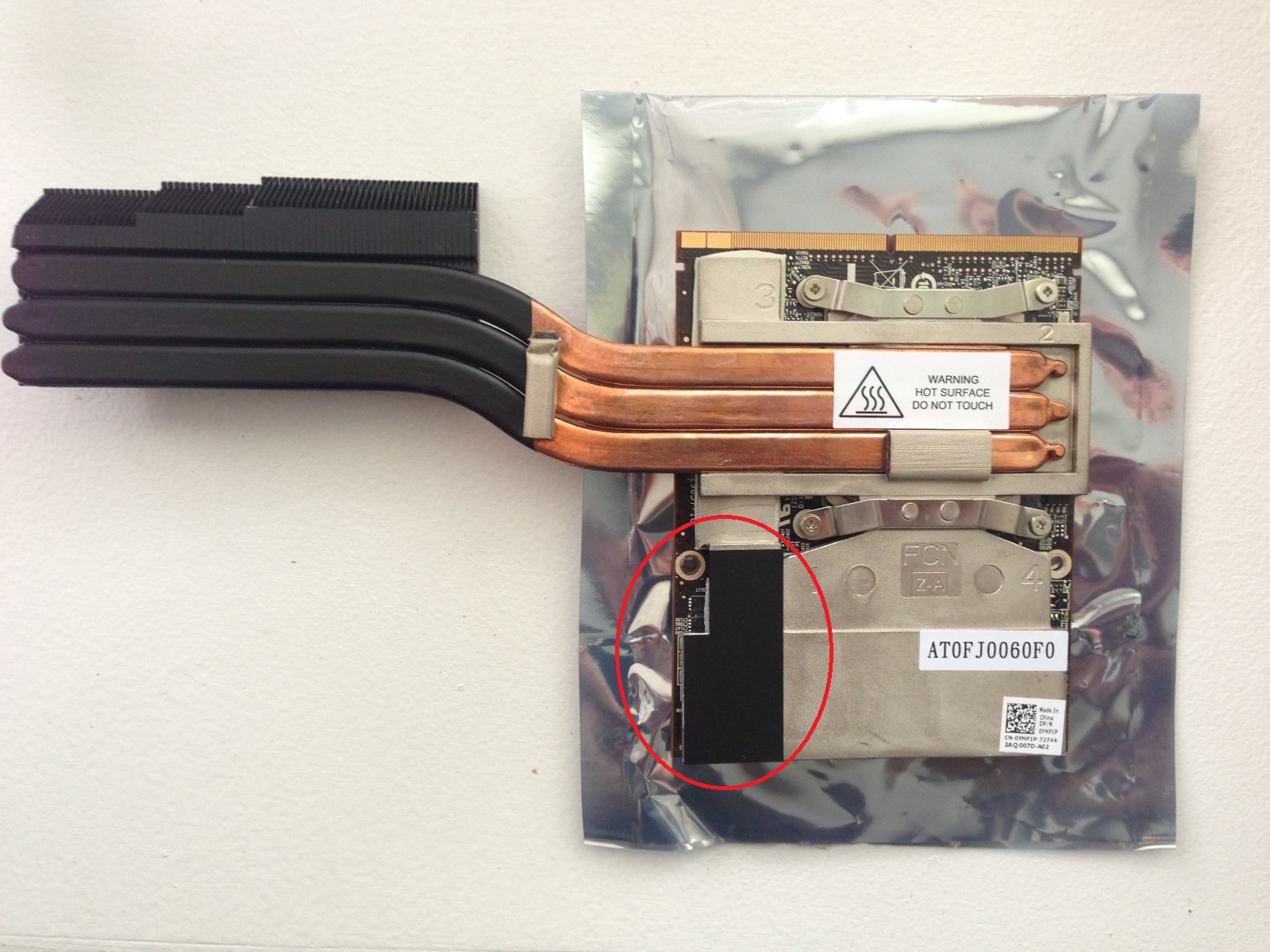

  12. ok, so i got the 780m and installed it. My amd heatsink worked fine like J95 said it would, but, i have ONE VERY IMPORTANT QUESTION... in this pic on page one, there's an "X" and a circle in it. the 2 chips that are circled to the right, the AMD heatsink doesn't fit over both. only over the upper one. so what i did was just put the thermal pads over both and put the heatsink on the upper half, but the lower half is still exposed, but with a thermal pad over it. ALSO: I understand that the thermal ad placement is important, which is y im so concernet for this. Please, I would really like your help on this. I'm so confused...... The differences in the heatsinks can be noted in the pics below: you can clearly see the difference in the length of the metal plate to the left end circled in both pics. Thank you in advance

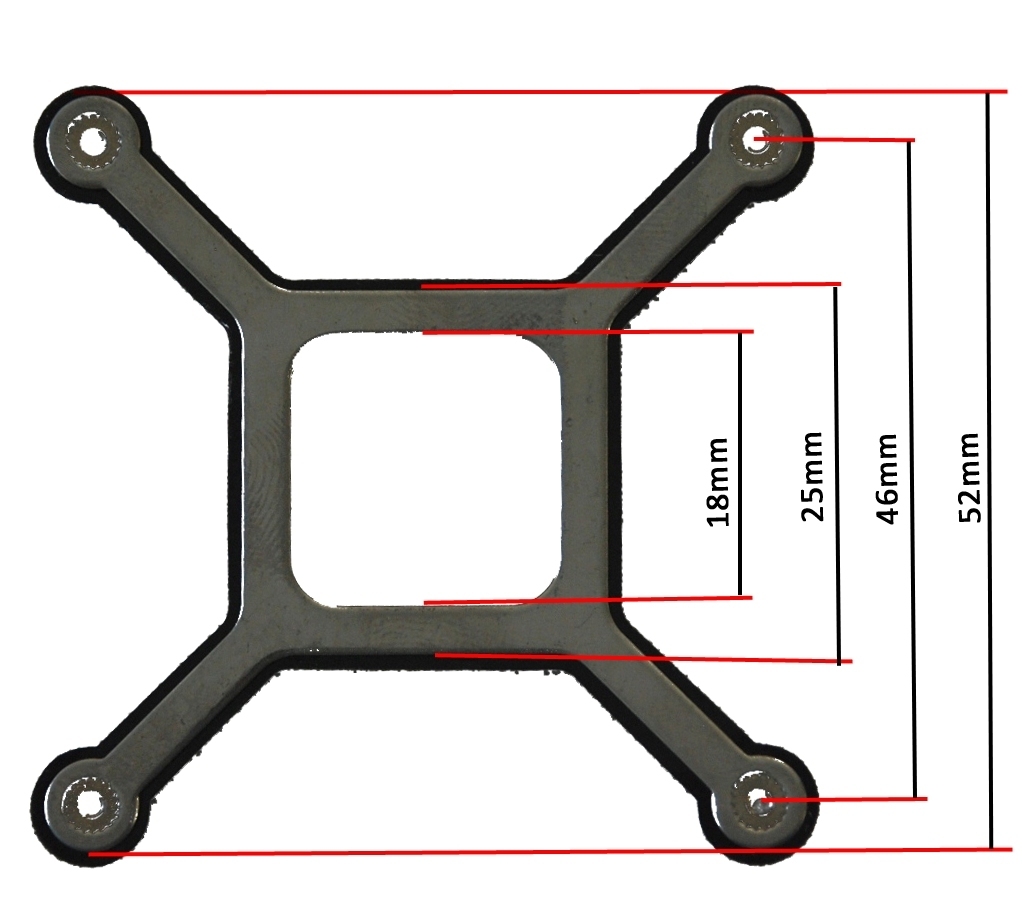

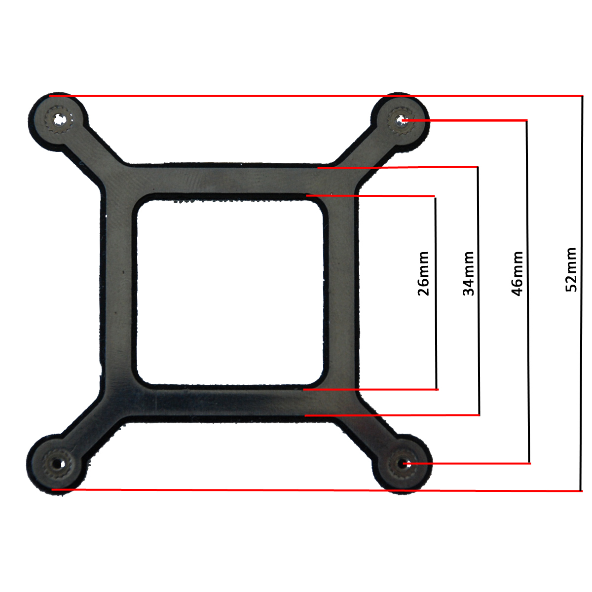

  13. Fyi: I got an answer from someone; thanks for the help with my previous questions The difference between the AMD X-bracket and the NVIDIA X-bracket is that the chips on the back of AMD and NVIDIA cards are different and are therefore laid out differently. If you put am AMD X-bracket on the back of an NVIDIA card, the spreader will not lay flat as chips will be in the way. The differences in the spreaders can be seen below: AMD: NVIDIA: The screw locations are the same, however the spreaders have different dimensions to accommodate the card they are going onto. NVIDIA manufacturers know not to put any diodes/ chips in the areas reserved for the spreader and AMD manufacturers do the same. You cannot put an AMD spreaders on an NVIDIA card and vice versa. The screw holes would line up as you can tell from the pictures, but the spreader would not lie flat as chips would be in the way. I swear I never knew that.
