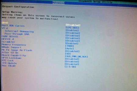

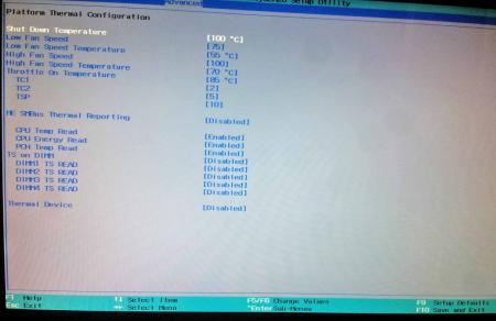

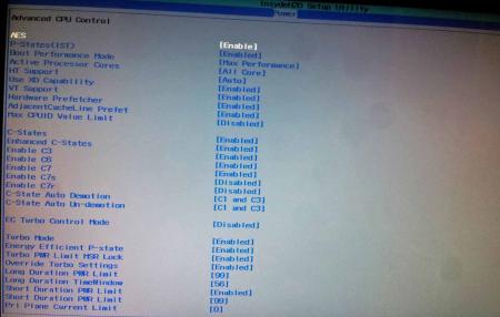

  2. . Read this link before continuing: http://forum.techinferno.com/alienware/2252-information-about-bios-updates-a07-a08-higher-m14xr2-m17xr4-m18xr2.html M17x R4 and M18x R2 users already have the possibility to further tweak their systems with the help of a modified bios... so let's not forget about the M14x R2 users Dell has hidden a lot of options in the BIOS of the Alienware M14x R2, the modified BIOS versions here will show you all the hidden menus and allow you to further tweak your system and optimize its performance. Don't change anything you're not familiar with. There might be functions available which don't work on your system, so use this BIOS with care. It should only be used by advanced users. In case you mess up and your system refuses to boot after applying the changes you make, remove the AC adapter, battery and coin cell battery in order to clear the non-volatile ram of the BIOS. This should fix most issues. Believe it or not, creating such mods is rather time-consuming. If you appreciated this work feel free to buy me a beer * Donate * Download links for the unlocked M14x R2 BIOS versions: M14x_R2_BIOS_A03_-_[unlocked].zip Here some pictures of the most interesting options and menus. Thanks @Mehtaparth94 for providing the pictures! ********* Flash and use at your own risk. I don't take any responsibility for any possible damages on your system. ___ M14x_R2_BIOS_A03_-_[unlocked].zip
