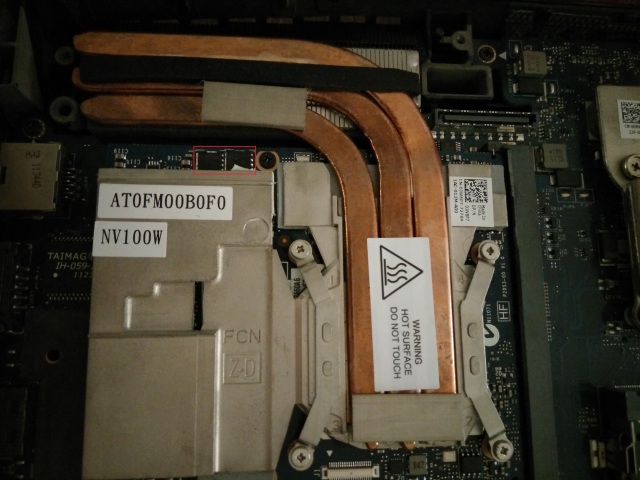

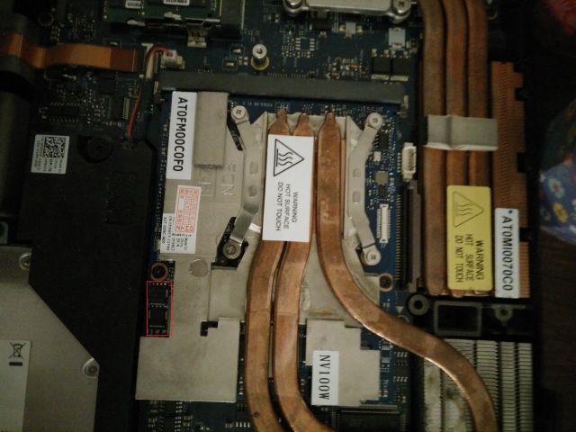

M18xR1 with GTX 880M
The gtx 880m gets very hot under load.
Your temperatures are a high but not critical.
I would repaste your gpu.
do you use a 100w heatsink for the gtx 880m in your aw 18?
yes i have 100w heatsink, i repaste it and have max 86c, is normal for this card to have 86c?
heatsink is from GTX 580M, my friend have GTX 680M and max temp on high use is 75c, is a option to make this card to have max 80c?
Probably the Heatsink is old and faulty.
Another option is repasting the gtx 880m or downclock it a little bit.
Also you can use Fan control.
I would say that's a bit high, mine M18x R1 880m SLI was hitting 82 with the 580ms heatsinks. I've done another repaste, and it's around 75-77 nowadays.
