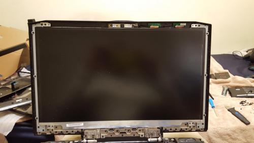

    This should be what you're affronted with next if all went well. Notice the four screws and holsters around each edge. We'll take a closer look.
    Here's the screw and holster on the upper-left side. See the little stick poking through? When securing your 4K AUO screen be sure the stick goes through it. I won't show the right-side because that'd be a little too redundant so lets look at the bottom screws for the panel.
    Bottom-left
    Bottom-right
    Now that we've identified, place a soft preferably foam material down between the screen and the base of the machine. Lean the screen back to reduce the chance of it unintentionally flopping forwards once unscrewed. Follow-suit and then gently lean the screen forwards and then lie it down. I wouldn't use only a single hand especially if your panel is still perfectly-fine. Be careful from herein if you weren't already.
    The back frame w/o the screen. You can see all the connections here from the camera to the lighting assortment.
