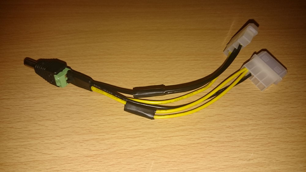

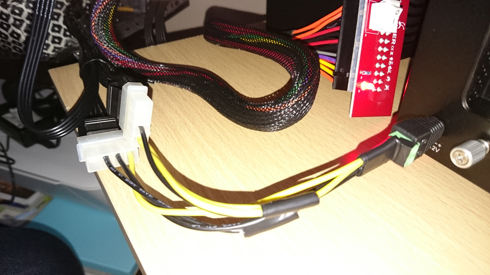

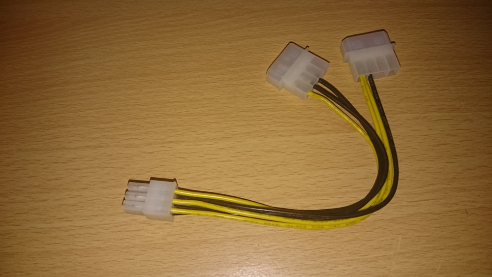

  1. Create a Molex to barrel cable following this guide.
  2. Insert the graphic card in the AKiTiO Thunder2 PCIe Box.
  3. Insert the jumper switch in the PSU.
  4. Connect the AKiTiO Thunder2 PCIe Box with the molex to barrel cable.

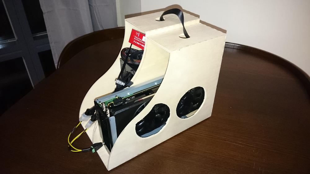

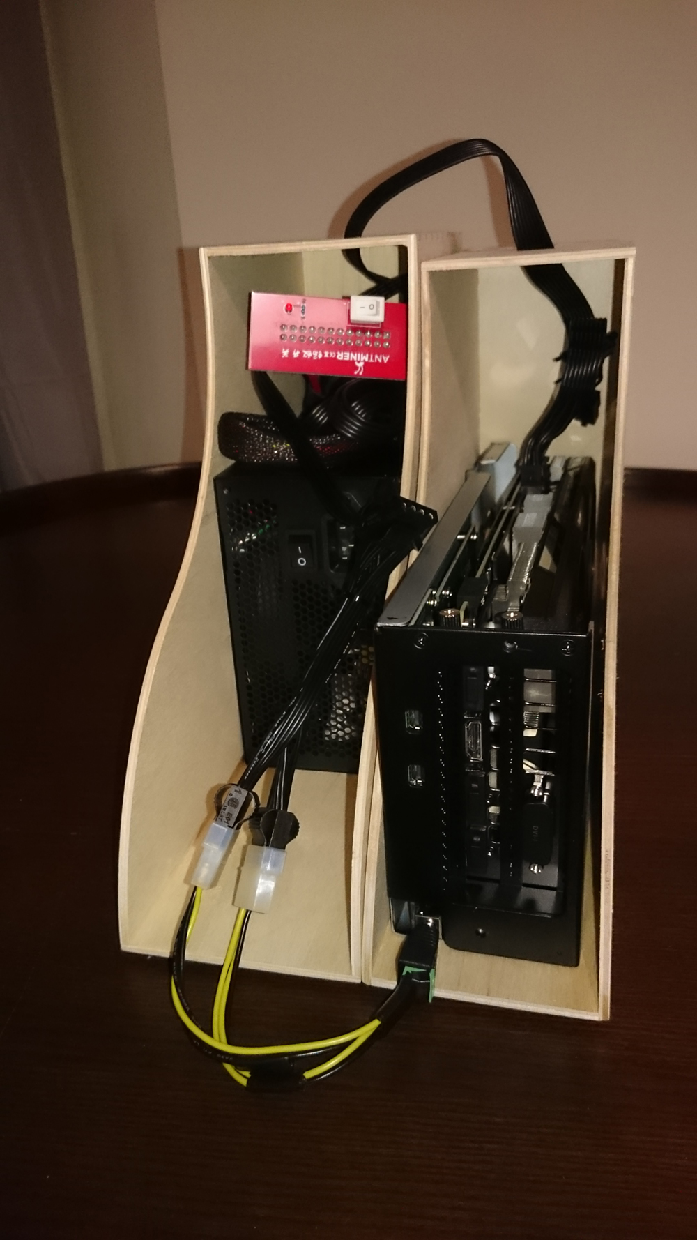

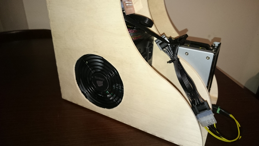

  • My GPU is too big for the Akitio Box. I didn't want to have the CPU and the GPU without anything. I created a temporary case with a magazine file set I bought in IKEA. Sorry but I am not allowed to upload more pictures in this post!

In a future I want to improve the overclock in the card, change the PSU like you said or think a proper case for everything (but all the options I've seen need a riser) but for now time to enjoy it.

Hey, nice build but i want to ask something, the molex to barrel adapter you just made, i noticed you put a total of 2 yellow wire and 3 black wire, why not put 2 black wire? And why use 2 yellow wire? Will it have over volatge? Because 1 yellow is 12v 2 yellow means 24 v? Thanks
