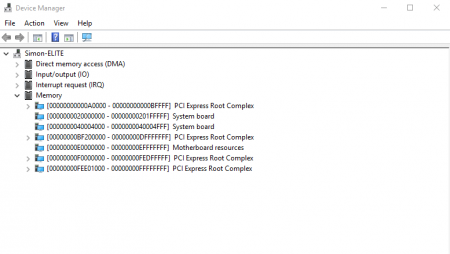

In windows 10 is the PCI Bus called the 'PCI Express Root COmplex' ?
dsdt2.thumb.png.8bbfb9c39675a79597f35eb1

So I found the last resource for the 'PCI Express Root Complex' and have inserted the QWORD entries under:
DWordMemory (ResourceProducer, PosDecode, MinFixed, MaxFixed, Cacheable, ReadWrite,
                    0x00000000,         // Granularity
                    0xFEE01000,         // Range Minimum
                    0xFFFFFFFF,         // Range Maximum
                    0x00000000,         // Translation Offset
                    0x011FF000,         // Length
                    ,, , AddressRangeMemory, TypeStatic)
        QWordMemory (ResourceProducer, PosDecode, MinFixed, MaxFixed, Cacheable, ReadWrite,
                   0x0000000000000000, // Granularity
                   0x0000000C20000000, // Range Minimum,  set it to 48.5GB
                   0x0000000E0FFFFFFF, // Range Maximum,  set it to 56.25GB
                   0x0000000000000000, // Translation Offset
                   0x00000001F0000000, // Length calculated by Range Max - Range Min.

The names of the devices in windows 10 is different to what is in that guide. I just compiled and loaded with 'asl /loadtable dsdt.aml '
however no 'large memory' entry is no in the device manager.
