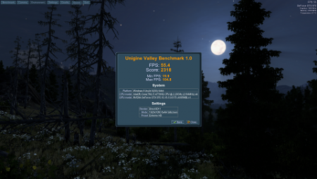

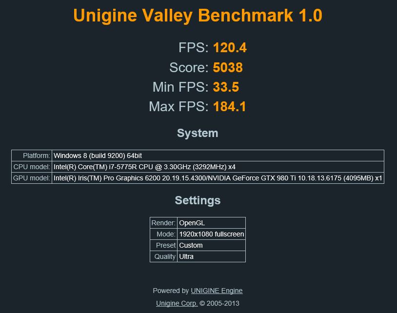

Heaven 4.0: Extreme settings at 1920x1080 with extreme Tess. and 8x AA
GPU OC: +190/+350
Score: 1310
Valley: Extreme HD settings 1920x1080
GPU OC: +190/+200
score: 2318
Firestrike:
+150/+200
Score: 8980
ext.thumb.JPG.61da174d5ff58f625400fae29f
+190/+200
Score: 9154
FirestrikeExt190200.thumb.JPG.afaddda5c4

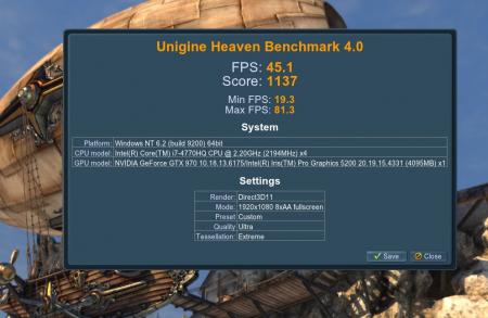

Windows 10 Optimus
Heaven: same settings as above, +150/+200
Score: 1137
~13% performance loss
HeavenInternal.thumb.jpg.3aa788d5b6dde7f

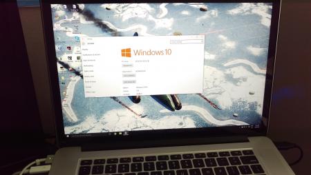

CAN CONFIRM OPTIMUS NOW WORKS!!!
Tested on Warframe and the game looks nice on the internal screen (yay).
To get Optimus working on Windows 10, install driver version 361.75 released 1/27/2016

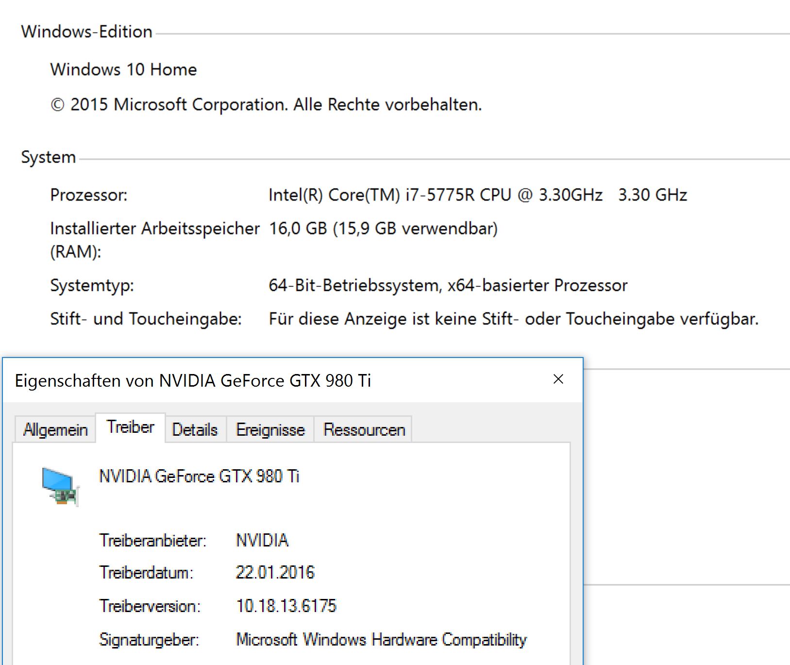

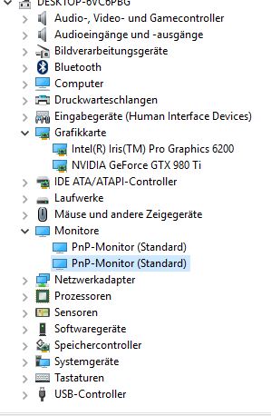

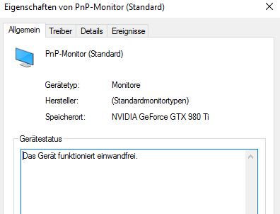

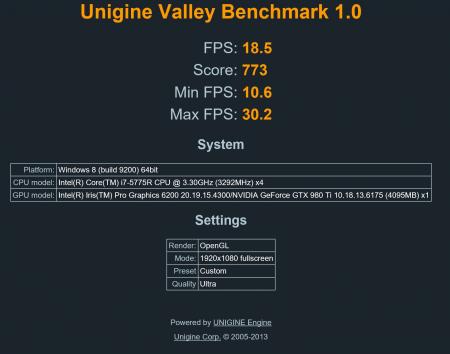

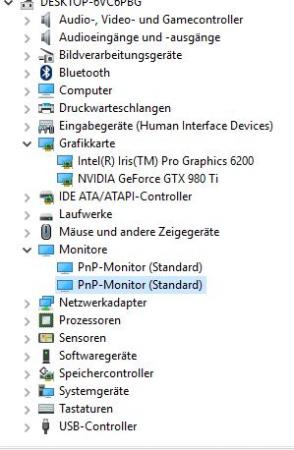

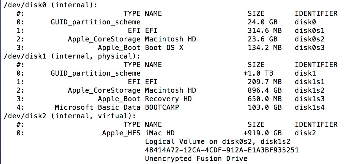

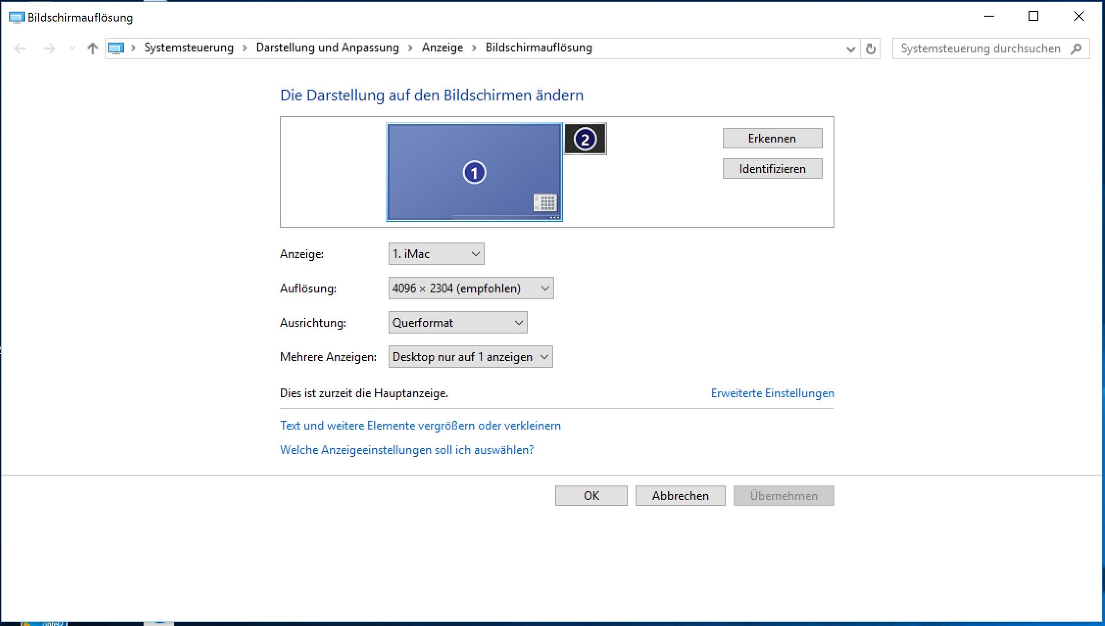

Hello ZapCord,
today i followed your guide and installed Windows 10 on my iMac with BootCamp on a 1TB Fusiondrive.
The installation and the described boot sequence works fine (from 10 tries the system comes up 9 times without any problems).
Is this correct that the internal monitor still uses the internal graphics card and only the external monitor will be powered by the 980 TI?
I have tried both: cloning the display (both monitors showing the same) and extended display.
If i look into the preferences, there is still the intel graphics card (see screenshots).
Is it possible, that both displays running with the nvideaß
Greetings Stemoac

@stemoac Greetings!
It is very much possible to run both displays with nvidia.
However, the internal display will not show the egpu as its display adapter.
-That is due to the fact that the internal display is connected to the integrated graphics no matter what; however, the brunt-work is still handled by the egpu.
You can see this in the spoiler below.
-Notice that the score is a little bit less than the one I posted above in my original post as it is run on the internal monitor.
-That is due to the inefficiency of having to route all traffic through the integrated graphics no matter what for the internal display.
I hope this clears it up!

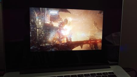

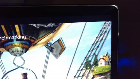

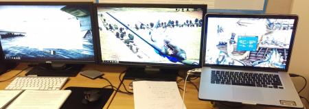

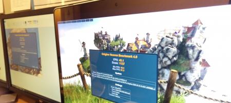

Spoiler
Here is my internal display accelerated with the egpu while having 2 other monitors connected to the egpu.
I ran Heaven 4.0 on extreme settings at 1080p for comparison with the scores above. Note that I did lower the overclocking from +190/+350 to +150/+200.
So, compare the internal monitor's score of 1137 here to an external monitor's score of ~1295 with those overclocking settings.
HeavenInternal.thumb.jpg.bd923f00ce1b62f
IMAG0968.thumb.jpg.d11c94bfb3fd011be5887
IMAG0971.thumb.jpg.8a0a34a1bca298b625971

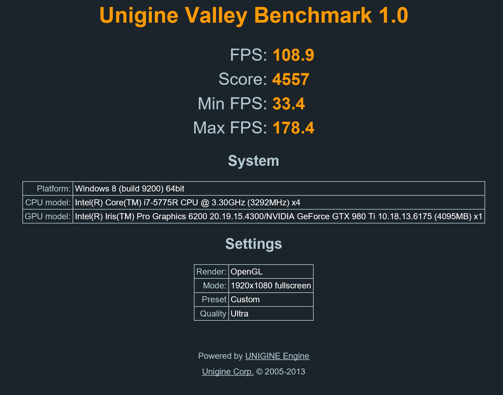

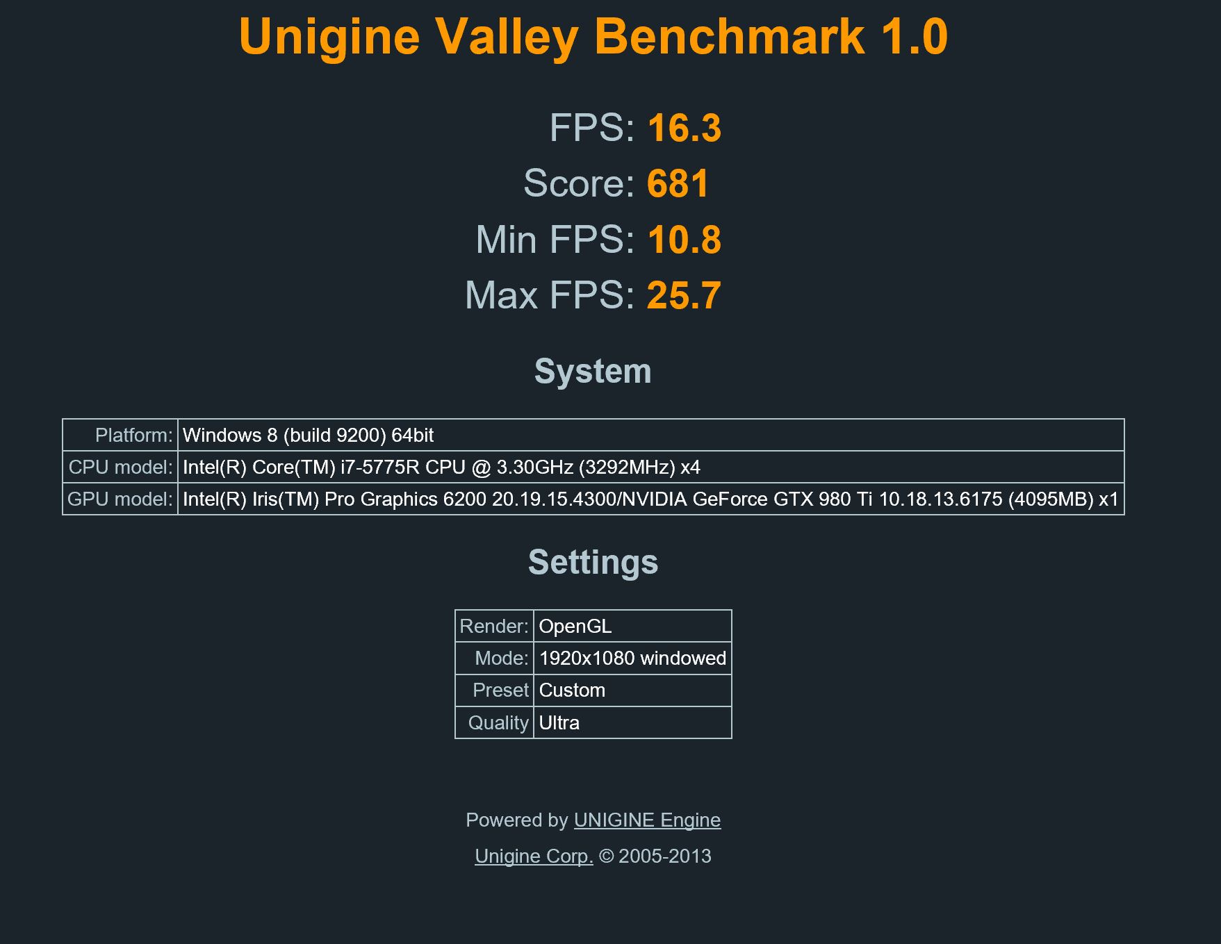

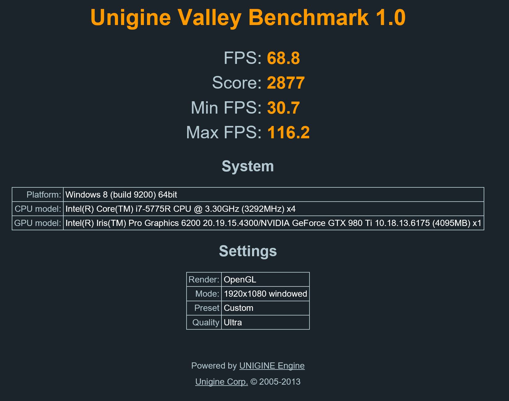

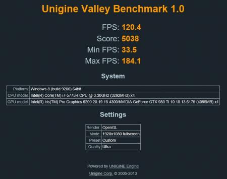

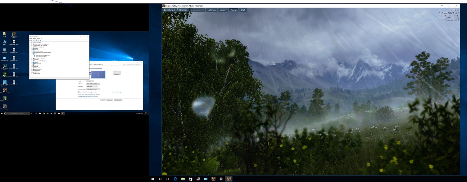

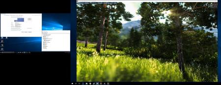

Here are the Benchmark results:
- test case #1:
external Monitor connected (via HDMI) to eGPU
external Monitor is main Display (Extended mode)
Resolution: external Monitor (1920x1080), iMac Display (4096x2304)
Benchmark in Fullscreen on external Display
- test case #2:
Benchmark in Window mode on iMac Display
- test case #3:
iMac Display is main Display, only Output to iMac Display (not extended), external Monitor not used
- test case #4:
external Monitor is NOT connected (unplugged HDMI) to eGPU
only iMac Display
Resolution: iMac Display (4096x2304)
Benchmark in fullscreen mode

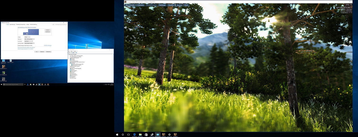

56b346abb56ed_screenshot2(resized).thumb56b346673ee0a_screenshot1(resized).thumb56b3474f2a774_screenshot3.thumb.JPG.0c14
here are the screenshots from the valley Benchmark
screenshot 1 belongs to testcase #2, on the right is the iMac display (Fullscreen Output from snipping tool)
size off apps and other Elements sets to 200% in Windows 10
screenshot 2 and screenshot 3 belongs to testcase #3
i resized the original screenshots (size 6016x2304) to 25% (upload Limit reached)
- test case #5
external Monitor is main and only Display (internal Monitor not used)
Well the conclusion is, Optimus is not working with your current setup.
Are you running Windows 8 or 8.1? Are you comfortable updating to Windows 10? Optimus seems to work there with the current driver.
For Windows 8.1 Optimus might need a little help to work: https://www.techinferno.com/index.php?/forums/topic/6727-guide-macbook-enabling-optimus-internal-lcd-mode/&page=1
@stemoac interesting, maybe try booting up with only the egpu and internal monitor connected at first (same procedure) and then connect the external monitor to the gpu after boot.
You'll get a few screen flickers right after boot but it is ok.
Are you sure you are using driver version 361.75?
My setup during the test was:
GTX 970 with 361.75 (none of this worked pre 361.75 and the computer was using integrated only on internal display)
2 1920x1080 external monitors connected by DVI
Internal display was primary display.
-All of these were on extended display mode.

2 hours ago, xorgal said:
Just finished assembling my build couple of days ago and also didn't manage to run e-GPU on internal display using Windows 10.  Downgrade to 8.1 fixed problem with first boot! :) 15" MBPr (2014) + Akitio box + Zotac GTX 970.
Anyways, time for me to upload my proof.
Using this Boot procedure:
58 minutes ago, ZapCord said:
Interesting that a lot of people aren't able to get Optimus working in Windows 10. I am honestly surprised.
Another boot procedure that works (for me):
-external displays aren't plugged in to start
  1. connect thunderbolt cable from egpu to laptop
  2. boot laptop while holding alt to get to boot select screen
  3. Start EGPU
  4. wait 30 seconds
  5. Select Windows
    1. Once Login screen is reached, plug monitors in if external displays are needed
    2. Otherwise, just log in
I hope this helps someone.
EDIT: And no, I did not use Evo's guide to enable optimus
IMAG0981_BURST002.thumb.jpg.8e62d8bb9c88
I decided to run firestrike from the 3dMark demo on steam with only the internal display on (no external monitors plugged in) to show everyone optimus works in Windows 10 (at least for the mid 2014 15in MBP Iris Only...still need confirmation for other systems)
Proof.thumb.JPG.a394ac6cba702a184eebc62f
Note the display size and the operating system. 2880 x 1800 is obviously the internal display for 15" Macbook Pros since 2012.
But, Geforce experience doesn't show you the performance.
IMAG0982.thumb.jpg.78948e06f377108fc6028
Here is my 3Dmark Result with the internal display:
http://www.3dmark.com/3dm/10694991?
Int.thumb.JPG.eb78c3e4af9cc6861a2089642f
Compare this with the 3DMark Result on an external display with the same clock speeds:
http://www.3dmark.com/fs/7439086
ext.thumb.JPG.42cd760ffcfe6c44b06fba4bec
These results are totally consistent with the performance loss (-14% performance) due to Optimus.
It is also quite obvious that the egpu is working with a score of ~7700 in firestrike.
Hence, please continue to ask me questions and don't give up on Windows 10 so easily! I will try my best to answer ones I know about. @Dschijn can answer the rest
-ZapCord
Edited by ZapCord
@ZapCord Awesome! Having Windows 10 working with Optimus as well (15" mid 2014 MBPr).
Can you confirm that the internal display is limited to 60FPS?
E.g. try Ungine Heaven/Valley at the lowest settings possible and look at the FPS counter.
@Dschijn No, the internal display for me isn't limited to 60fps.
Tested Heaven at very low settings
HeavenLow.thumb.JPG.eec4cf908f2278d4325c
IMAG0984.thumb.jpg.86cd3128f1ff8abb784c4
As you can see, it is at 92 fps here.
But, the results were a lot lower than I anticipated for such a reduction in quality from extreme (only rose maybe 1000 points at the most).
HeavenOptimusLow.thumb.JPG.aae76c769fd48
@DschijnMaybe vsync is on somewhere?
Edited by ZapCord
