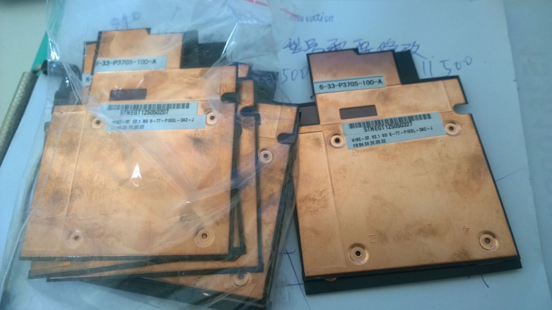

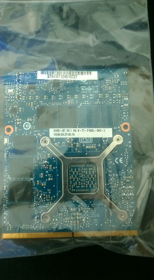

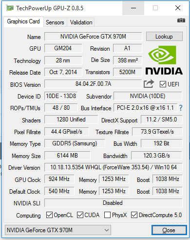

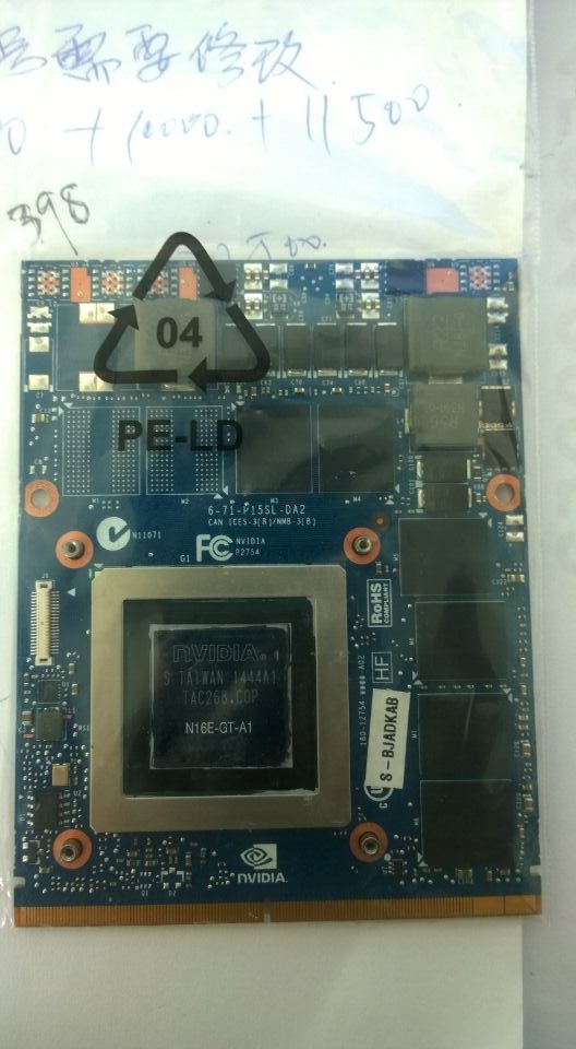

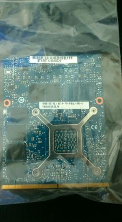

Based on your reviews I decided to buy a gtx 970m but the seller only bios 84.04.2F.00.7A. I'm not sure about the compatibility. Worth buying? Also, the seller offers free send some copper plates for the graphics card, I do not quite understand why they are needed.I am attaching photo.
This is a good Sign.
You can use this Nvidia GPU`s:
GTX 460M,GTX 560M,
GTX 570M,GTX580M,GTX670M,GTX675M,another Heatsink
GTX 765M,modified Driver,GTX 770M,another Heatsink.You can modify your Heatsink.
GTX 970M,GTX 980M,another Heatsink.You can modify your Hetasink.
Keplercards like GTX 670MX,GTX 675MX,GTX 680M,GTX 780M,GTX 880M and Quadro Cards on Keplerchips are not working.
