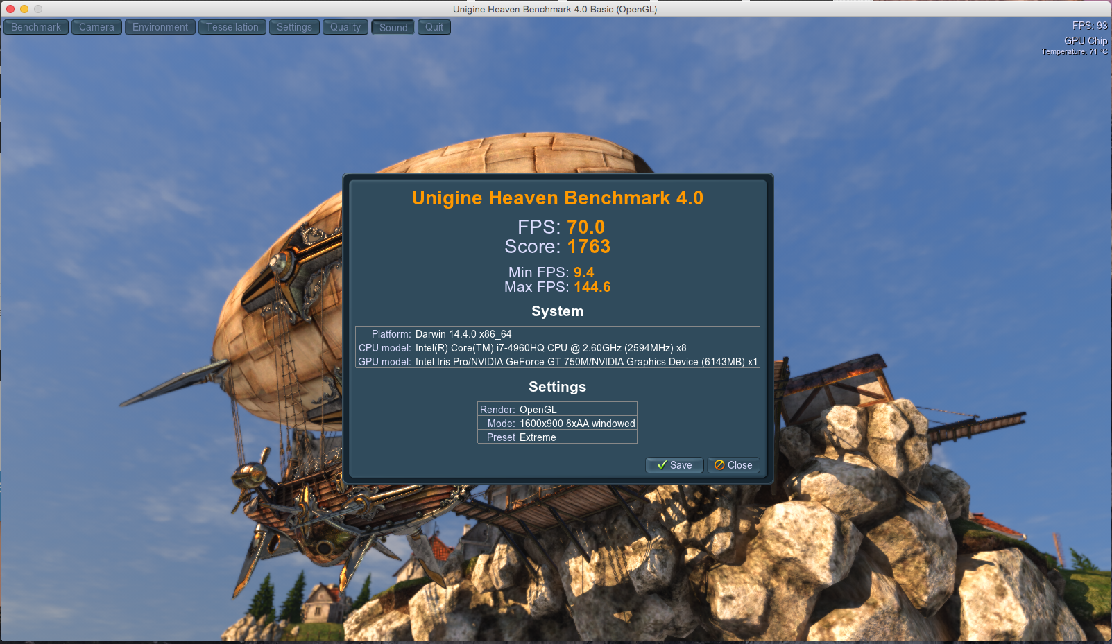

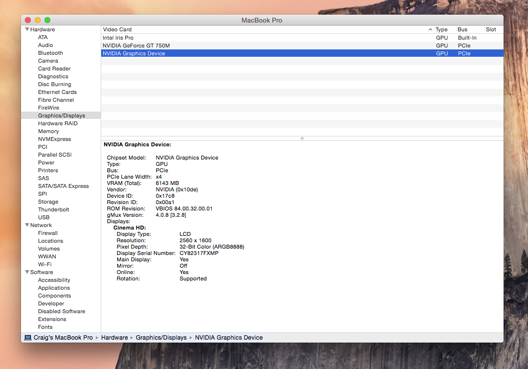

cascascas Posted July 13, 2015 Share Posted July 13, 2015 (edited) I wanted to add myself to the list of successful eGPU users. Also, I haven't yet seen any GTX 980 Ti reports! Thank you to all who have committed to posting helpful info and helping other users on this forum. I've been running the 980 Ti on my Akitio Thunder2 for the last 48 hours and it's been nearly flawless and INSANE performance above my 750m, as expected. Notebook 2013 15" Macbook Pro GT750M i7-4960HQ @ 2.6Ghz 16GB RAM, 1TB SSD Win8.1 + OSX 10.10 eGPU gear Akitio Thunder2 eGPU enclosure MSI GTX980 Ti reference Also, in terms of my physical setup, I have some pictures (still in progress cleaning it up). I ended up putting the whole rig inside a built in cabinet in our home office. I used a Noctua fan and installed it into the cabinet to keep constant airflow. I also house a 5-drive RAID in this cabinet so it keeps everything cool. A nice out of sight setup with just the thunderbolt cable and a hidden DVI cable. Need to paint and clean up some but it's working out well. I'd say I can boot with the card successfully about 75% of the time.. 25% of the time I get stuck at black screen. A mild inconvenience. The short version is that I tried the NA211TB because of the all-in-one solution and it's really nice design. But I could never get it to operate because the 750m rMBP doesn't play well with chassis that have multiple slots (PCIe multiplexer conflicts with Macbook's firmware). Would just boot to black and never POST with either OS (yes I've used goalque's awesome, amazing latest script but alas...) Here's 3DMark benches (no overclock on the card) Firestrike, 980 Ti vs 750m : http://i.imgur.com/QcKOoH0.png Sky Diver, 980 Ti vs 750m : http://i.imgur.com/GTOq71A.png 3dmark13-FS.GPU=15687 ps. small issues I've had: - on a fresh startup I have wait until boot to boot select screen to plug into the Akitio. Wait 10 seconds before plugging in TB cable then quickly select an OS (if I wait too long it locks up) - on Win 8.1 occasionally (probably only after 2 hours of straight gaming) I'll get a very brief display lockup and windows tells me the driver had failed and then almost immediately recovered (is this a dirty power issue? Or drivers? I'm using latest NVIDIA drivers) I'm running a CX600 Power supply but I don't have amazing soldering skills! - first few times I booted into OS X nearly all pro apps would hang and not successfully open (using latest web driver) But that since has been resolved and everything is good. No change to the system (?) Edited February 28, 2016 by nando4 formatting Quote Link to comment Share on other sites More sharing options...
euqlaog Posted July 13, 2015 Share Posted July 13, 2015 The short version is that I tried the NA211TB because of the all-in-one solution and it's really nice design. But I could never get it to operate because the 750m rMBP doesn't play well with chassis that have multiple slots (PCIe multiplexer conflicts with Macbook's firmware). Would just boot to black and never POST with either OS (yes I've used goalque's awesome, amazing latest script but alas...)<don't know="" what="" happened="" to="" this="" section="" below="" --="" couldn?t="" remove="" during="" edit=""></don't>The [-a] mode should resolve the booting issues with multi-slot enclosures on OS X. If you have problems and want to get it working on OS X, please contact me. Quote Link to comment Share on other sites More sharing options...
cascascas Posted July 13, 2015 Author Share Posted July 13, 2015 @Dschijn 10988 Firestrike (not overclocked) It's a reference design from MSI.- - - Updated - - - @goalqueI saw that you had a solution for OS X but I also need to have it working for Windows 8.1 as well. The Akitio is working on both at the moment so I think I'm going to send the NA211TB back and build a small case for the akitio setup. I could do a few tests for you before I send it back if you'd like. Let me know.- - - Updated - - -Hmm... can anyone help me with this weird issue:I booted up the rMBP (not plugged into the Akitio, just by itself) into OS X and during the load bar it all of a sudden shrinks by 2x (very small) and the whole OS loads extremely slowly and is 2x scaled down. Really really laggy and unusable. I've tried all of the following with no changes results:- repair permissions (both from recovery volume and from boot volume) - reset PRAM- reset SMC- changed video driver back and forth from OSX to NVIDIA web driver via the web driver tool.OS X is virtually unusable this way. And it won't push signal to any external display.Interestingly, OS X thinks my primary display (laptop display) is a 47-inch screen: https://www.dropbox.com/s/i4dx7l76npvj5kx/Screenshot%202015-07-13%2012.32.11.png?dl=0Also, laptop will not go to sleep when the lid is closed. Display stays active. Quote Link to comment Share on other sites More sharing options...

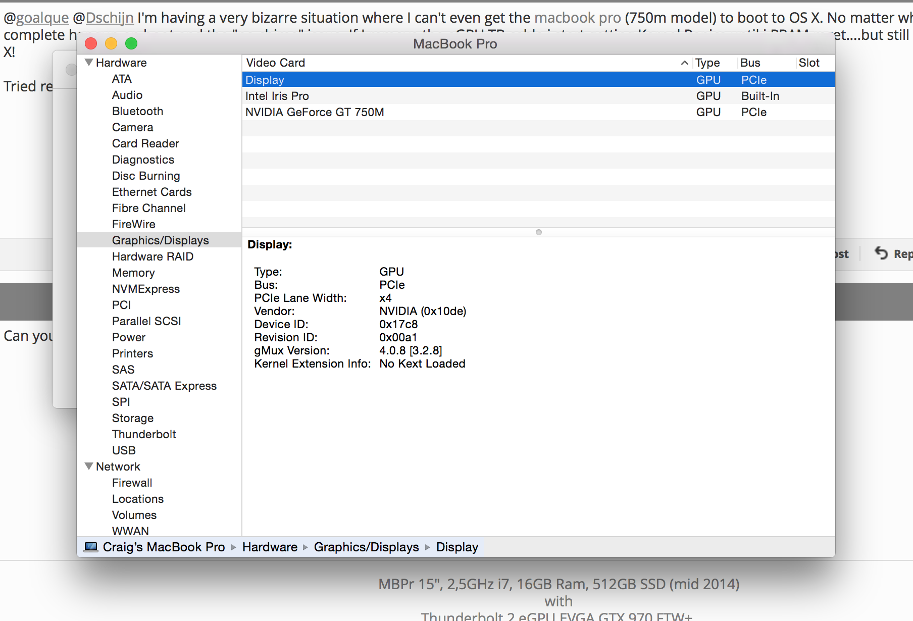

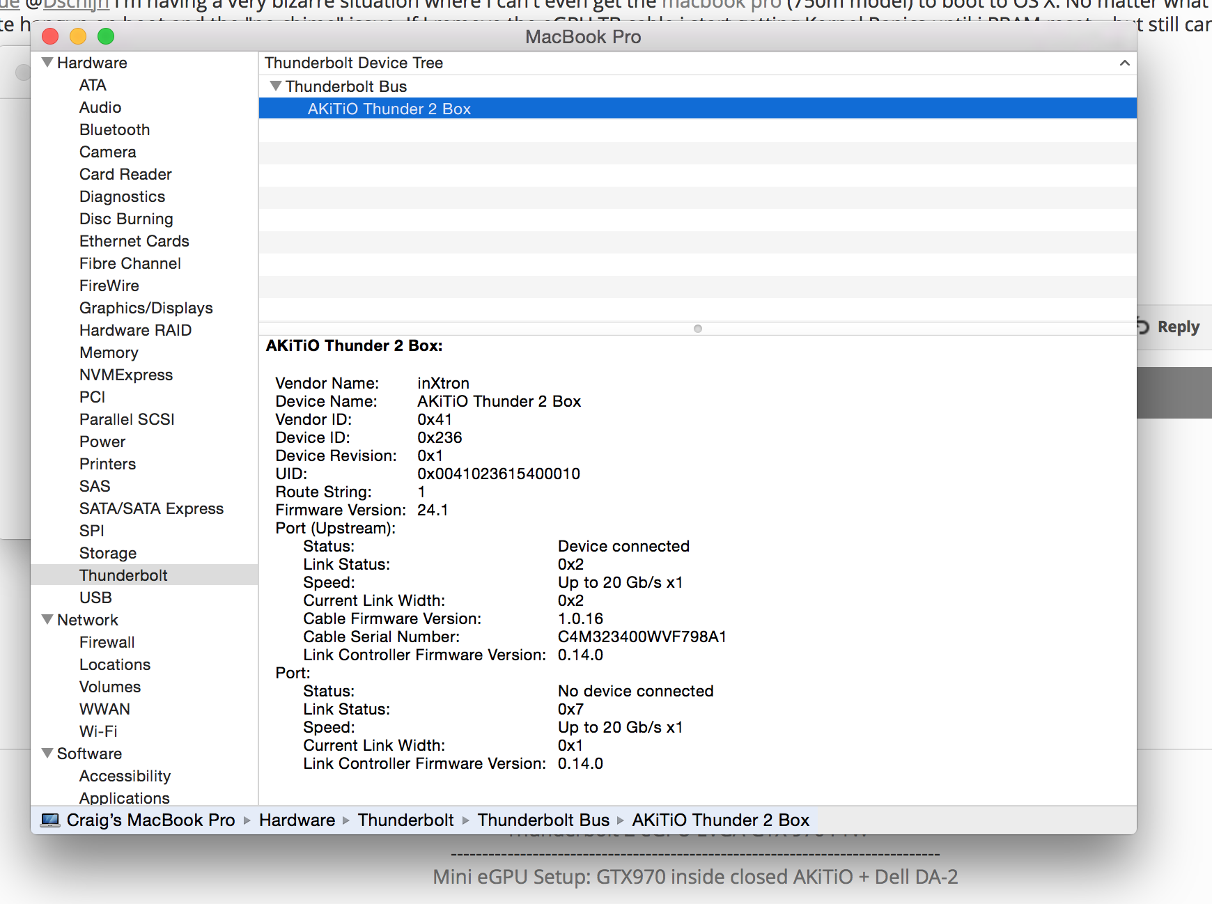

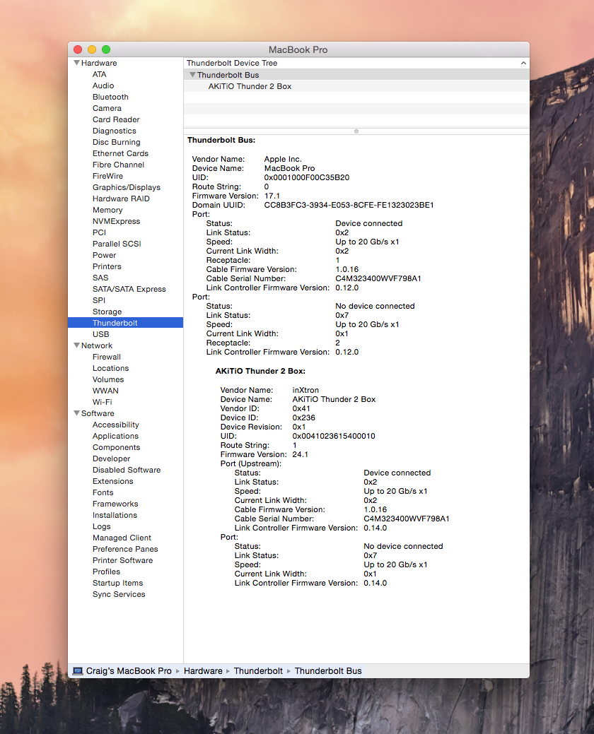

cascascas Posted July 19, 2015 Author Share Posted July 19, 2015 @goalque @Dschijn I'm having a very bizarre situation where I can't even get the macbook pro (750m model) to boot to OS X. No matter what order I boot in I get a complete hangup on boot and the "no chime" issue. If I remove the eGPU TB cable i start getting Kernel Panics until i PRAM reset....but still cannot boot with eGPU in OS X!Tried researching the forums but can't find anything specific. Quote Link to comment Share on other sites More sharing options...
Dschijn Posted July 19, 2015 Share Posted July 19, 2015 Can you boot without the eGPU into OSX, switch on the AKiTiO and check if it is listed in your hardware? Quote Link to comment Share on other sites More sharing options...
cascascas Posted July 19, 2015 Author Share Posted July 19, 2015 @Dschijn - Yes, detects in OS X when plugging after boot (screenshots). And this is with NVIDIA web driver enabled. And, I have no problems booting into windows. Quote Link to comment Share on other sites More sharing options...
euqlaog Posted July 19, 2015 Share Posted July 19, 2015 - changed video driver back and forth from OSX to NVIDIA web driver via the web driver tool.You can't use OS X default driver, please don't touch to web driver settings. What terminal commands did you type? What's the output if you run "sudo ./automate-eGPU.sh -skipdriver" ? Quote Link to comment Share on other sites More sharing options...

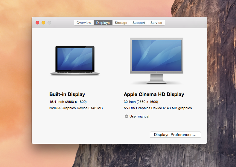

cascascas Posted July 19, 2015 Author Share Posted July 19, 2015 UPDATE 3: booting eGPU to OS X with macbook lid closed (means internal LCD never posts or never recognized) is causing the crashing and hangups in all my pro apps and games. It's like they are all confused about what to do But they run fine if internal LCD posts as an extended screen. Since I primarily want to work in single display mode (I mount my MBP behind the 30" Apple Display) my solution is to leave the macbook lid open slightly and change OS X display prefs to mirroring both displays. No more stray UI elements and wasted GPU resources. Quote Link to comment Share on other sites More sharing options...
cascascas Posted July 19, 2015 Author Share Posted July 19, 2015 UPDATE 4: Using mirroring as a solution seems to cut performance down by 30-40% and causing external display to run at 30hz instead of 60hz (just guessing by the lag in UI render). I suppose I'll have to live with the laptop display being on and extended even though I sits behind my external display. I think i'm learning some of the lessons others already have on this forum Quote Link to comment Share on other sites More sharing options...

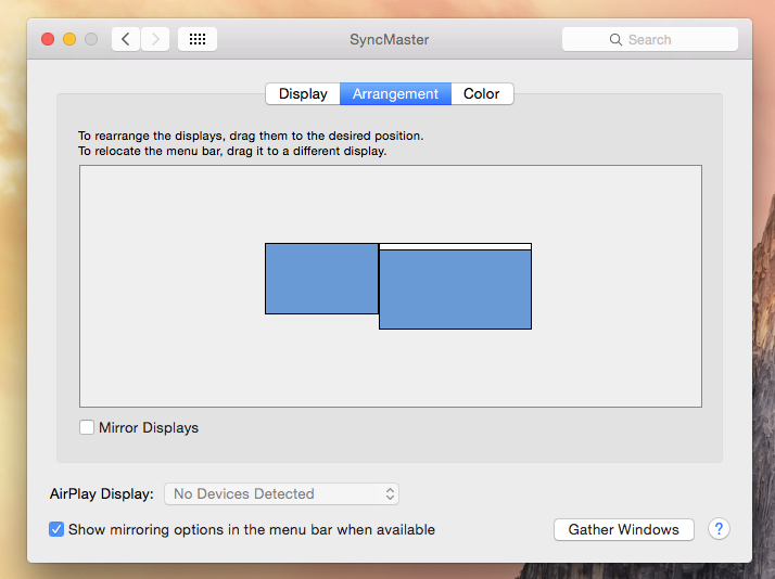

euqlaog Posted July 19, 2015 Share Posted July 19, 2015 @cascascas Thank you! Yep, the internal and external screen work fine together in "extended mode". If you go to System Preferences -> Displays -> Arrangement, you can choose which is your primary display by dragging the white bar (menu) onto the blue box. Games can be launched on the external monitor for acceleration and sometimes you can move them to internal screen and continue gaming. It’s a pity that games are not often optimized for OS X, programmers haven’t thought about external GPUs. SwitchResX is a handy tool, but its display disabling/enabling is not perfect in Yosemite. However, worth to try. 1 Quote Link to comment Share on other sites More sharing options...
