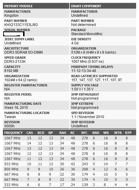

For example on my Dell E6430 there was no option in my BIOS to enable XMP Profile. Using as a guide Atonus instructions I changed my DIMM profile (in my bios 0x1ee) from default (value 0x0) to XMP Profile 1 (value 0x2) and XMP Profile 2. I flashed XMP Profiles on my stock memories described here. You can do the same on your sticks if they do not have XMP Profiles already. You can check if your so-dimms have XMP Profiles using Thaiphoon Burner DEMO.
There is no xmp profile on, so that should be good. Im stil not sure how to find the UEFI as the tool link is still broken, and same with the blog giving me a 503 error each time I try and down load it. Maybe your referring to thaiphoon burner? The atonus guides link for this tool(https://www.sendspace.com/file/bouk3i) is broken as well. Is the nondemo 16 dollar thaiphoon burner the key to all of this?
I have already created the IFR txt and showed you which variable you have to change (check post #72).
If you don't have access to an older DDR3 laptop (GM45/PM45 where you can use SPDTool) it is the only way that I know to flash XMP Profiles on your RAM on your laptop.
Even if you flash the XMP Profiles, there is a possibility that it won't work...

Alright, I will try this soon since it doesnt use Thaiphoon burner. I contacted them and they said it would not work because of the bios limit which they cannot do anything about. Im just kinda scared to try since ive never done this before.

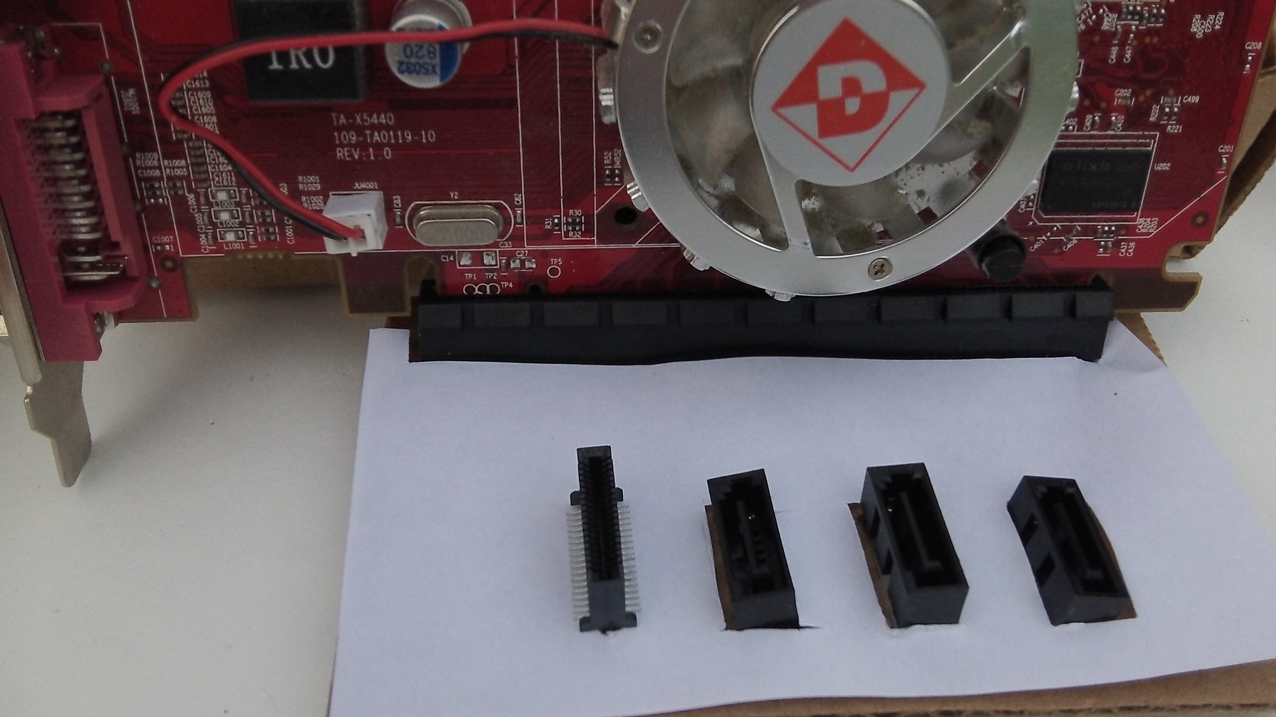

So I finally settled on my connectors:
Recognize that funny looking connector next to the three SATA ports? It's a mini-SAS port that conveniently has enough pins for port 1 and utilizes differential pairs. I decided to do a mock up of the setup to see if there's any location issues; sure enough because of the cabling it requires more space for the powerful dual slot cards that would complement the 3720QM. And locking the GPU down with a latch seems unnecessary as it fits extremely snug. I also decided I may add a SATA power connector in case I wanted to try out non-powered cards.
I currently have half the connectors designed in Eagle. Two SATA ports will connect to those mSATA adapters with the tx/rx corrected. As for the EC slot, I found the edge connector to build an EC to SATA adapter card. And for the first port, it will utilize the mSATA card adapted with the mini-SAS connector. All in the name of signal integrity :-)
So far parts were pretty cheap, the tough part was finding who was selling less than a roll of 7000 connectors. I ended up on Newark's site which luckily gives me blueprints and footprints that I can copy over into Eagle (which I'm also learning how to use, sheesh). Cables are also affordable for this build unlike those proprietary BPlus cables. My 36 pin mini-SAS cable was $10 USD. Once the schematic is done I will run it by you guys before I send off the gerbers to a PCB company. Still lots to do.

So I finally settled on my connectors:... So far parts were pretty cheap, the tough part was finding who was selling less than a roll of 7000 connectors. I ended up on Newark's site which luckily gives me blueprints and footprints that I can copy over into Eagle (which I'm also learning how to use, sheesh). Cables are also affordable for this build unlike those proprietary BPlus cables. My 36 pin mini-SAS cable was $10 USD. Once the schematic is done I will run it by you guys before I send off the gerbers to a PCB company. Still lots to do.

So mini SAS will have its own custom mPCI-E board, luckily I found right angle connectors so to keep it slim. The fun part is some of the connectors (like the vertical mini SAS) don't have completed dimensions so I have to find my calipers or just use the ones from work.

That's pretty much what I figured. Well, good thing I also ordered a SATA power connector so I should have 3.3V, 5V, and 12V without having to convert, simple enough. I know there are daughter board kits to convert DC jacks if someone wants to go that route.
That's even better. The sata power connectors tend to be a bit fragile though (I have broken a few so far just by plugging and unplugging).
So if you are planning to plug and unplug I would suggest a more robust connector.
