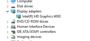

aldimeola81 Posted April 26, 2016 Share Posted April 26, 2016 Yes but when i set to enabled I should see the Intel video card over windows, and I don't see nothing.. I'm using pe4c at 2.0 speed connected to expresscard, i have any chance of overclocking my i5-3360m with the o.c. bios? thanks. ok. Your connection is x1.2 meaning that you will benefit if have the iGPU enabled. Do you have an iGPU/dGPU model or iGPU only? If you have the dGPU model do you have Optimus enabled? You can OC your i5 using BCLK OC for almost 5% @ maximum of 3.6GHz ... no unlocked multipliers on any dual cores... I have the igpu version, but the Intel card won't be enabled as I see.. The command setup var are permanent or I must reinsert them at every boot? Maybe I have to change tolud size? But what size I have to choose? Quote Link to comment Share on other sites More sharing options...
timohour Posted April 26, 2016 Author Share Posted April 26, 2016 18 minutes ago, aldimeola81 said: I have the igpu version, but the Intel card won't be enabled as I see.. The command setup var are permanent or I must reinsert them at every boot? Maybe I have to change tolud size? But what size I have to choose? setup var command is permanent but needs a cold boot (shutdown and startup) in order to work properly. No need to change TOLUD size. I will change automatically if needed. Quote Link to comment Share on other sites More sharing options...

aldimeola81 Posted April 27, 2016 Share Posted April 27, 2016 i've removed the wire and the sound is working now! but i'm not able to enable the igpu as i see with var mod.. is there any other way to do it ? the 3dmark 06 score is 22000, is possible that the igpu is already enabled but not visible? i think should be much lower without optimus, don't you think? thanks. Quote Link to comment Share on other sites More sharing options...
timohour Posted April 27, 2016 Author Share Posted April 27, 2016 (edited) If iGPU is enabled you should see it under Display adapters as Intel(R) HD Graphics 4000 Edited April 27, 2016 by timohour Quote Link to comment Share on other sites More sharing options...
aldimeola81 Posted April 27, 2016 Share Posted April 27, 2016 If iGPU is enabled you should see it under Display adapters as Intel® HD Graphics 4000 Yes, I think the same but won't appear[emoji1] , so what can I do? Thanks Inviato dal mio Lenovo P70-A utilizzando Tapatalk Quote Link to comment Share on other sites More sharing options...
aldimeola81 Posted April 30, 2016 Share Posted April 30, 2016 (edited) At the end i've solved, I was using a wrong syntax the correct is setup_var xxxxxx modified value (maybe in the guide can be written a full example for easier reading) and sometimes the command need to be sent two times to be taken. anyway in my system there is no benefit using igpu+egpu, so after some test, i've disabled another time so i can have the signal always on my external screen without additional cables during booting and bios. now i'm trying to overclock 5% more the cpu, i've flashed oc bios but the xtu program can't me do any setting.. what i'm missing? thanks. Edited April 30, 2016 by aldimeola81 Quote Link to comment Share on other sites More sharing options...

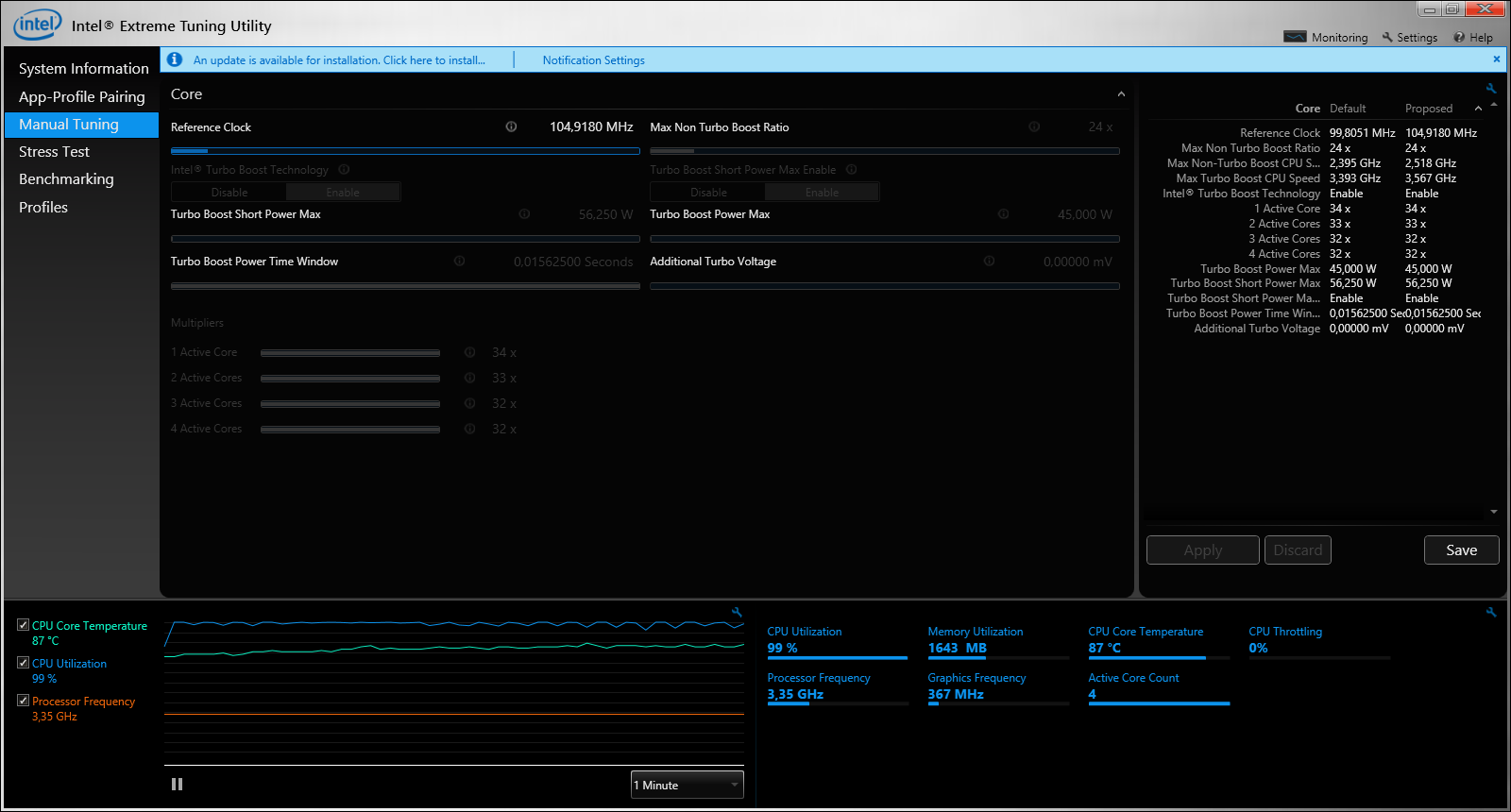

AGmR Posted May 1, 2016 Share Posted May 1, 2016 16 hours ago, aldimeola81 said: now i'm trying to overclock 5% more the cpu, i've flashed oc bios but the xtu program can't me do any setting.. what i'm missing? thanks. Try to uninstall xtu if u already have it before flash bio file then restart and install it again. 1 Quote Link to comment Share on other sites More sharing options...
aldimeola81 Posted May 1, 2016 Share Posted May 1, 2016 (edited) 5 hours ago, AGmR said: 22 hours ago, aldimeola81 said: now i'm trying to overclock 5% more the cpu, i've flashed oc bios but the xtu program can't me do any setting.. what i'm missing? thanks. Try to uninstall xtu if u already have it before flash bio file then restart and install it again. Now i can move two sliders but I think they are useless: turbo boost power max and turbo boost power max.. Moving them appear to not change nothing.. Edited May 1, 2016 by aldimeola81 Quote Link to comment Share on other sites More sharing options...
AGmR Posted May 1, 2016 Share Posted May 1, 2016 3 hours ago, aldimeola81 said: Now i can move two sliders but I think they are useless: turbo boost power max and turbo boost power max.. Moving them appear to not change nothing.. I think u didnt get BLCK OC yet, u should see this tab in xtu if u flashed right bios. Click Here ^^ ـــــــــــــــــــــــــــــــــــــــــــــــــــــــــــــــــــــــــــــــــــــــــــــــــــــــــــــــــــــــــــــــــــــــــــــــــــــــــــــــــــــــــــــــــــــــــــــــــــــــ & bout Power sliders lol u must disable Turbo PWR Limit MSR Lock in bio to get benefits from those Bios>Power>Advanced CPU Control>Turbo PWR Limit MSR Lock>Disabled then change watt as u wanna ↓ ↓ Turbo set maximum short term turbo power limit .... W > Long duration 56W >Long term Power Limit .... W >F10 save/exit. 1 Quote Link to comment Share on other sites More sharing options...
aldimeola81 Posted May 1, 2016 Share Posted May 1, 2016 I've flashed the e6430_OC first, and E6430UCME after, but still the same, no control in XTU.. I'm using windows 8.1… can be this the problem? Inviato dal mio Lenovo P70-A utilizzando Tapatalk Quote Link to comment Share on other sites More sharing options...
AGmR Posted May 2, 2016 Share Posted May 2, 2016 (edited) 4 hours ago, aldimeola81 said: I've flashed the e6430_OC first, and E6430UCME after, but still the same, no control in XTU.. I'm using windows 8.1… can be this the problem? Inviato dal mio Lenovo P70-A utilizzando Tapatalk Nope ur OS is ok, yes i think u installed latest ver of xtu just try xtu older vers cuz there is conflict bug for some mobo bio systems with some vers of xtu "latest + some older" + as u can see in pic top "An update is available for installation ..... " Mr/ Timo using previous ver of xtu i dnt knw wat it is but just try older one here u go http://forum.notebookreview.com/threads/intel-xtu-extreme-tuning-utility-dare-to-find-any-older-version.781755/ Edited May 2, 2016 by AGmR 1 Quote Link to comment Share on other sites More sharing options...
aldimeola81 Posted May 2, 2016 Share Posted May 2, 2016 I've installed version 3.0.24 and still nothing, also the power slider has gone gray..also throttlestop won't overclock at all..thanks anyway Quote Link to comment Share on other sites More sharing options...
aldimeola81 Posted May 2, 2016 Share Posted May 2, 2016 (edited) I think i've found the problem: there is some incompatibility with modified bios and my pc. Can depends from bios version maybe, when i flash a modded bios the ethernet card disappear in windows at every boot.. how can I modify mine to allow overclock? is there any guide? Edited May 2, 2016 by aldimeola81 Quote Link to comment Share on other sites More sharing options...

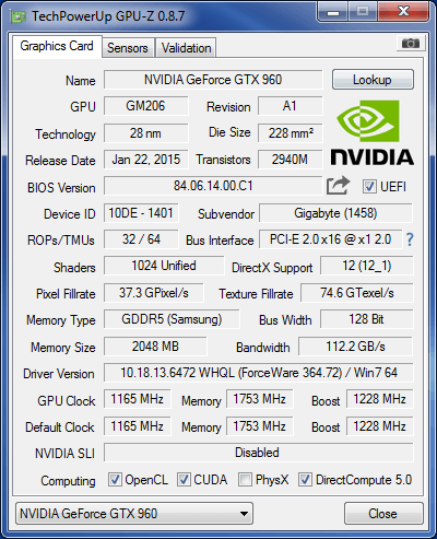

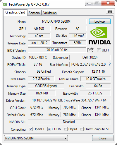

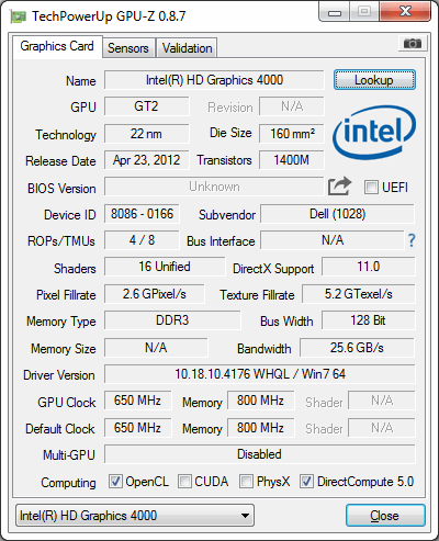

exco Posted May 6, 2016 Share Posted May 6, 2016 (edited) I just got around to play a bit with my GTX960 attached to my e6430 as eGPU with an EXP GDC Beast v8.0. It is almost plug and play - fiddling with drivers a bit and the crash now and then. What I'm wondering - is a higher PCI Express link speed possible - I only get v1.1 (see GPU-z)? Also - the 5285 points is just double of the NVS 5200 - is that the most I can get out of the GTX960? GPU-z iGPU dGPU 2485 3dmark eGPU - Gigabyte GTX960 ITX 5285 3dmark Edited May 7, 2016 by exco Quote Link to comment Share on other sites More sharing options...
Airat Posted May 8, 2016 Share Posted May 8, 2016 On 06.05.2016 at 11:40 PM, exco said: Also - the 5285 points is just double of the NVS 5200 - is that the most I can get out of the GTX960? ... 5285 3dmark 960 is not just "double" of the 5200. You have to look at the "Graphics score" field: 960 has almost exactly 3 times more points than 5200. I believe using EXP GDC there is no way to increase your egpu performance other than overclocking it.. My 960 is overclocked by default (by manufacturer) and it scores a little bit more graphic points than yours - http://www.3dmark.com/fs/6430010, even on e6220 with i5. However OC can be dangerous, so read manuals and be careful and blah-blah-blah. Quote Link to comment Share on other sites More sharing options...

aldimeola81 Posted May 13, 2016 Share Posted May 13, 2016 Hi khenglish, can you please help me? I've flashed modded BIOS but i can't overclock at all inside Intel xtu, the sliders are locked with my i5-3360m, I've tried a fresh windows 7 installation and old xtu version, same result. I' ve bought an i7-3720qm now,maybe it arrive today.. do you think that can solve the problem or not? Is there any guide to customize bios by myself? Cause the O.C. bios give me several problems: E.g. the network card appear to be in conflict and is disabled at every boot.. Thanks! Inviato dal mio Lenovo P70-A utilizzando Tapatalk Quote Link to comment Share on other sites More sharing options...
Khenglish Posted May 13, 2016 Share Posted May 13, 2016 Yup guide here Yeah your system does not like the me fw meant for someone else. Basically download the program set and make the same changes to your original me fw dump as the dump you tried. 1 Quote Link to comment Share on other sites More sharing options...
aldimeola81 Posted May 14, 2016 Share Posted May 14, 2016 Yup guide here Yeah your system does not like the me fw meant for someone else. Basically download the program set and make the same changes to your original me fw dump as the dump you tried. I've done and it worked, now the reference clock is free until 800mhz[emoji1] BUT.. The maximum I can over clock my reference clock with i5-3360m is only 100.5 mhz, if I go after, the system hangs immediately... Not so funny.. Is it normal? Thanks. Inviato dal mio Lenovo P70-A utilizzando Tapatalk Quote Link to comment Share on other sites More sharing options...
