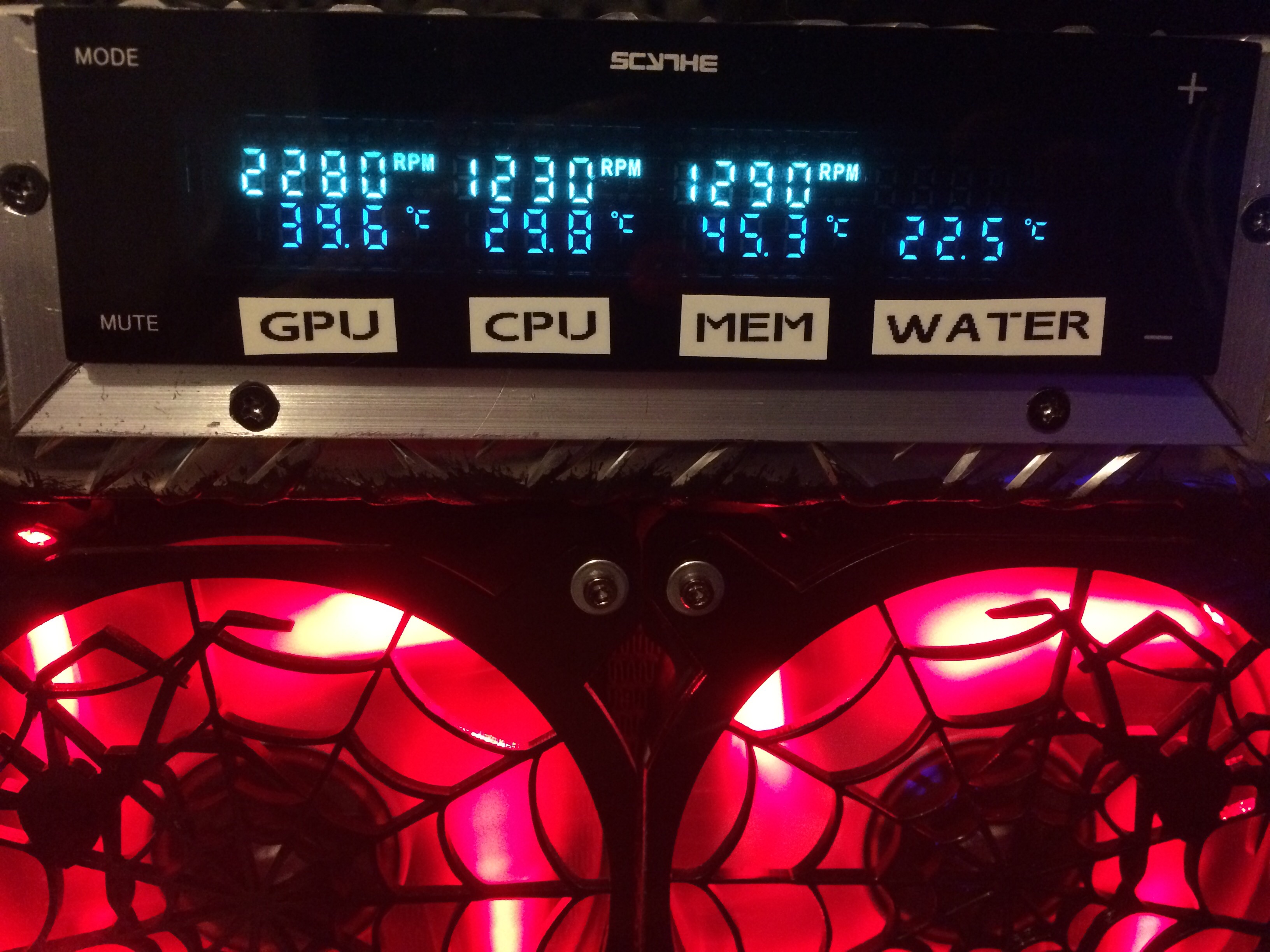

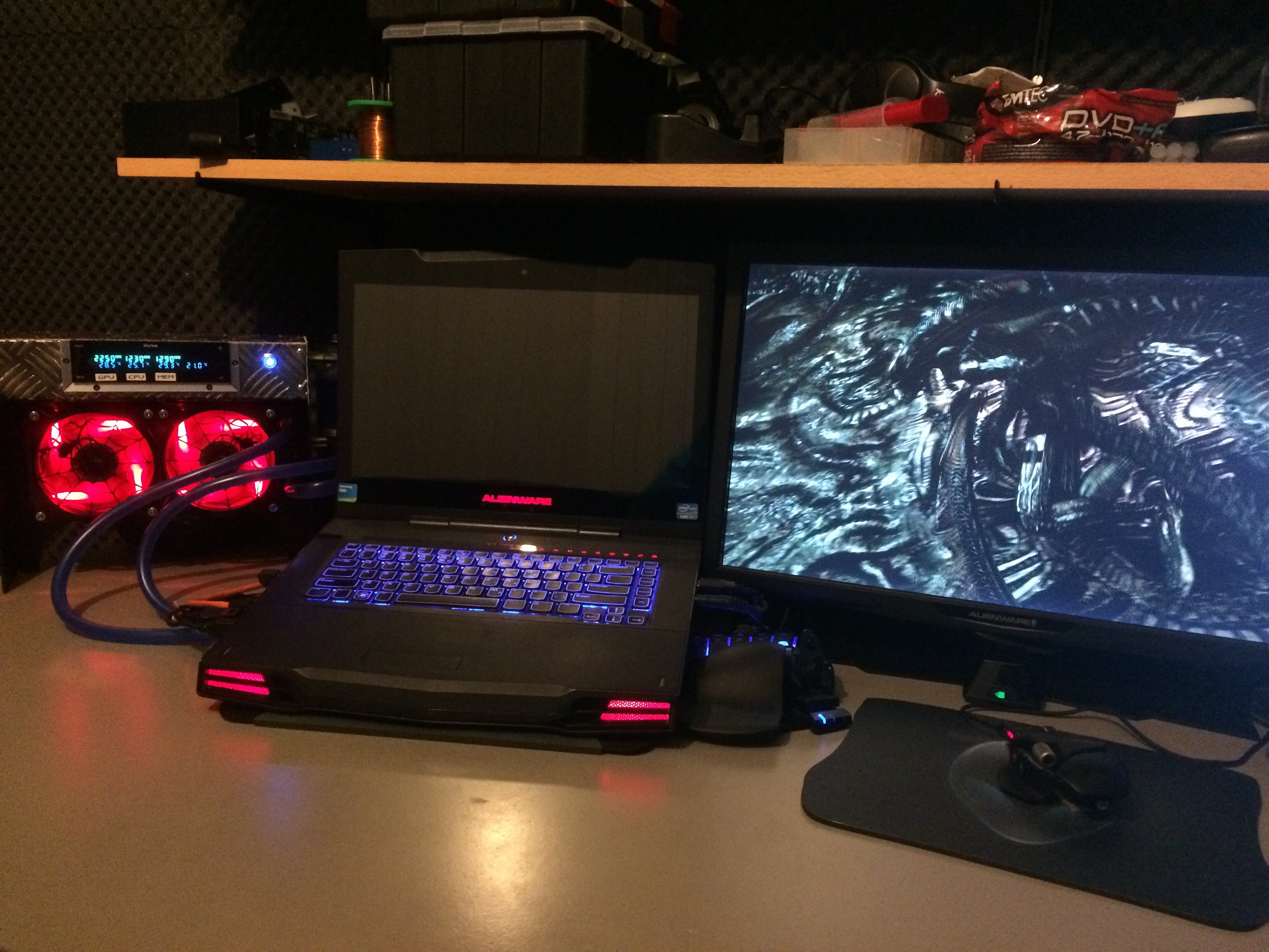

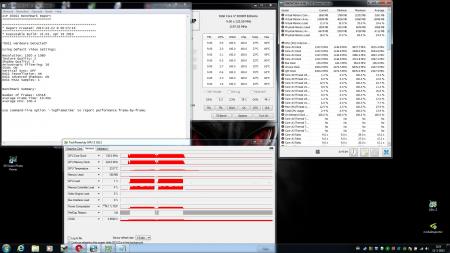

Get watercooling .........or extreem aircooling the rest will all produce more heat even if you lower voltage a little and overclocking it temps will rise.
go for lower setting so that FPS is higher, but thats my vision offcourse i run hybride cooling on a gtx970 and play cod adv on high but i also set stuff down a little.
temps go up a little because of good cooling. i also have a 7970m but temps go up fast unless i get settings down (not hybride cooled) the mem goes up and they are higher because off bad memorycooling on the M15x i know some may not agree but the main problem on the ati/amd cards is the memory they get way too hot and kill most cards. on my gtx970m the memory gets hotter than the GPU.
just an example running alien vs predator benchmark.
