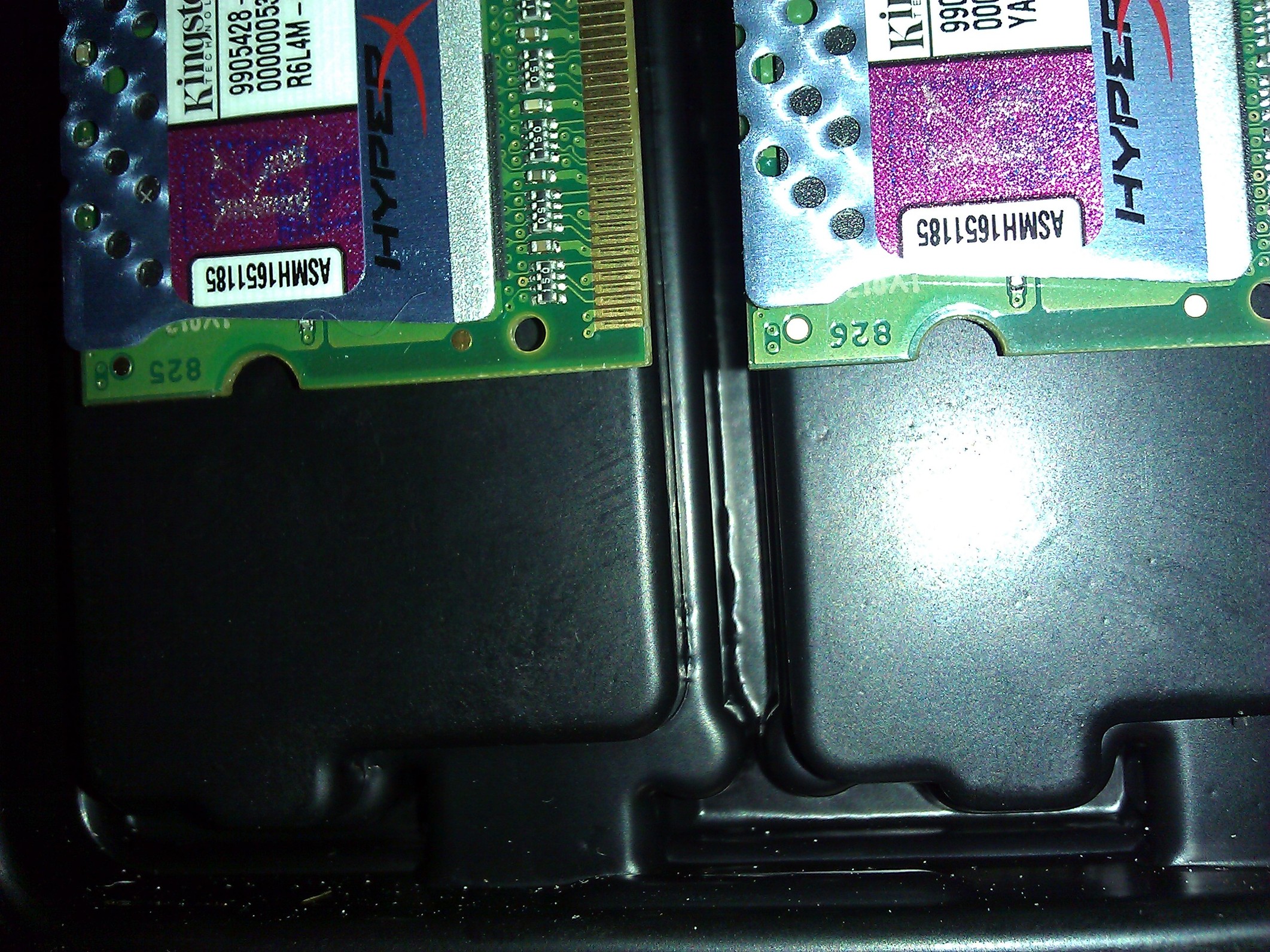

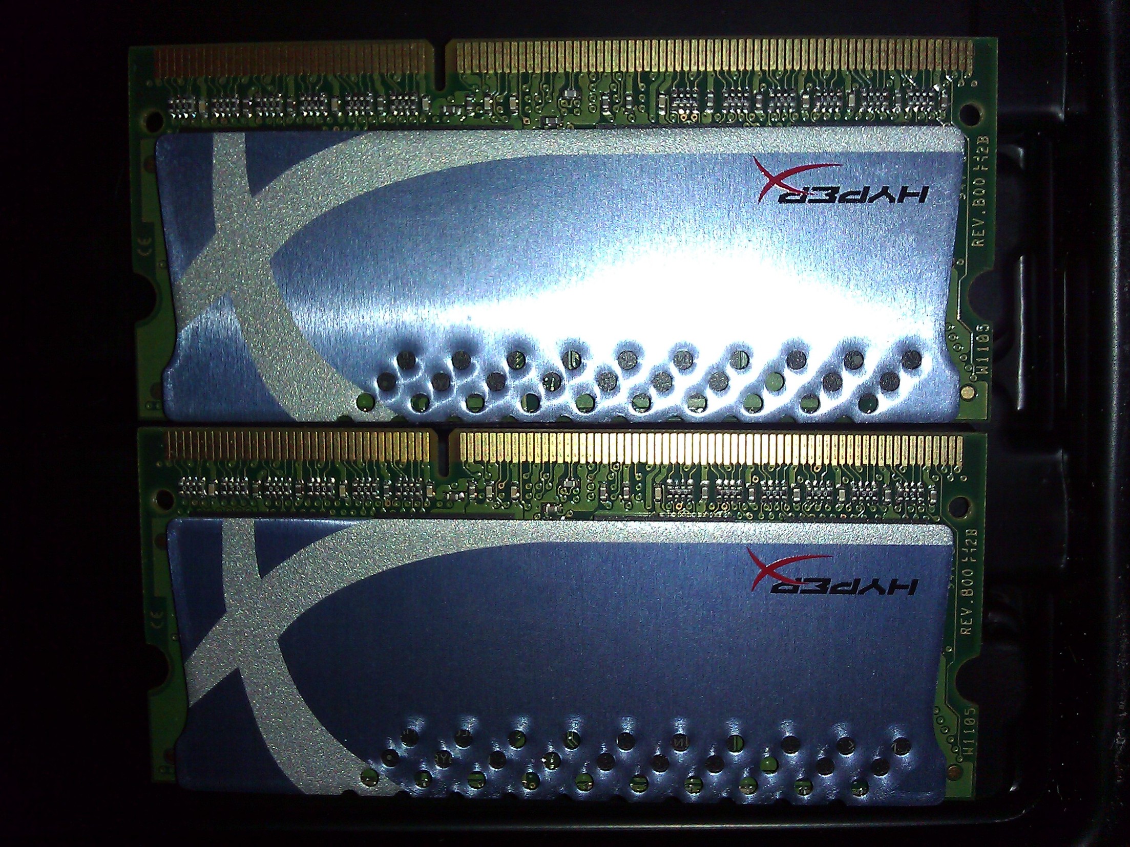

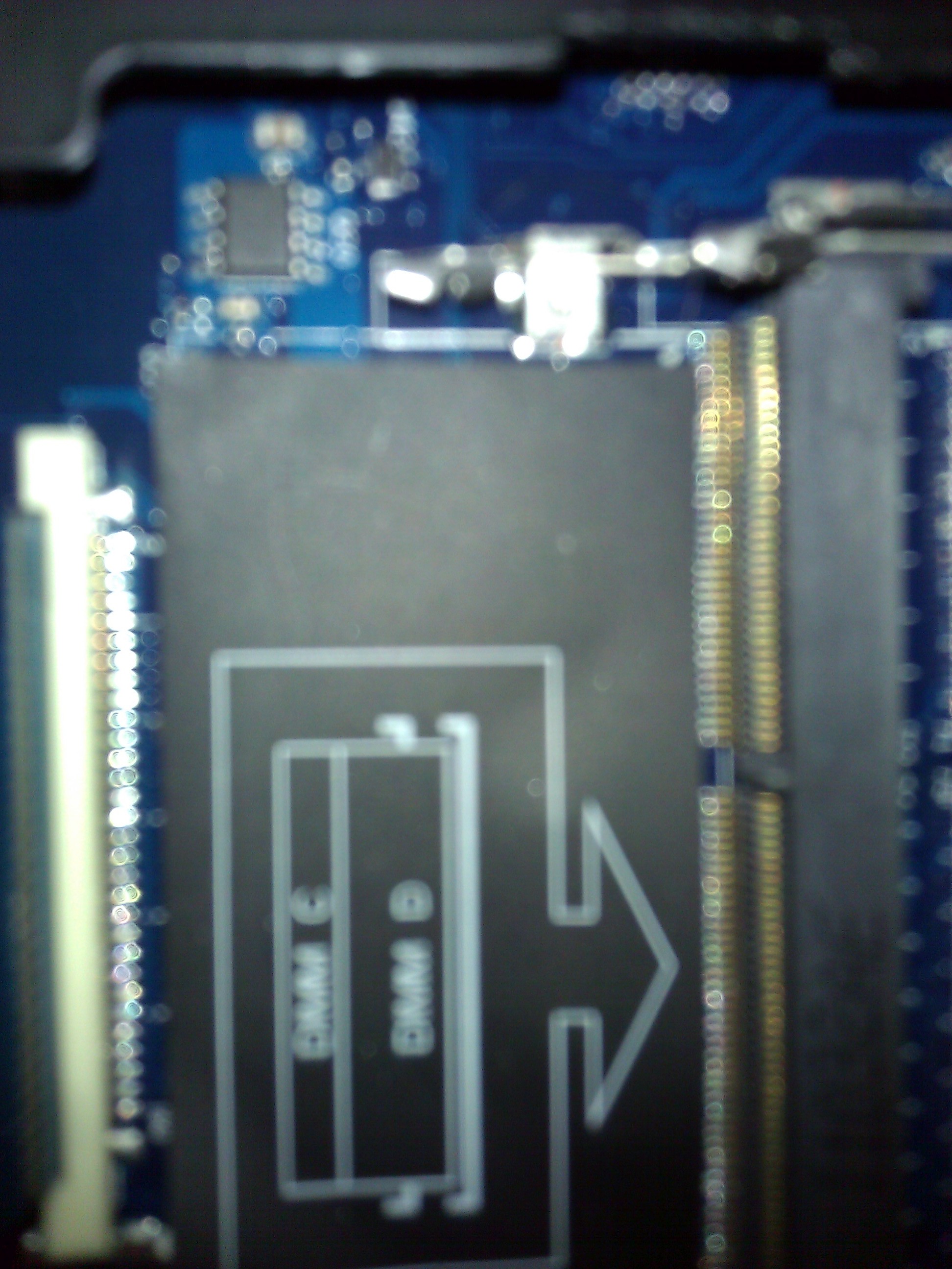

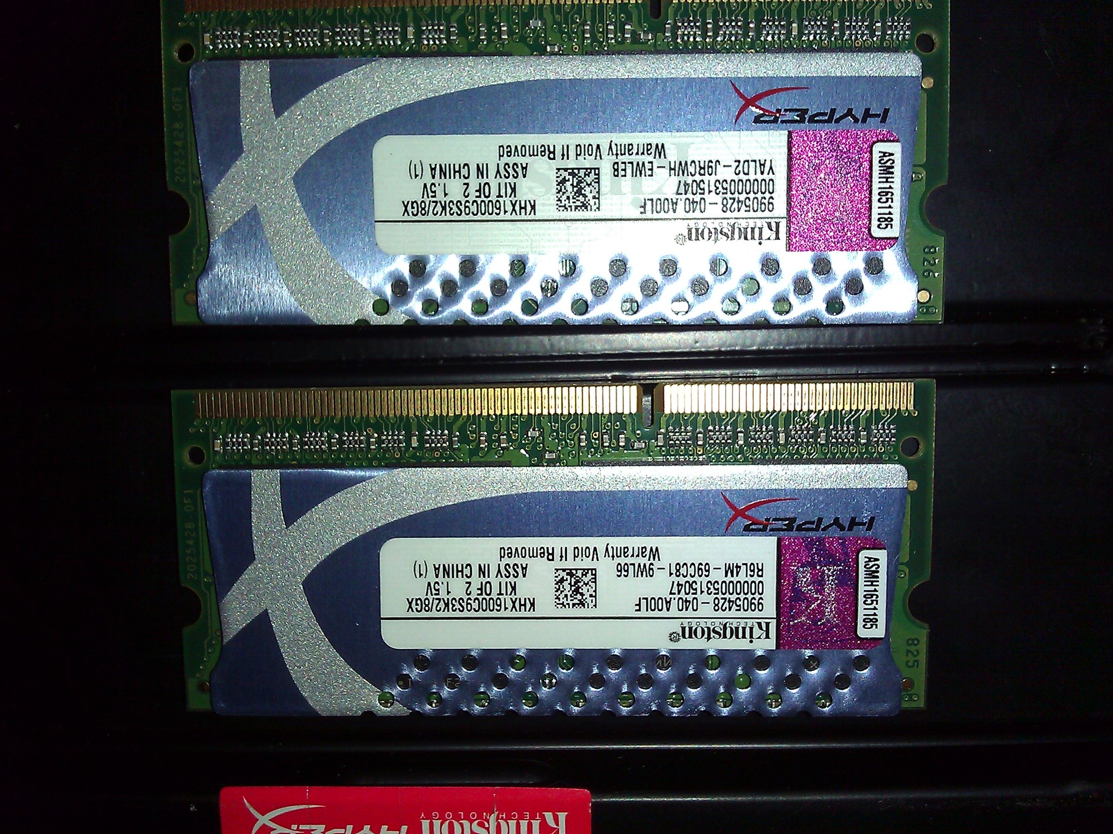

mw86 Posted March 9, 2012 Share Posted March 9, 2012 yeah, still the first set. running since 3 hours 13 now. in around 30 minutee i will change the ram set and test the other two. actually i will wait for your pics bud =) these are both sides..... this is the set of dimms under my keyboard if using the 2 for just 8gb dont fill dimm C and D notice here is the key do you see 825, and826 printed on the edge of those two chips... there is the number you go by my other chips were two with 301 and 302 on it.... hopefully you have 1 pair with two numbers in succession and again another pair with those two numbers different but in succesion of the other... they indicate that they were pairs.... only thing i found that works this is what bios should look like for you including the dimms postion.... although its covered these dimms are under bottom cover and are the A,B dimm use these for only 8gb of ram Quote Link to comment Share on other sites More sharing options...
deadbydawn Posted March 9, 2012 Share Posted March 9, 2012 thx for all the pics! strange stuff, the numbers i got are 123, 724, 212, 921. but they came as pair of twos (of course not remembering anymore which ones..).i put in the other 8gigs now. the first two did 5 rows of tests, over 3 and a half hours without errors. i somehow think that i won't be different with the other 8gigs =/---I am here: http://tapatalk.com/map.php?zyyebp Quote Link to comment Share on other sites More sharing options...
