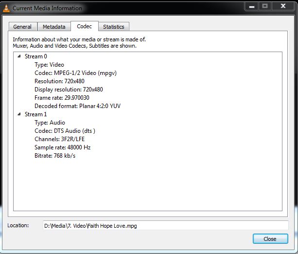

So I finally got around to testing my rig for you @Hawkeye. I played a video that only contained a DTS Audio track (graphic below) and played it through HDMI to my living room receiver. It worked fine with the 780's. As an experiment I switched to the integrated graphics and tried again. Again the video worked fine with the receiver. Let me know if you want any more tests done.

That was the answer I was looking for Steve135! Now the question is how am I going to get away with funding 2x 780m's... Maybe I should start with 1 for now.
