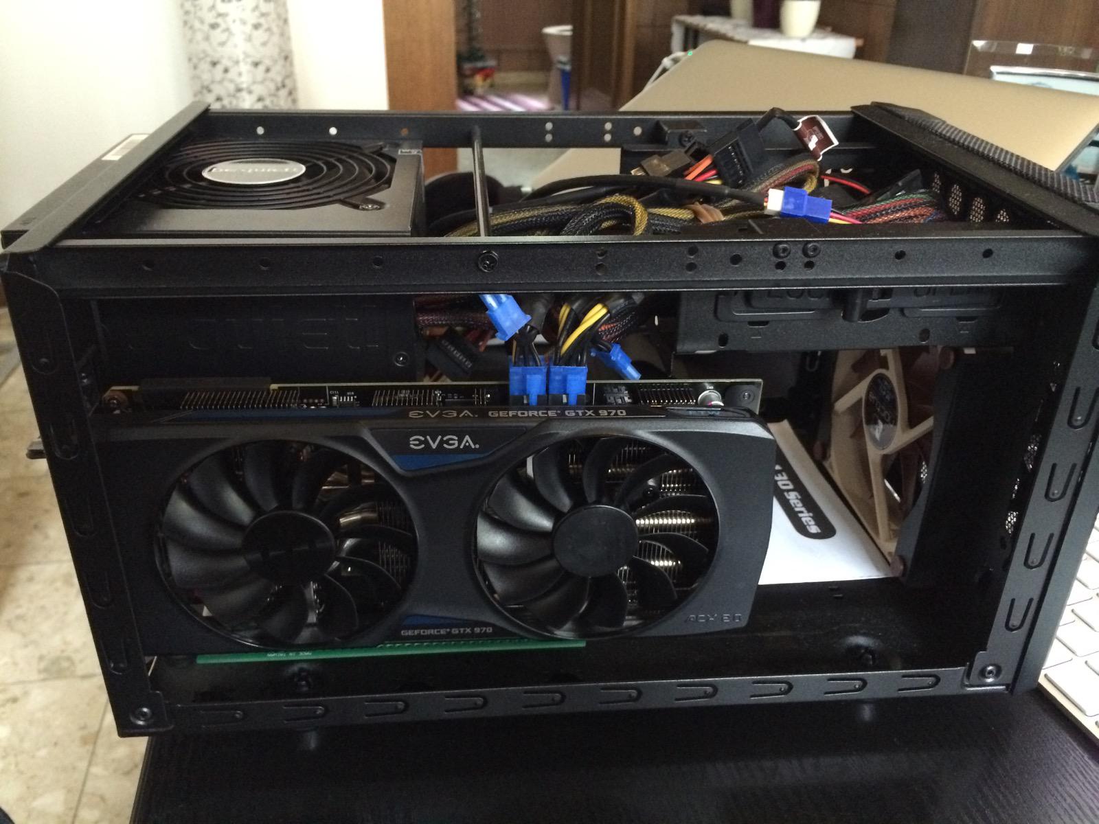

Dschijn Posted January 18, 2015 Share Posted January 18, 2015 Well that totally depends on the case/system you want to use. E.g. the CoolerMaster Elite 130 needs a right angle riser to support a molex powered flex riser as well. One user cut open his case on the bottom part to avoid using a angle riser and just go with the flex one. Here you can see (guess) the way I used the right anle riser, it's just to turn the PCIe connection of the graphics card by 90° to the right (to the back of the picture): Quote Link to comment Share on other sites More sharing options...
tre87 Posted January 19, 2015 Author Share Posted January 19, 2015 I was hoping to get my package with my replacement PSU before the weekend in order to install it and to take alot more pictures and add other info and how-to's. Unfortunately they lost my package in the local postoffice and the site where I bought it has to make a case for that item and a lot of other stuff before they can send me a new one I might just order somewhere else and return the replacement PSU once they sort it out :\ Quote Link to comment Share on other sites More sharing options...
Akkarin Posted January 19, 2015 Share Posted January 19, 2015 Oh sorry, I should have mentioned that. I'm thinking a 970 FTW, that seems to be the PSU everyone has the last problems with. I like EVGA do that's a plus. I have also been trying to find if the AkiTiO is better than the ViDock +4 and I can't seem to find much, only that the vidock MAY be running only TB1 speeds with the AkiTiO using TB2. Is there a difference. Great work also! I have been looking at buying a gaming laptop but the stumbled upon this and it seems I can keep my macbook for when I'm not home.Hi th3v3rnMy 970 runns with the vidock but its crap. the benchmarks are good but when you play games you notice that it doesnt bring the power throuh the adapter. for example. dragonage inquisition should run on ultra on 1080p with 70 to 80 fps. i get just 35 to 40 but the card runns on 100%. second example watchdogs. should rund on ultra max 1080p with 70 fps. it does just 30 with the vidock. third example BF4. max settings 1080p should do 80 fps. it does just 40 -50.... so you better dont buy a vidock. its just a waste... 1 Quote Link to comment Share on other sites More sharing options...
x6tus Posted January 19, 2015 Share Posted January 19, 2015 I managed to build my eGPU unit at the weekend with a Zotac GTX 770 2GB from eBay. The rest of the set-up was the same as described here. Couldn't have been easier. I'm running both Windows 8.1 in Bootcamp and OSX 10.10.1 happily with no problems.I sourced the RH 90 degree riser adapter from here: http://www.boston.co.uk/products/rsc-r1u-e16r.aspxThe powered riser cable from ebay here: http://www.ebay.co.uk/itm/201099227577I didn't need to power the Akitio motherboard using this set-up. 1 Quote Link to comment Share on other sites More sharing options...

th3v3rn Posted January 20, 2015 Share Posted January 20, 2015 So I should be getting everything tomorrow and I couldn't be more excited. I am checking that I have everything downloaded and updated before so that I don't have any holdups. I have looked over the steps to make sure I am not missing anything. I made sure my install of windows is UEFI and it is. I just updated my NVIDIA drivers to 347.09.Anything else I can do in prep? Thanks! I am on a rMBP late 2013 15" with 750m. Quote Link to comment Share on other sites More sharing options...
