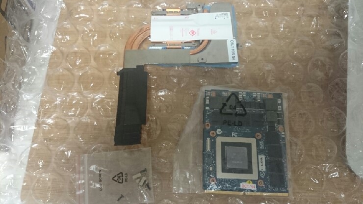

godfafa Posted October 29, 2014 Author Share Posted October 29, 2014 Everything failed.This is the answer from upgrademonkey (ebay seller) whom I think is the most honest."Hi We are waiting for the MSI version ,and it should be better compatibility than Clevo version,according to a MSI engineer privately. , but not tested yet. so not guaranteed from us."I will wait for mod-vbios. I've done everything I can and I am kinda happy that at least I found out current vbios of 980m dont work on alienware.So dont waste money folks. Quote Link to comment Share on other sites More sharing options...

godfafa Posted October 30, 2014 Author Share Posted October 30, 2014 Well maybe the M18x would not work but what about the AW 18 itself?Well 980m doens't work in AW17 (both 3D and non-3D).Since I dont have AW18, I can't test the card on it but I am pretty sure it wont work on AW18.- - - Updated - - -Old clevo notebooks need new bios to work with 980m.So this issue might be not merely vbios problem but alienware bios problem.Nothing is for sure though. My best guess. Quote Link to comment Share on other sites More sharing options...

godfafa Posted October 30, 2014 Author Share Posted October 30, 2014 This is my friends 980m with vbios v10. It doesn't work. I just want to let people not to waste $1k just to find out it doesn't work. (at least now with clevo 980m) Quote Link to comment Share on other sites More sharing options...
