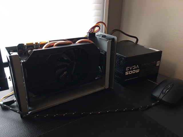

Dschijn Posted December 25, 2015 Share Posted December 25, 2015 Can you please explain what hardware/software you are using? Can you post a picture of your eGPU hardware? Quote Link to comment Share on other sites More sharing options...
blaine_sieck Posted December 25, 2015 Share Posted December 25, 2015 6 minutes ago, Dschijn said: Can you please explain what hardware/software you are using? Can you post a picture of your eGPU hardware? I am using a 2013 15" Retina MacBook Pro with the 750M, Akitio Thunder2, Gigabyte 970 Mini ITX, and EVGA PSU. I am running Windows 10 via Bootcamp on my MacBook Pro. Here are the pictures: Quote Link to comment Share on other sites More sharing options...

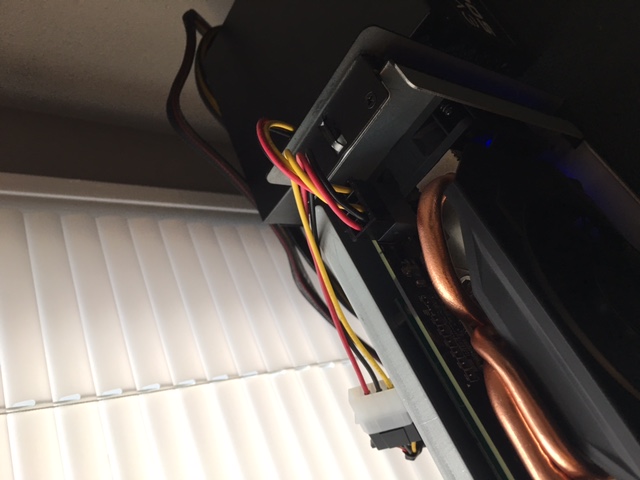

Dschijn Posted December 25, 2015 Share Posted December 25, 2015 What is that 8-Pin plug going into the GPU? That looks not healthy. Can you make a close up off that? Doesn't the PSU have a native 8-Pin plug? Did you also apply the paperclip trick on the PSU? Quote Link to comment Share on other sites More sharing options...
blaine_sieck Posted December 25, 2015 Share Posted December 25, 2015 11 minutes ago, Dschijn said: What is that 8-Pin plug going into the GPU? That looks not healthy. Can you make a close up off that? Doesn't the PSU have a native 8-Pin plug? Did you also apply the paperclip trick on the PSU? No the PSU doesn't have a native 8 pin. It has a 6pin thing with a 2 pin next to it but I don't think they fit into the 8 pin. I can't remember but I think either my PSU or GPU came with this adapter thing that took the 2 wide 4 pin things and it converts to 8 pin. And yes the guy who did my electrical work did the paper clip trick Quote Link to comment Share on other sites More sharing options...
