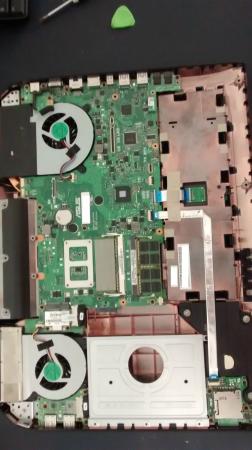

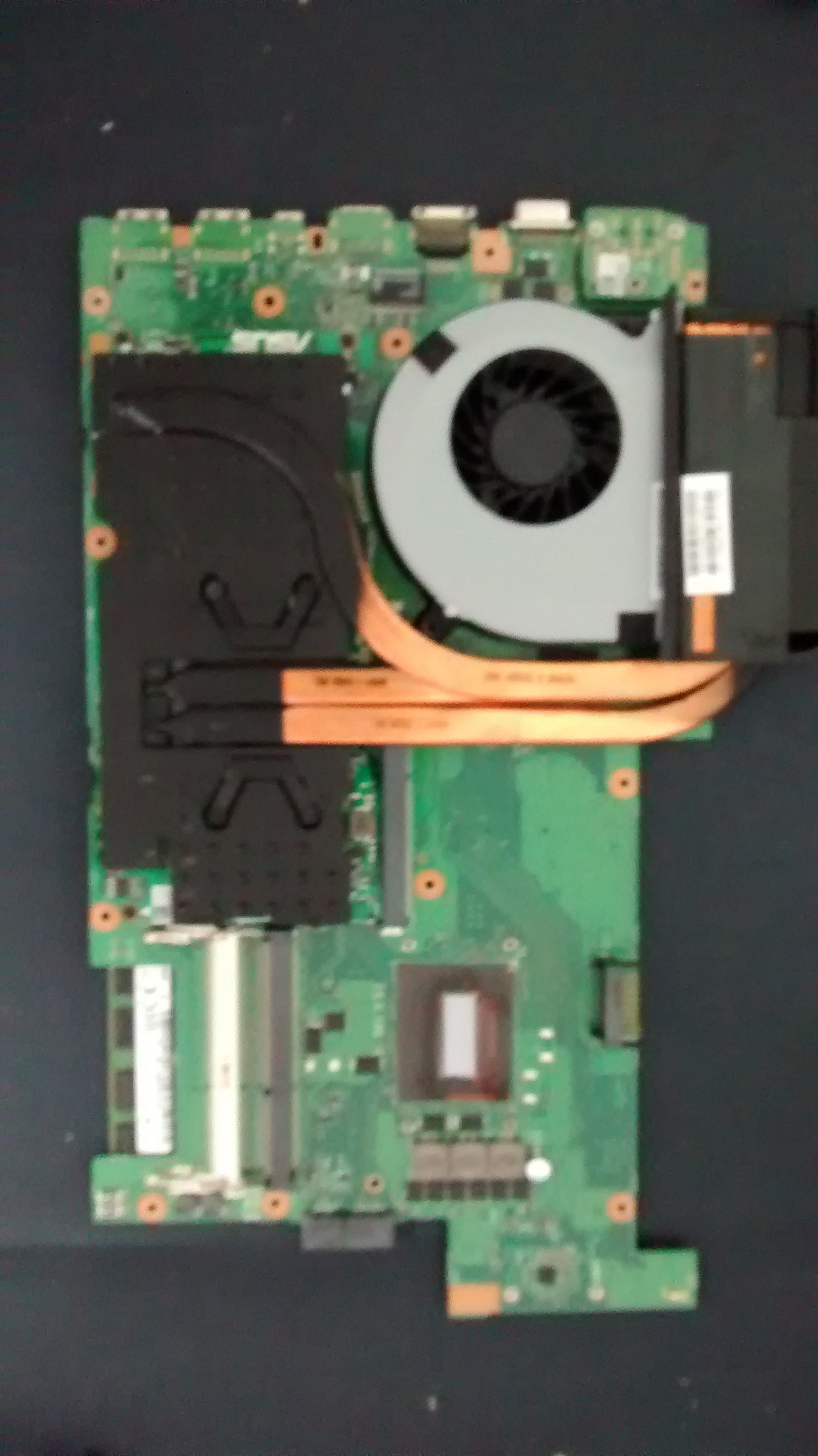

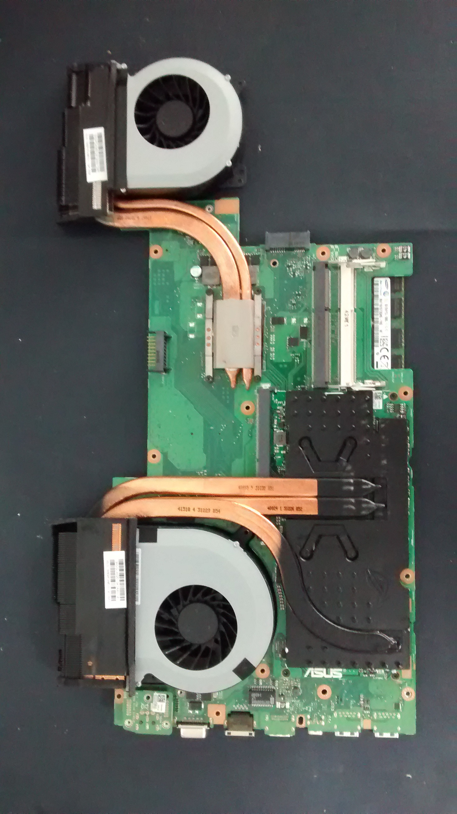

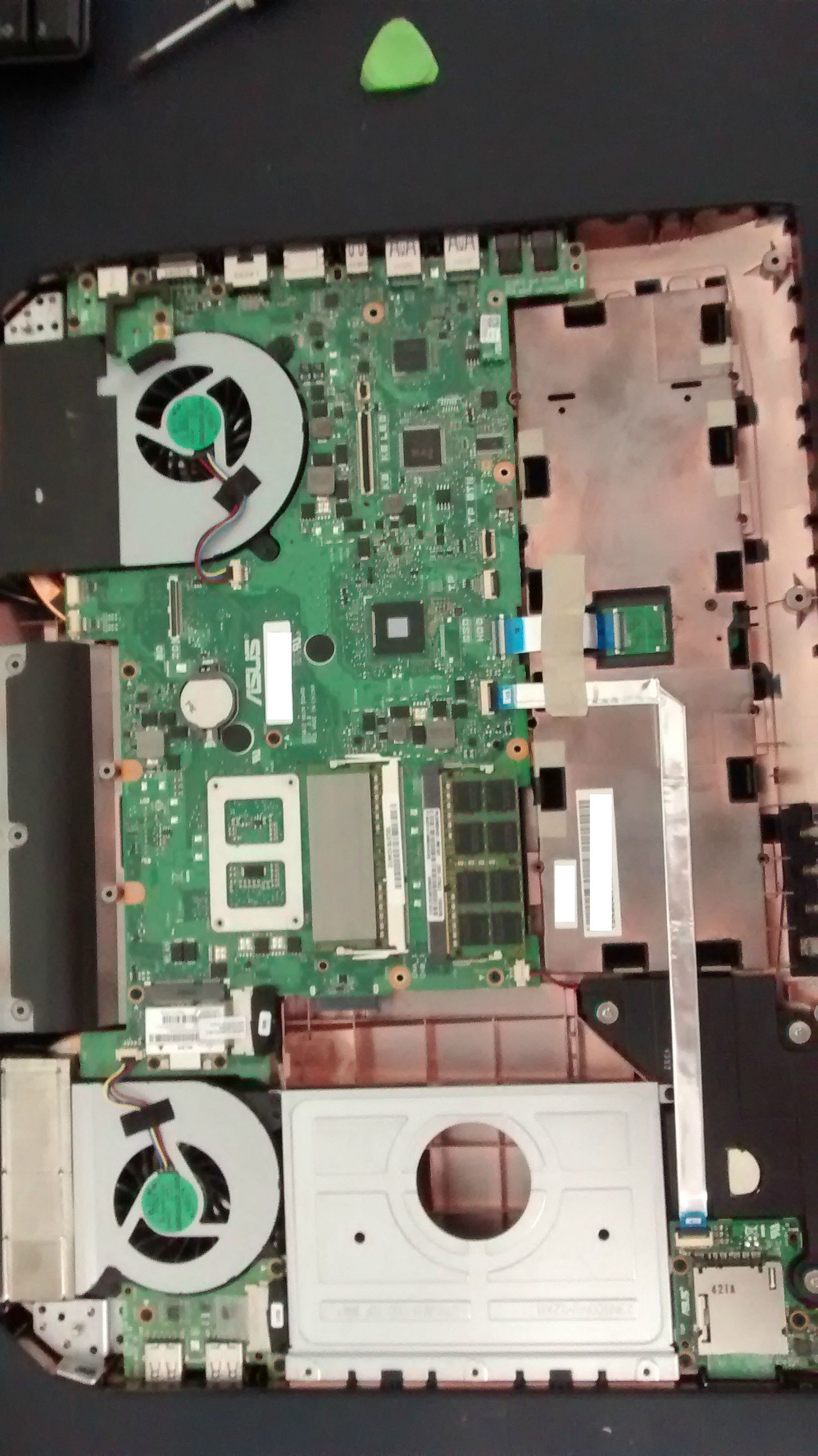

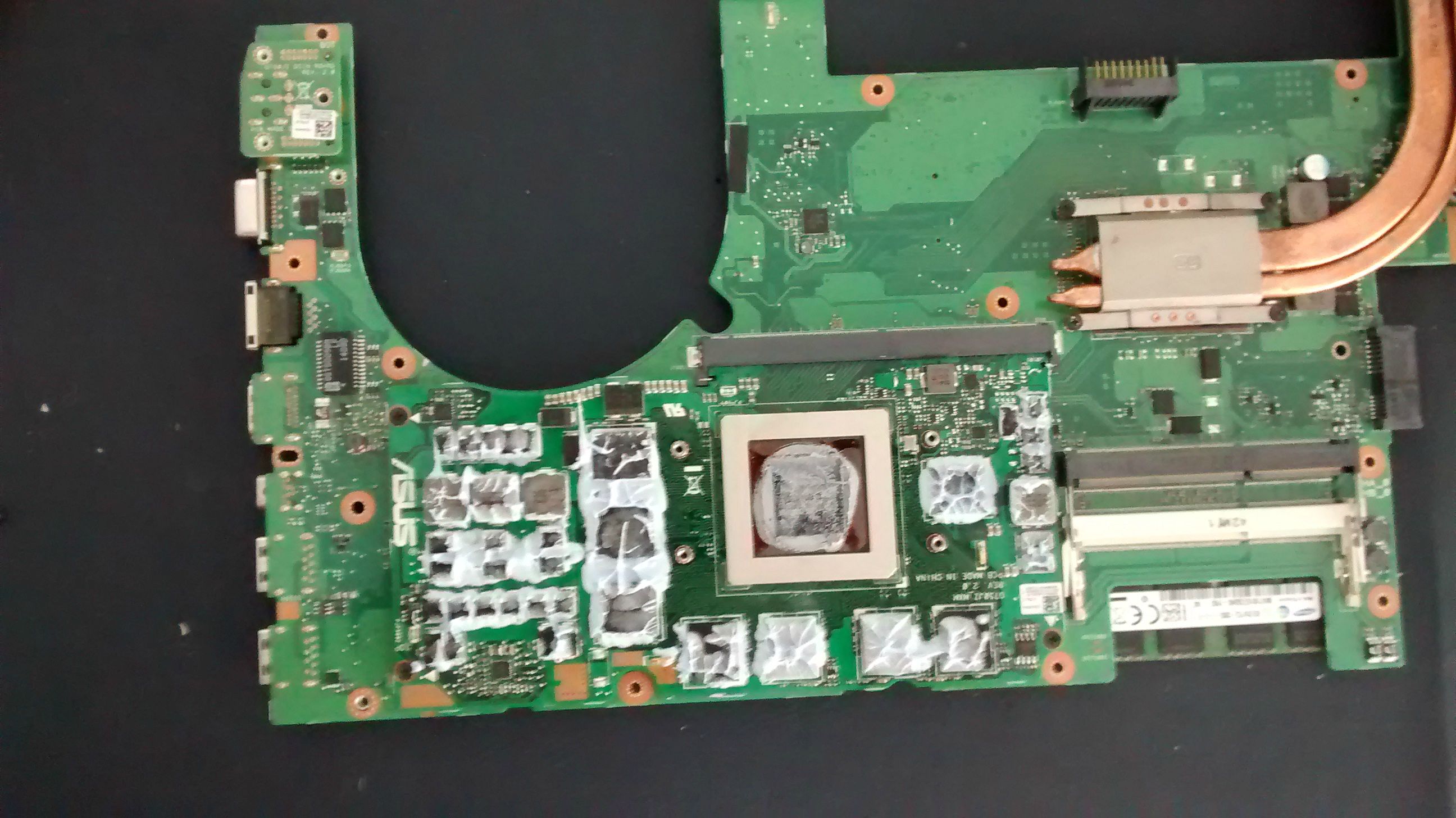

ithanium2 Posted July 3, 2014 Author Share Posted July 3, 2014 So today I managed to repaste my laptop...again. Funny that the TIM on the GPU was abit dry, just after 10 days. The CPU seemed fine. I took some pictures if people are interested about the insides of the JZ. Sorry about the picture quality...crappy phone What I noticed tho that only the GPU radiator seems to be copper, the CPU one is aluminum. Now, I am not sure what to think since my laptop was in service where they claimed to have changed the cooling system (dunno if CPU/GPU or both). After some testing I will post the initial temperature results and after 10 days I will test again to see the TIM degradation. Quote Link to comment Share on other sites More sharing options...
ithanium2 Posted July 5, 2014 Author Share Posted July 5, 2014 Ok, so far the CPU temps seem to be excelent in the 70 degrees Celsius range, but the GPU is still at the 85 degrees Celsius range. I would like to try another repaste in the near future, GPU only this time, but the problem is that I probably need to replace the thermal pads, and well, I got no clue where to buy new ones that look the same (laptop is still in warranty). One odd thing that I noticed was that in both times I repasted, the TIM on the GPU was a little dry and with the heatsink mounted, the GPU pcb module was a bit curved... Quote Link to comment Share on other sites More sharing options...
ithanium2 Posted July 8, 2014 Author Share Posted July 8, 2014 Ok temps went up dramatically. Basically now the CPU reaches 83-84 degrees but oddly enough the GPU temps remain the same. In conclusion, the MX4 is crap...atleast for laptops (because on my desktop I used it both for CPU and GPU and didn't have problems).I dunno what to use. Liquid Ultra and IC Diamond are a no-no, because of warranty issues. IC Diamond scratches the dies and Liquid Ultra might corrode or atleast leave marks on the heatsinks. I am considering the Gelid GC-Extreme but really, other suggestions are welcome.The GPU is another story and I suspect that it has something to do with the pressure of the cooling system being to high and actually curving the PCB of the video card. Also, worthed to mention is the fact that the TIM on the GPU was kinda dry, while the one on CPU was perfect, both in consistency and the TIM mark. Quote Link to comment Share on other sites More sharing options...
