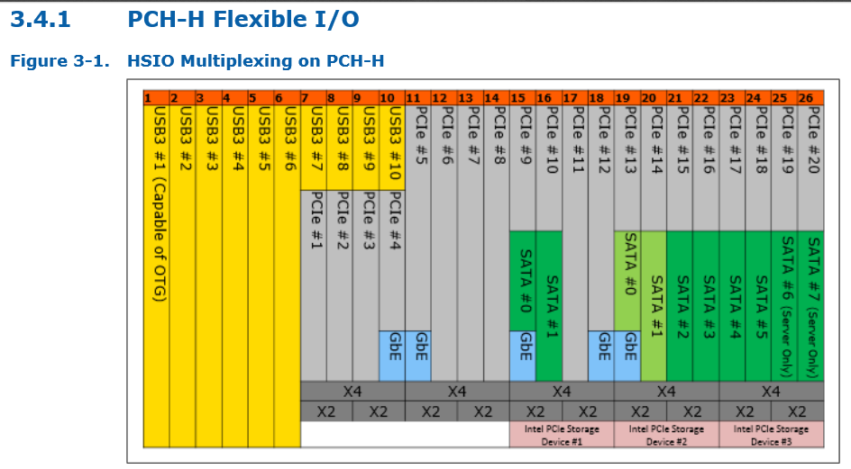

Seems like Flexible I/O is still a feature in series 100 chipset but series 100 chipset goes from up to 8 PCIe 2.0 to 20 PCIe 3.0 ports!!!
Intel® 100 Series Chipset Family PCH Datasheet, Vol. 1 pg.26
Considering that x1.3 is faster than x1.2 and almost as fast as x2.2 link an potential x2 3.0 would be almost as fast as TB2!!! It would be difficult to find adjacent ports to create the x2 link out of the 20 ports but most Broadwell/Skylake laptops come with M.2 slots for WiFi and/or Storage...
It could be feasible though to use a M.2 WiFi or Storage port along with a working adapter for the eGPU either x2.3 or x4.3...
TB3 is now officially supporting eGPUs but if x2.3 is easily implemented, it could be a cheaper solution for low budget Skylake laptops since any adapter will be passive (no thunderbolt chips on either sides)...
UPDATE: Bplus announced a new adapter the PE4C V4.1 which can use either an M.2 M or an M.2 A/E and is supposed to be able to achieve an x4.3 connection!!! Impressive performance for an $80 adapter! We will only need a laptop with an M.2 M key empty slot.
