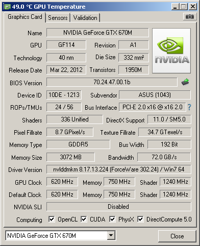

It seems like my 670M uses the one vbios that can't be altered with. So for now I have to set my GPU clock to 450 MHz for it to be stable.

But I got to increase my GPU clock from 400 mhz to 530 mhz, and that because I pushed the vcore from 0.9 V to 0.92 V. Not sure if I will get better results pushing it some more.

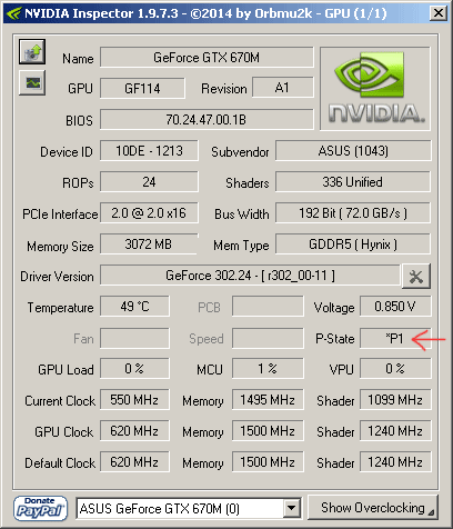

Now I've added this line to my startup
nvidiaInspector.exe "-forcePState:0,1 -SetPStateLimit:0,1 -setShaderClock:0,2,1100 -setMemoryClock:0,2,1501 -setVoltage:0,1,850"
So I manually set my GPU clock (shaderclock) to 1100mhz which gives my card 550mhz, thats 70 mhz down from original speed. But now it works flawless with no shutdowns.
