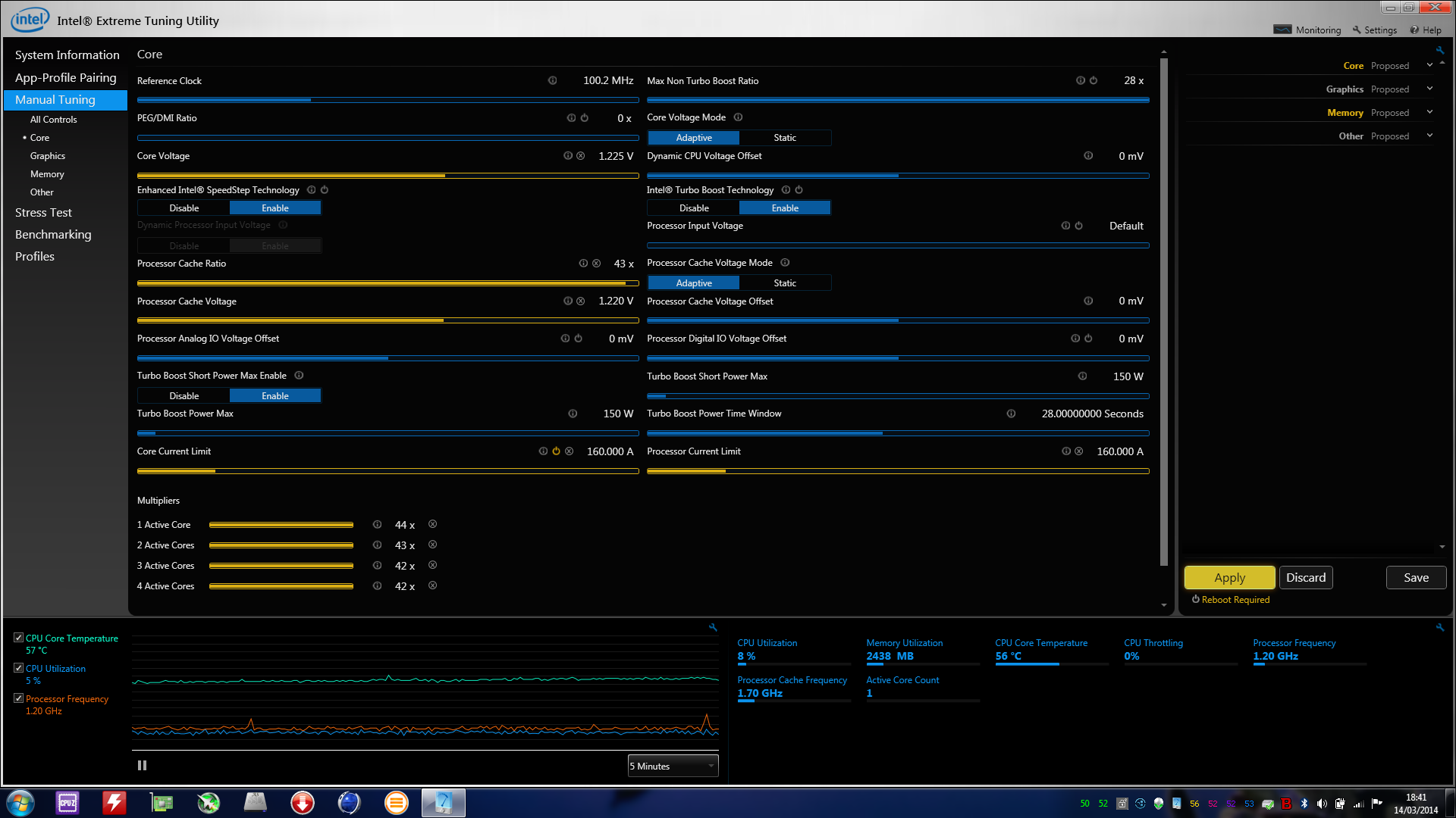

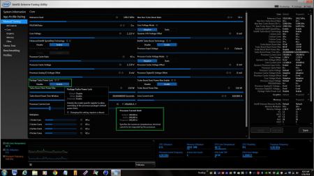

This seems to be better to me, too. I'm excited about testing to see how it performs. Right off the bat I noticed something good! My Processor Current Limit default is now 190.000A versus a pathetic 55.000A before! Yay! I used to have to set this manually at every boot with XTU or ThrottleStop. Since I just flashed it, I still need to test the behavior, but in additon to the Processor Current Limit now being 190.0000A versus 55.000A, there is a new feature in XTU that was not there before the flash. It is called Package Turbo Power Lock. XTU's description is "Unlocks the model specific register to allow overriding of the processor package's default power limits." This option was enabled by default.

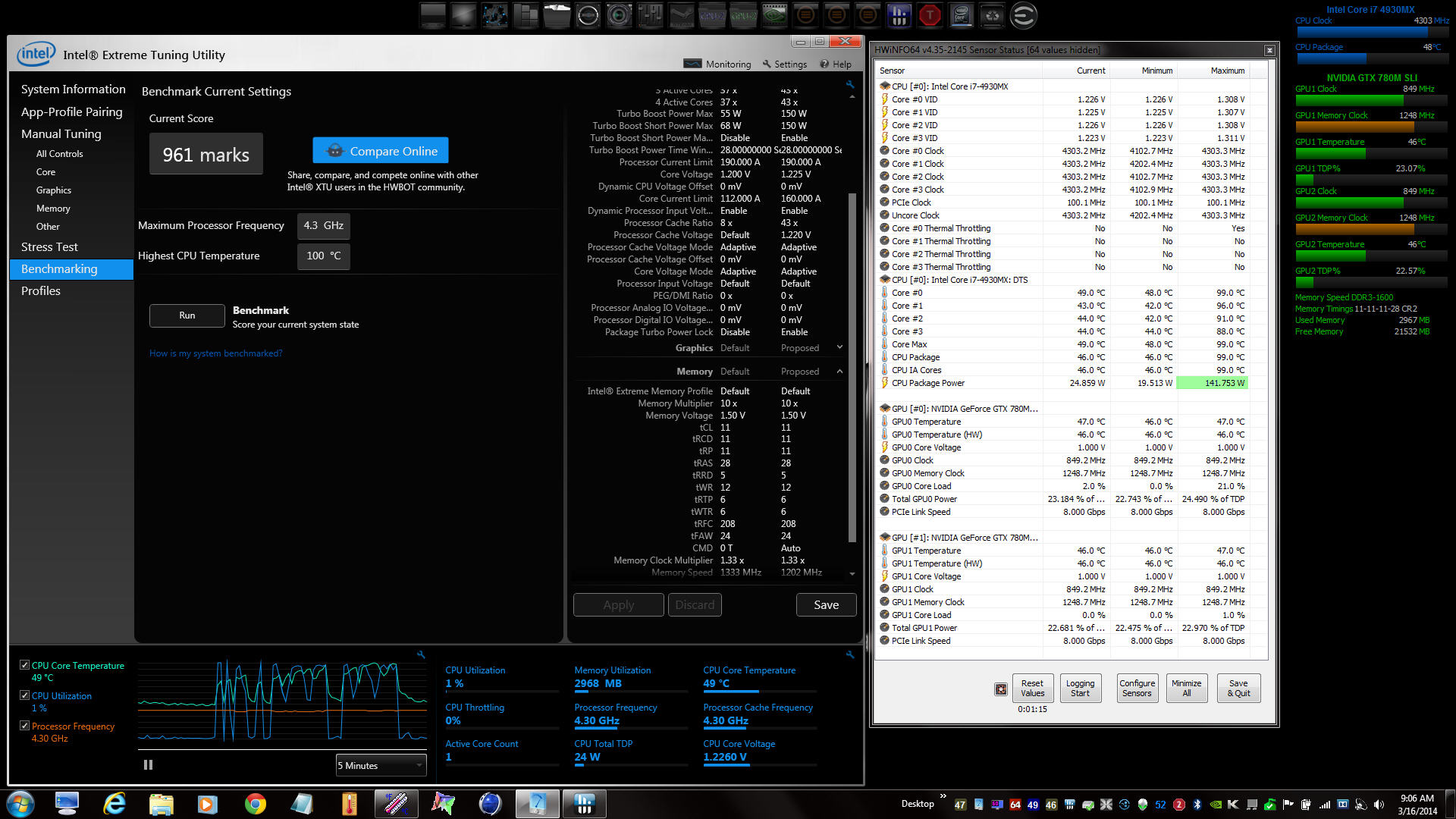

Well, here is what I discovered. Package Turbo Power Lock caps your sliders to match what you set manually in the BIOS and grays out the Package Power Limit entries in ThrottleStop, but if you choose "Disabled" for Package Turbo Power Lock and reboot, that button disappears from XTU and then the sliders and ThrottleStop settings are unlocked. I am seeing better XTU benchmark scores (by a little bit) and temps are about the same as before, so nothing negative to report so far... only positive about the Processor Current Limit not being gimped at the 55.000A default.

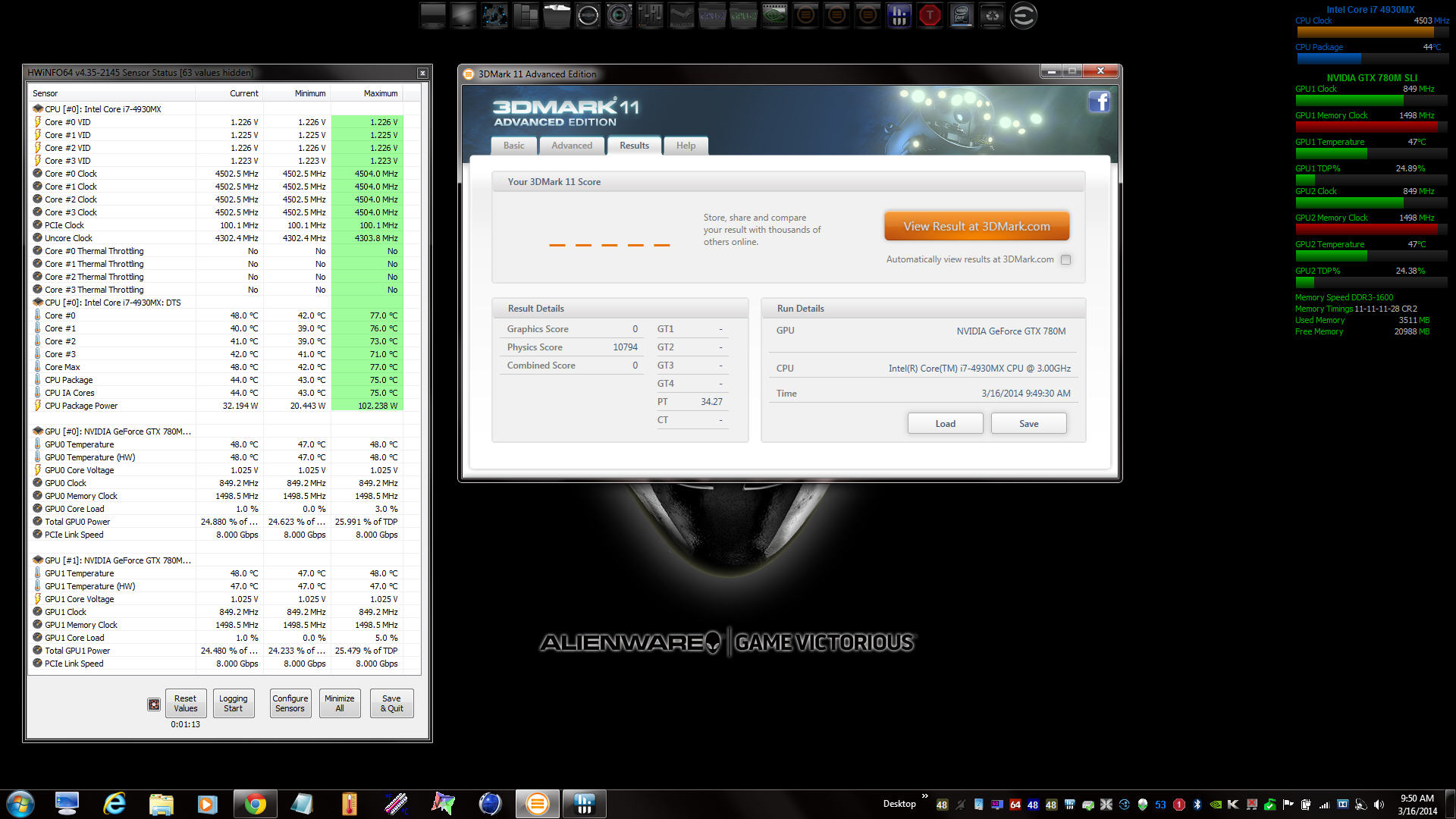

CPU hits 140W without much effort and temps are still managed with Liquid Ultra paste. The CPU still turns lower Physics scores in 3DMark11 than my 3920XM, but overall there is good reason to be happy because the BIOS is better than it was before. I still need to check to see if Secure Flash was removed. I have to go find svl7's tool in the A04 thread and find out. Will do that sometime today. Not going to hold my breath on that, but hope springs eternal, LOL.
Edit: here is a 3DMark11 Physics Test. Note the good temps with Liquid Ultra. This is not as good as 3920XM (over 11K at this speed) but it is about 200~ 3DMarks higher than it would do with A04 at the same clock speeds. And, it seems like my 4930MX is throttling less than it used to. So, moving in the right direction.
