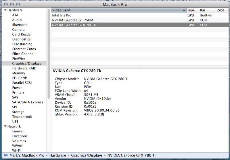

Mark Posted August 3, 2014 Share Posted August 3, 2014 Hey guys, I've tried to get my 780 Ti to work on 10.9.4 but although it was detected on the Video Card info in System Information, I have a black screen on my external monitor and nothing is displaying at all. I've done the following: - Installed a fresh copy of Mavericks - Followed the instructions on this thread - Installed the latest NVIDIA drivers for 10.9.4 (334.01.02f02), apparently this fixes the 780 Ti compatibility issue - Plugged the monitor directly to the graphics card via DVI and then tried using HDMI - Repaired the kext cache several times, using both Terminal and Kext Wizard And none of it still works, I feel like giving up If I'm allowed to, can I copy what I have on my .kexts? It might be that I have the locations wrong. And is there anything that I've missed/done wrong? Quote Link to comment Share on other sites More sharing options...
Mark Posted August 3, 2014 Share Posted August 3, 2014 Okay, never mind, I actually got this to work by chance!This is what I've done since my last post (in order)- Reinstalled the NVIDIA driver- Edited and checked the three .kext files (Reinstalling the driver resets one of them)- Ran Kext Wizard- Restarted the computerAnd it worked! My external monitor is now running off the 780Ti! To make sure that it wasn't just me getting lucky, I unplugged everything and turned off the eGPU completely (from the power socket), turned on the laptop on its own and shut it down. I plugged everything again while it was off and it didn't work. However, I restarted the computer without doing anything else and the eGPU is working again! So this is how to use the eGPU in Mavericks when plugging it in:- Turn off the MacBook- Plug in the eGPU- Power on the PSU for the eGPU- Turn on the MacBook. The eGPU won't output anything on the external monitor at this stage.- Restart the MacBook.For the record, I was using an MSI GTX 780Ti and a Sonnet Echo Express SEL. The MacBook I'm using is the Late 2013 model with the GT 750M dGPU. 1 Quote Link to comment Share on other sites More sharing options...

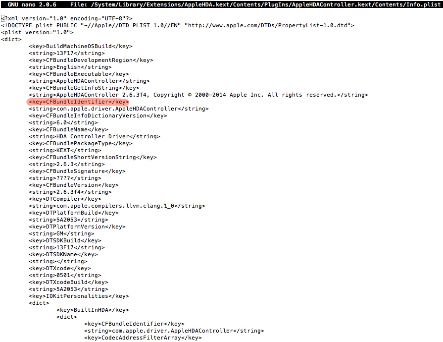

chrisprabhu Posted September 27, 2014 Share Posted September 27, 2014 I've tried following Shelltoe's walkthrough twice now and still no luck. (Thanks for such a clear walkthrough btw!) My Sonnet Echo Pro is recognized under thunderboldt adapters but not the graphics card. I have a mid 2011 Macbook Air 13in. OSX 10.9.5 GTX 650 Ti ViDock 3 External power supply for the 6-pin _____________________________________________________ Just to confirm you need one <key></key> <key>IOPCITunnelCompatible</key> <true/> only for each CFBundleidentifier where it's the FIRST < key > under the < dict >, correct? I see CFBundleidentifier in other places but there are other < key >s before it. . Example: Does this need one? And yes I'm sure I refreshed the cache! Any suggestions? Thanks, Chris! Quote Link to comment Share on other sites More sharing options...
