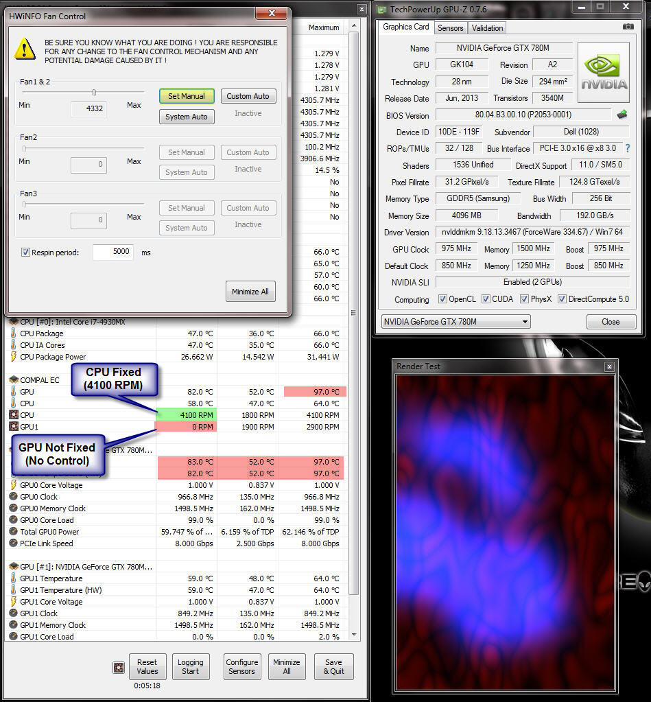

  1. Crippled CPU Fan Speed - Fixed - CPU Fan Now Runs 4100 RPM (unknown if fan reaction latency was corrected)
  2. GPU Fan Control - Not Fixed - Hit 101°C and Thermal Shutdown During Test

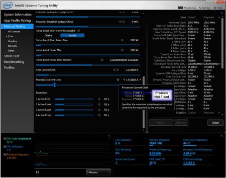

  3. CPU Processor Current Limit - Not Fixed - Still Set at 55.000A by Default

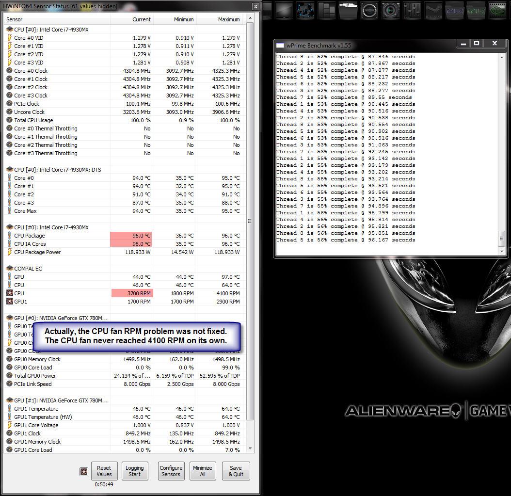

The stock fans tables do seem to behave better. The profile is not as aggressive as I would like it to be, but based on the benchmarks I just ran the fans are actually ramping up now and the system is running cooler. While it is not manual fan control that Alienware 18 owners want and deserve to have like owners of earlier models, it is a step in the right direction. Minor improvement is better than no improvement. Of note, I am not experiencing the CPU having to hit 96°C before the CPU fan kicks in any more. That is a very welcome change. The Vantage run I just completed would have ended in a thermal shutdown with the A03 fan tables. The fans were not roaring as I wish they would, but seem to be working better.

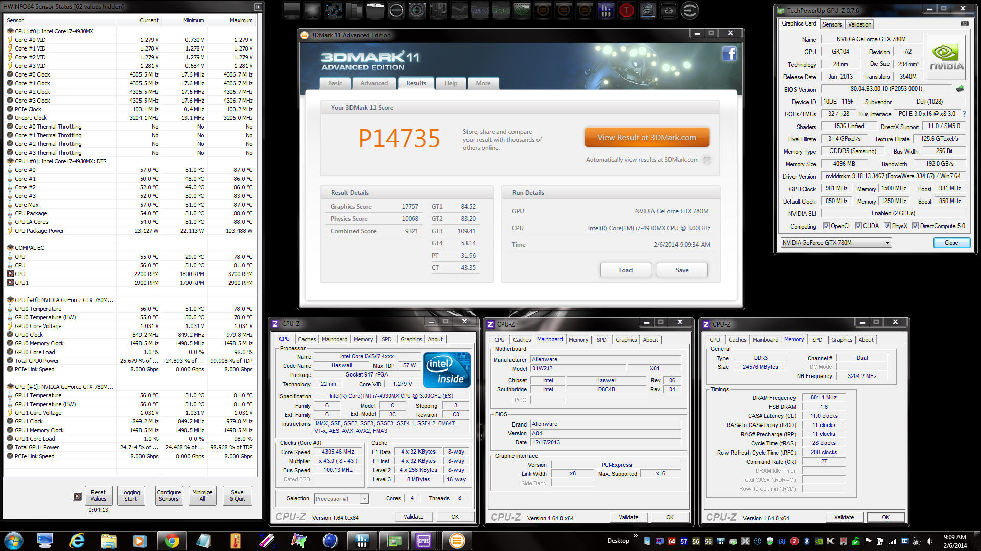

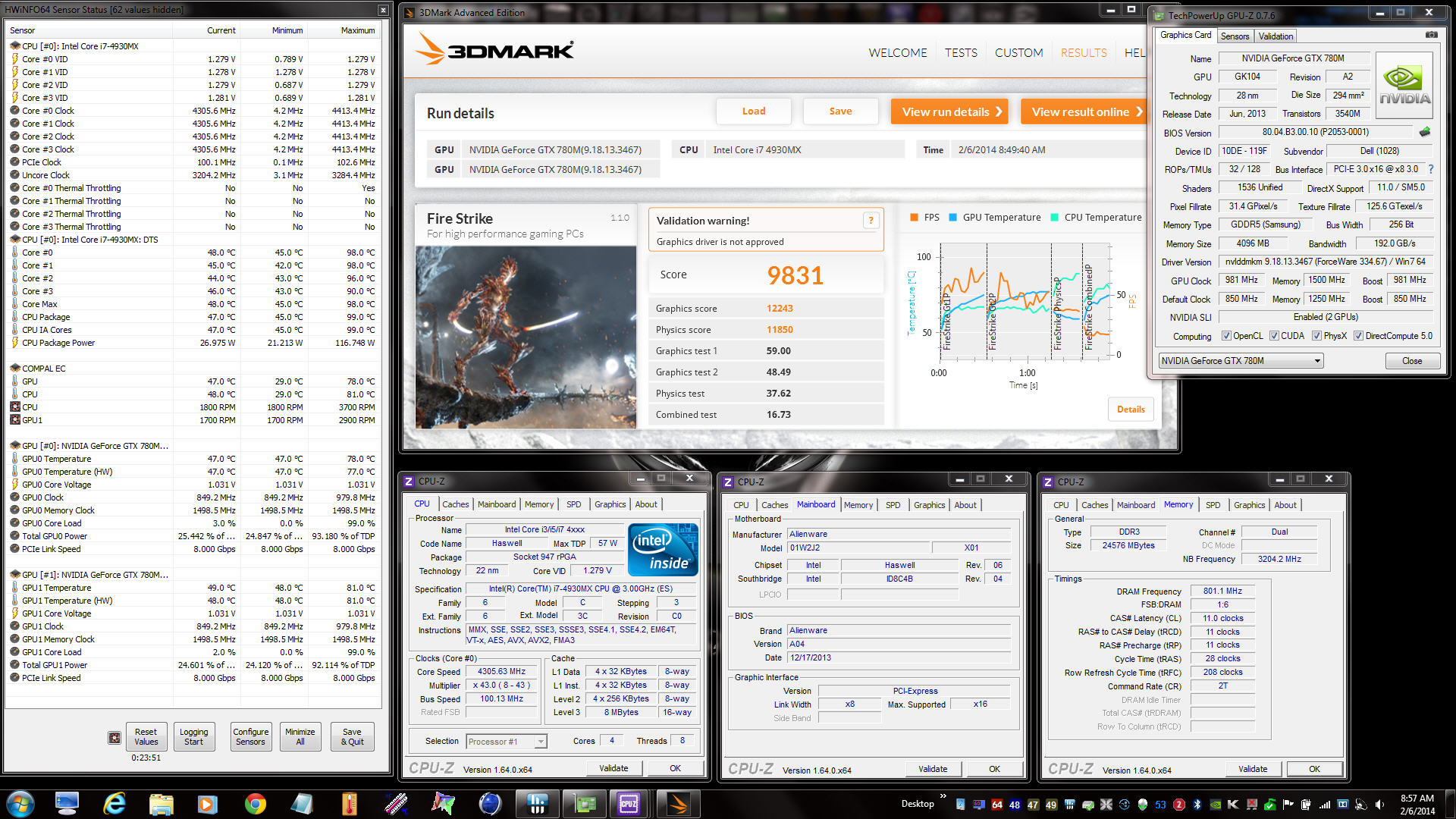

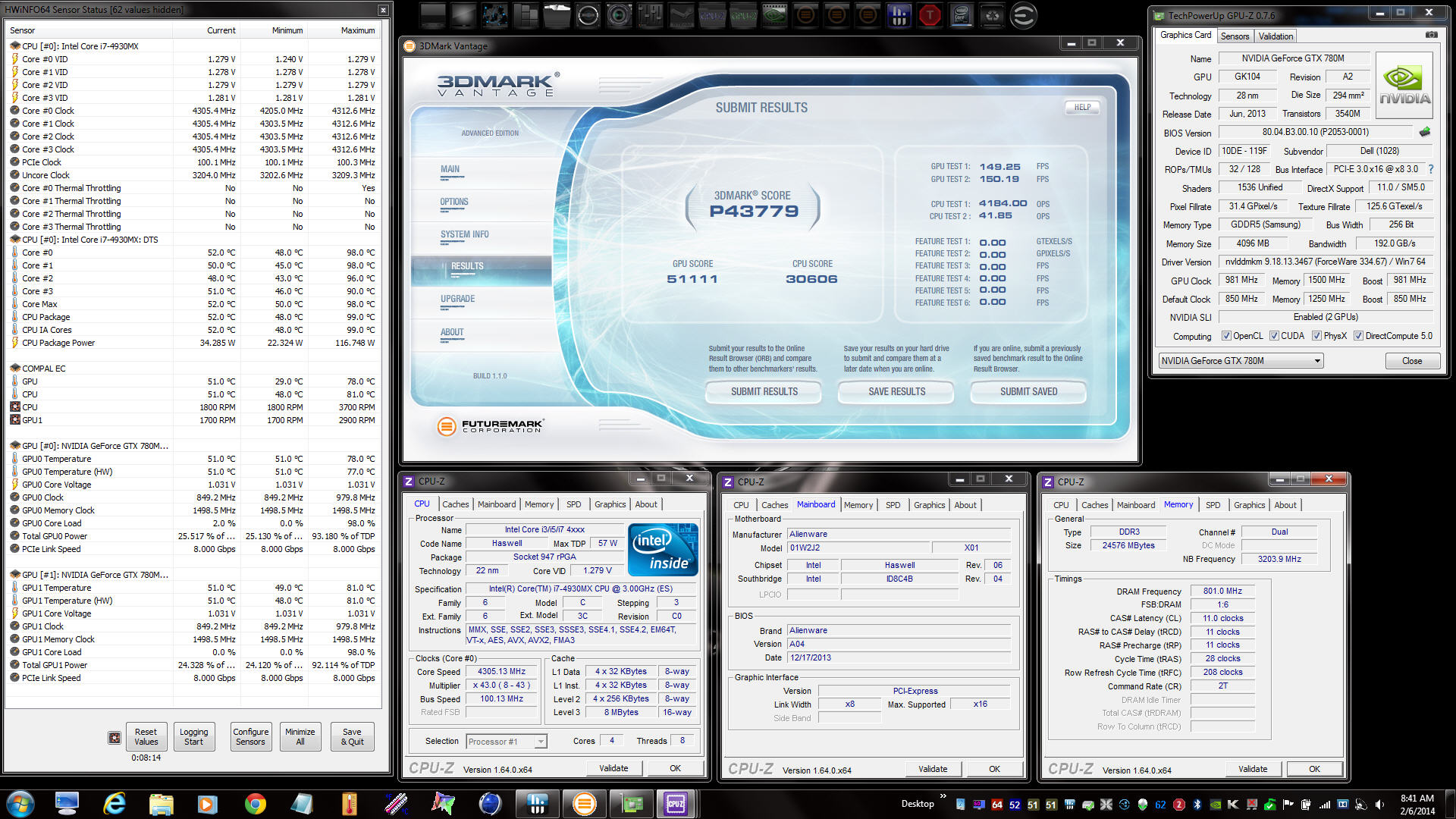

Here are some overclocked benchmarks. Just testing fans/cooling, not trying to beat my previous best scores. Remember that Fire Strike doesn't require an especially powerful CPU... it's primarily a GPU test and you can get a good Fire Strike score with a pretty wimpy CPU. It is the 3DMark11 and Vantage CPU temperature test results that truly count for something here. Credit where it is due... it is better than before. It really is a terrible shame that they have capped the stinking CPU fan speed below what it is designed to run. That sucks.

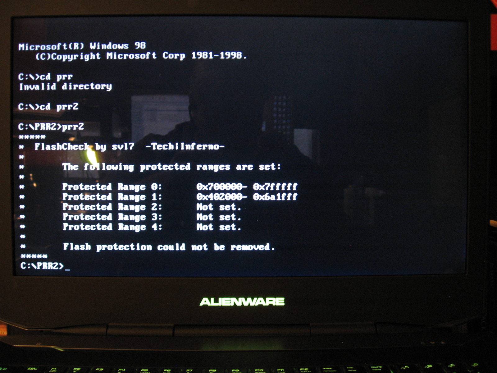

@svl7 - when you have time to look at A04, would you be able to determine if the reigns have been loosened with Secure Flash, or if they left a new back door for an exploit to expose hidden menus through an EFI shell command? Not sure if you can determine this from looking at the new BIOS package or if we need to run some commands to see if we get the same errors as before about read-only ranges.

HWiNFO64 will cut the power to the GPU fans and they will overheat... at least with 780M SLI. I tried it after flashing A04 and it is the same as with A03. With Google Chrome open my primary GPU hit 101°C in 3 or 4 minutes and the system shut down using HWiNFO64 manual fan control profile.
Will check the UEFI Vars when I get a chance. Still in the mountains, :Banane49:
Can you run my prr utility and let me know what it says?
:72: See attached...

The power-handling limitation on the new Alienware 18 is the most serious problem it has. At this point it is not even clear if this issue can be fixed without a motherboard redesign. Without this being fixed having an unlocked BIOS is not going to be as valuable because you won't be able to push the envelope on performance any more than you already can right now. We still need it unlocked to control other important settings that are not available, but there are reasons beyond overclocking where the unlocked BIOS adds value.
