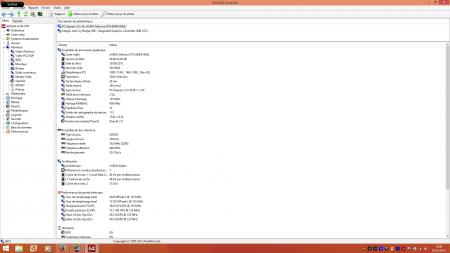

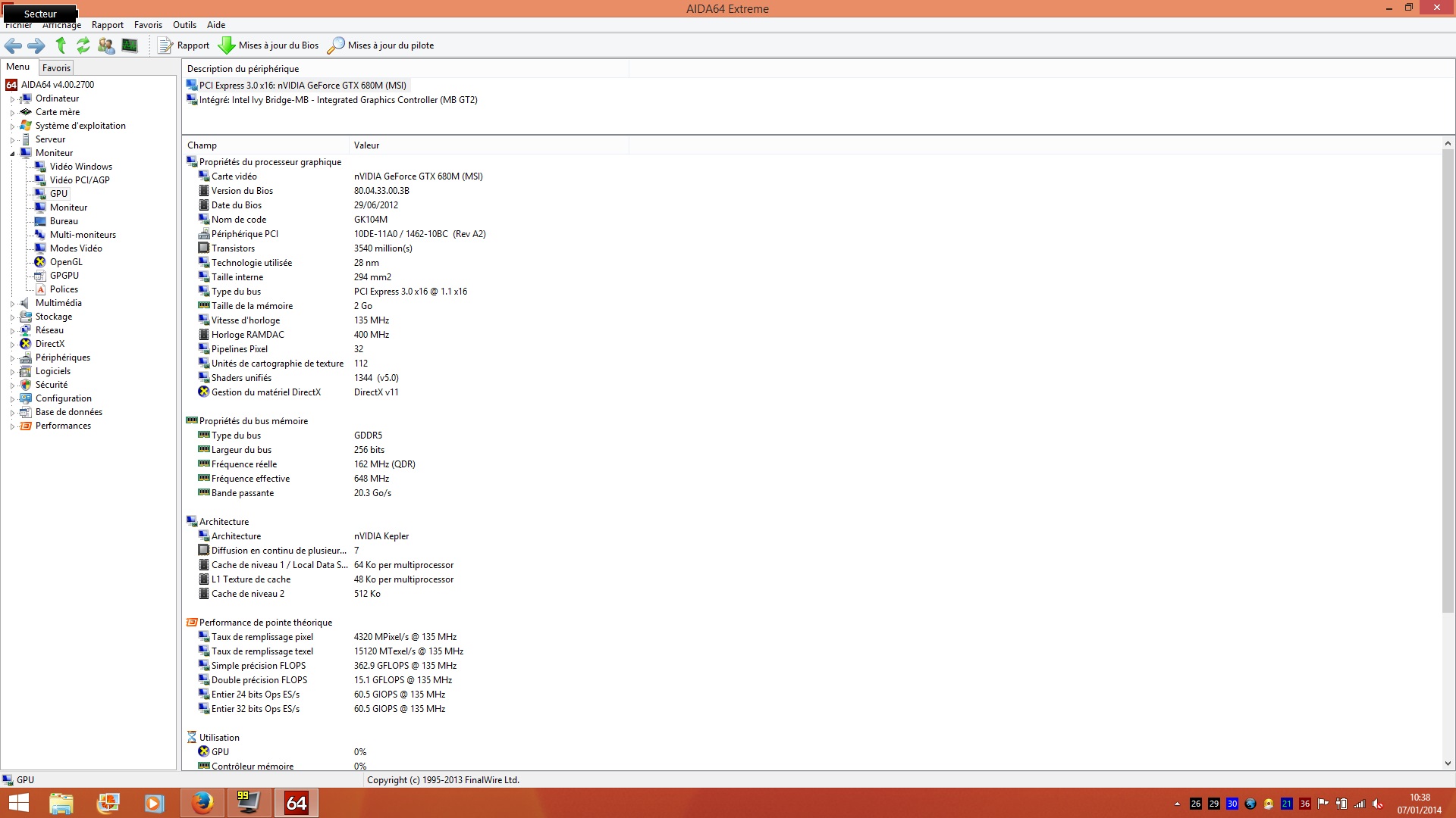

Hello!
For starts, I'm French, I used an online traductor, I hope you could understand with no problems..
I thus have this model, during the overclock already by weak(weakness) frequencies, I have a throttle when the card(map) warms, thus the OC serve has nothing...
For information I changed the thermal dough, sanded the thermal surface of crossed off(radiated), I turn(shoot) in maxi 90°C in the games(sets)..
I saw that he(it) fallais (among others) to change the VBIOS of the card(map)? Already on which base(basis) refer??
Thank you for your future information!
