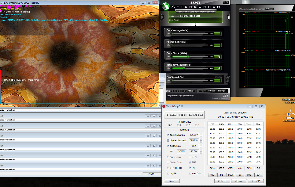

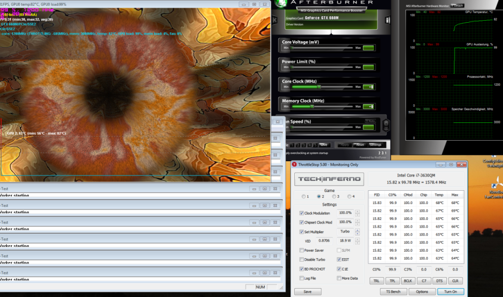

I noticed that the CPU, the i7-3630QM, starts to throttle while I'm playing really demanding games like Crysis 3.
But the temperatures are good, because I repasted my Y580 some time ago... (->no thermal throttling)
(CPU throttles down to 1500Mhz, Throttlestop made no difference when turned on, in this picture turned off)

THE RESULT
With the stock adapter (120W) the power consumption of my overclocked Y580 goes sometimes up to 143W. Thats the moment when the CPU starts to throttle.
With the new adapter (150W) the power consumption goes sometimes to a maximum of 162W. But the new adapter manages this and I noticed no more throttling.
I just used FurMark and Prime95 for screenshots. In games like Crysis 3 the power consumption is ~10 Watts lower.
