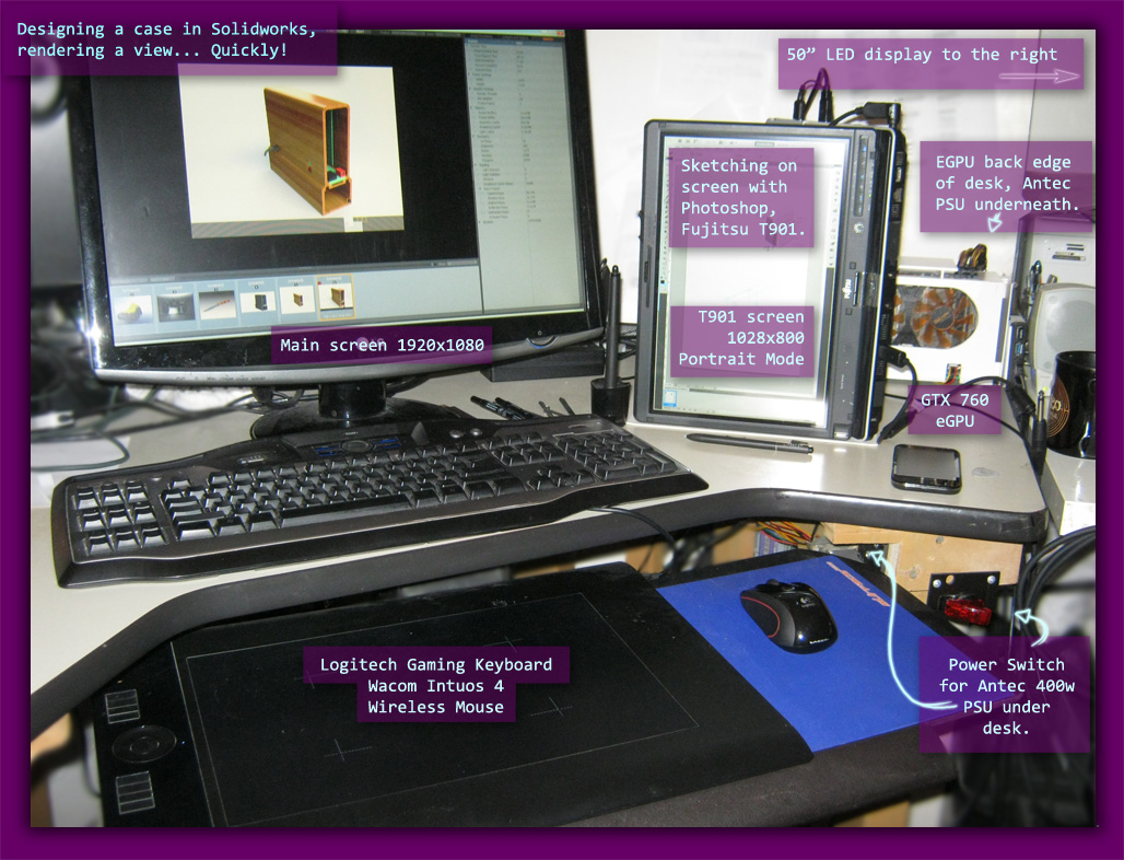

THANK YOU TECH INFERNO!!! AND ALL WHO CONTRIBUTE TO THE FORUMS!!!
Here is my new setup, totally replacing my desktop yet instantly mobile!
I am an industrial deign student, about to graduate. This arrangement of displays is improving productivity, I am loving it!

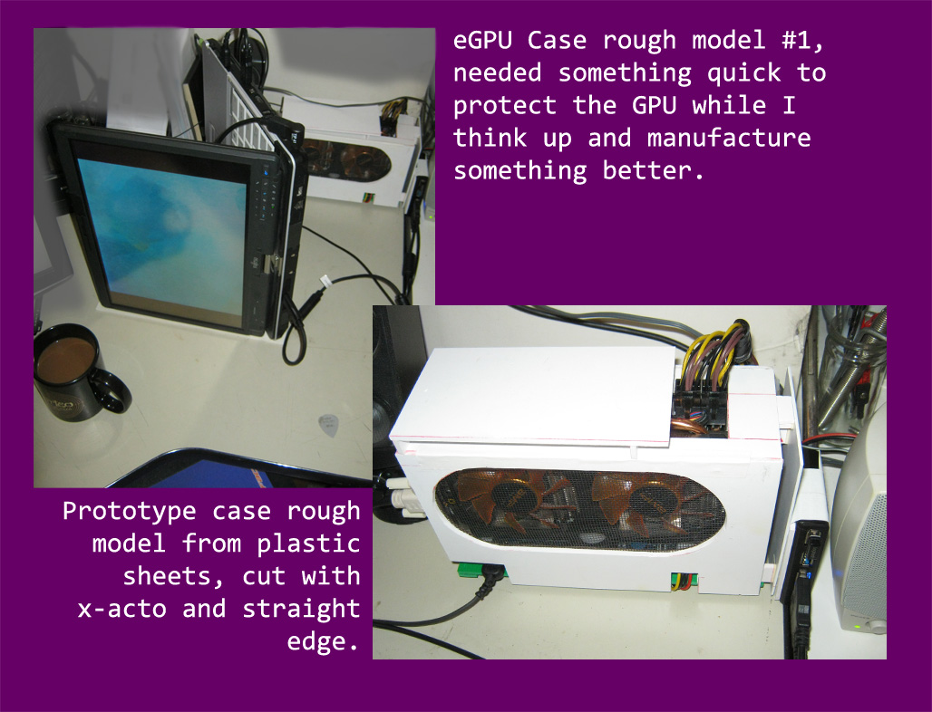

Here is the eGPU...
More to come, thanks again everyone!
KenInSF
P.S. the laptop is resting on a 2.5mm layer of padding, it seems happy with the hot air exhaust pointing up. There are no ports on the side facing down, just the extra battery in the CD drive bay.

T901:
i7-2620m
16gb ram
NVS4200m
500gb 7200rpm :( will be upgraded to an SSD... some day
eGPU:
Zotac gtx 760
Antec 400w PSU...
The PSU was formerly used for 3 water cooling loops in my old desktop overclocking rig ([email protected] 24/7 for like 4 years, crossfired volt modded ati4850's, CPU-GPU's-RAM all water cooled, industrial AC and dehumidifier for benching :P ).
Huge dedicated edifice on the desk is so 90's though... anyone want to buy a desktop pre rigged for water cooling? Kidding, as it really would be the entire desktop. The pumps and radiators are all mounted to the underside and tubing runs right into the base of the case through the desk. Everything is very custom... or full of oddly placed holes, depending on how much of a geek you are.

Not me on Reddit, some other guy. Temps running Unigine Heaven benchmark were 65c on the nvs4200m and 75c on the gtx 760. CPU temp unknown, suppose I need a temp monitor now that I'm pushing my tablet into the red zone.
