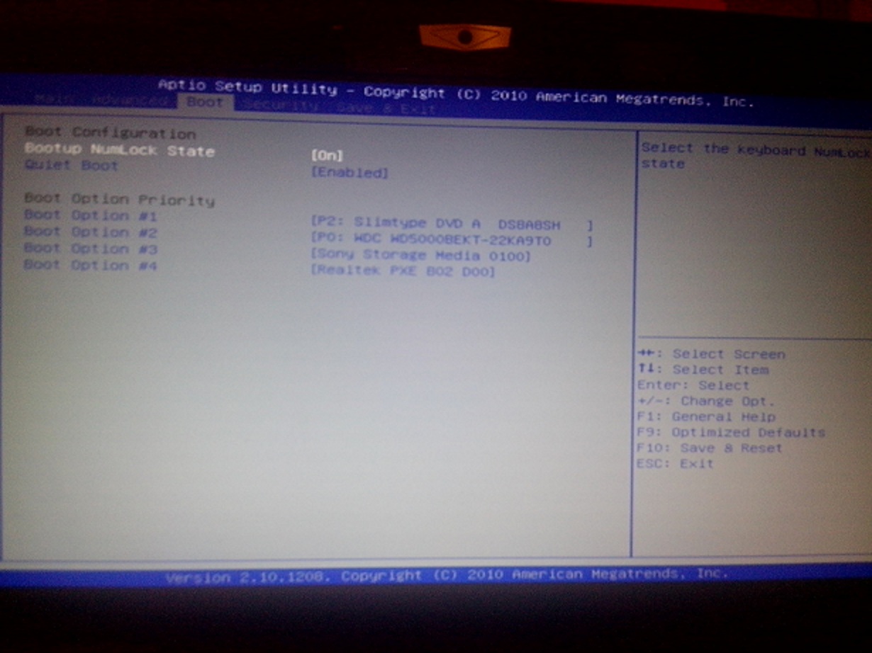

Can you get into the bios? Respectively can you somehow boot into DOS? A vbios dump would be interesting. Or do you happen to know the version?
Also make sure that you have legacy boot enabled, and not uefi secure boot / fast boot, i.e. uefi boot in general. Many MSI systems don't seem to properly support certain of those features, especially when it comes to the GPU.
Do you have the latest bios on your system?
@SvI7- no I can't get into the BIOS at all. The MSI logo screen shows, but all options are frozen. The 765m's VBIOs version is 80.06.61.00.01, however, that is all the information I got on it seeing as I can't do squat with the computer. I'll check the boot options you talked about, but the computer runs on AMI Aptio E1761IMS.10H, the latest version...which is from Nov. 2011. I tried flashing an unlocked version of the BIOS by Xonar, but got the "ROM file ROMID is not compatible" or something along those lines. I want to say that it might have to do with the card's VBIOS being all set up for a Dell alienware, so maybe if I can find someone with an alienware they can mod the VBIOS, but then again, I'm not a computer genius.

Can you post a link to the bios version that you use?
E1761IMS .10H
It's an AMI bios
http://www.msi.com/product/nb/GT780DX-GT780DXR-.html#/?div=BIOS&nbos=non-win 8
Your computer doesn't have UEFI so there's nothing like that enabled. I think the dell card won't work I'm afraid, a member on the forum tried a dell gtx 770m in the same machine and he had the same problem as you, he flashed a Clevo and a MSI VBIOS on it but it still didn't work.
