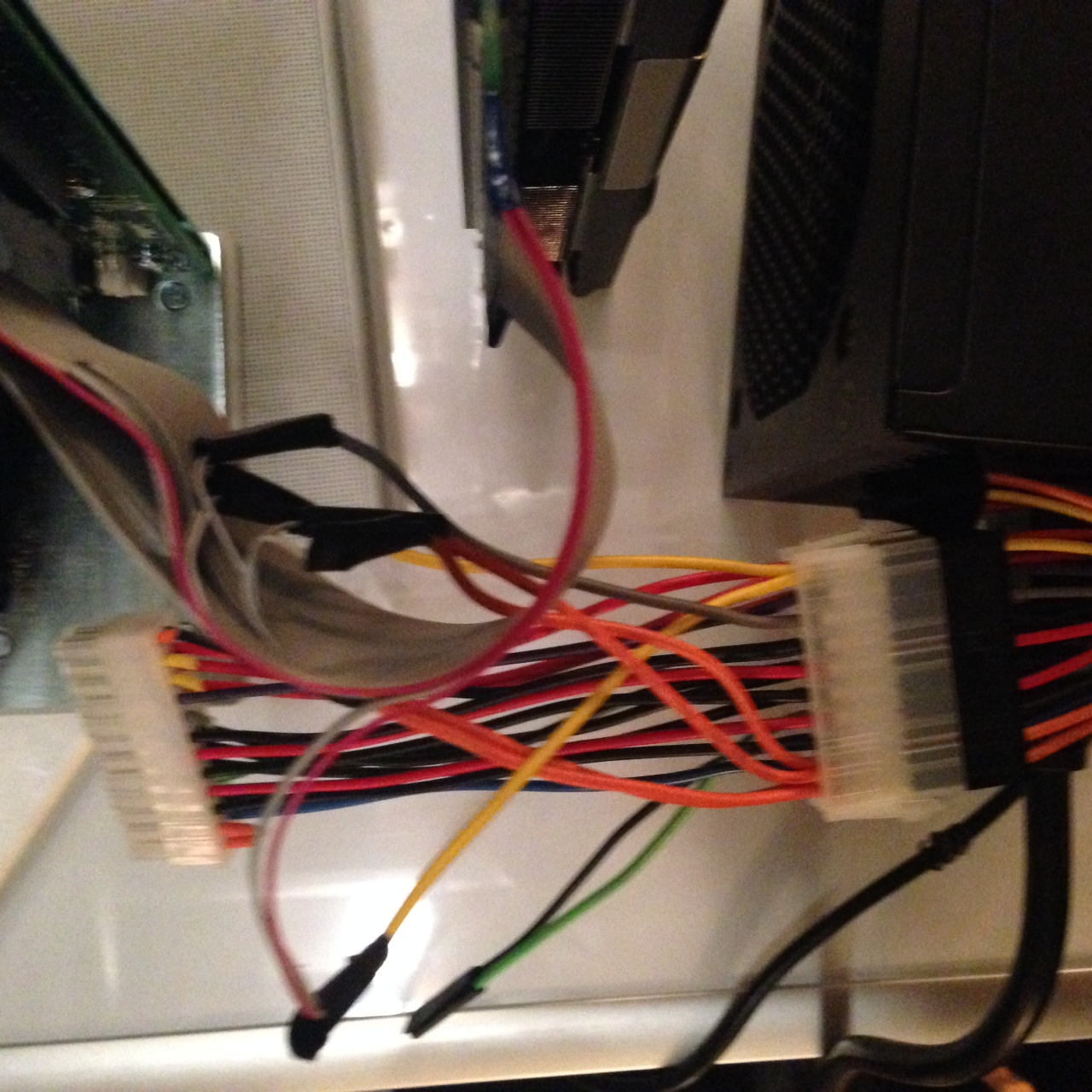

LXPK Posted June 14, 2014 Share Posted June 14, 2014 http://forum.techinferno.com/diy-e-gpu-projects/4570-%5Bguide%5D-2012-13-rmbp-gtx660-sonnet-echo-express-se-%40-10gbps.html#post63754According to that guide, the Echo boxes require splicing up the cable to prevent the slot from providing power and to only allow power to come from the PSU because the Echo lacks some kind of power timer delay.This is a little intimidating.Can anyone confirm if this is necessary to get the Sonnet Echo SEL working? Also I saw guide pictures but it would be AWESOME if someone could record a video of how this is done. Quote Link to comment Share on other sites More sharing options...
Arise Posted June 14, 2014 Share Posted June 14, 2014 Yes, you need to buy a riser/extender card, cut some wires and solder them to an atx extender. Is kinda easy actually. Sent from my iPhone using Tapatalk 2 Quote Link to comment Share on other sites More sharing options...

LXPK Posted June 15, 2014 Share Posted June 15, 2014 Wait a second. The card must have its fans spinning, otherwise it means it is not working. What card you have there? Sent from my iPhone using Tapatalk EVGA GTX 780. The fans spin up when I hit the power button on the PSU which is giving it all its power via the 6 and 8 pins and the ATX-PCIe spliced wires that would otherwise be powered by the Sonnet slot. Here's a picture: Is it a problem that the ATX PSU cable I spliced is a 20-24 pin with some of its wires coming out as splits from the 20 connected to to the PSU? I couldn't find any colored 24-24 pin cables at Fry's only the all red kind which would be tricky to keep organized. Quote Link to comment Share on other sites More sharing options...
Arise Posted June 15, 2014 Share Posted June 15, 2014 Yes, I think it looks ok. You can remove the other end and all wires not used and keep only one end to connect to the PSU. Use a needle to remove the wires from the connector.Disconnect the video card from the slot and remove the sonnet echo.Start the PSU with one fan connected to it and with a multimeter check all wires for voltages and see if all of them are wired properly.If all good, reconnect everything and boot again, before windows boot loader manager connect thunderbolt. If no sign of video card, cold reset a couple of times. But it should work if you test it a little.Sent from my Nexus 4 using Tapatalk Quote Link to comment Share on other sites More sharing options...
