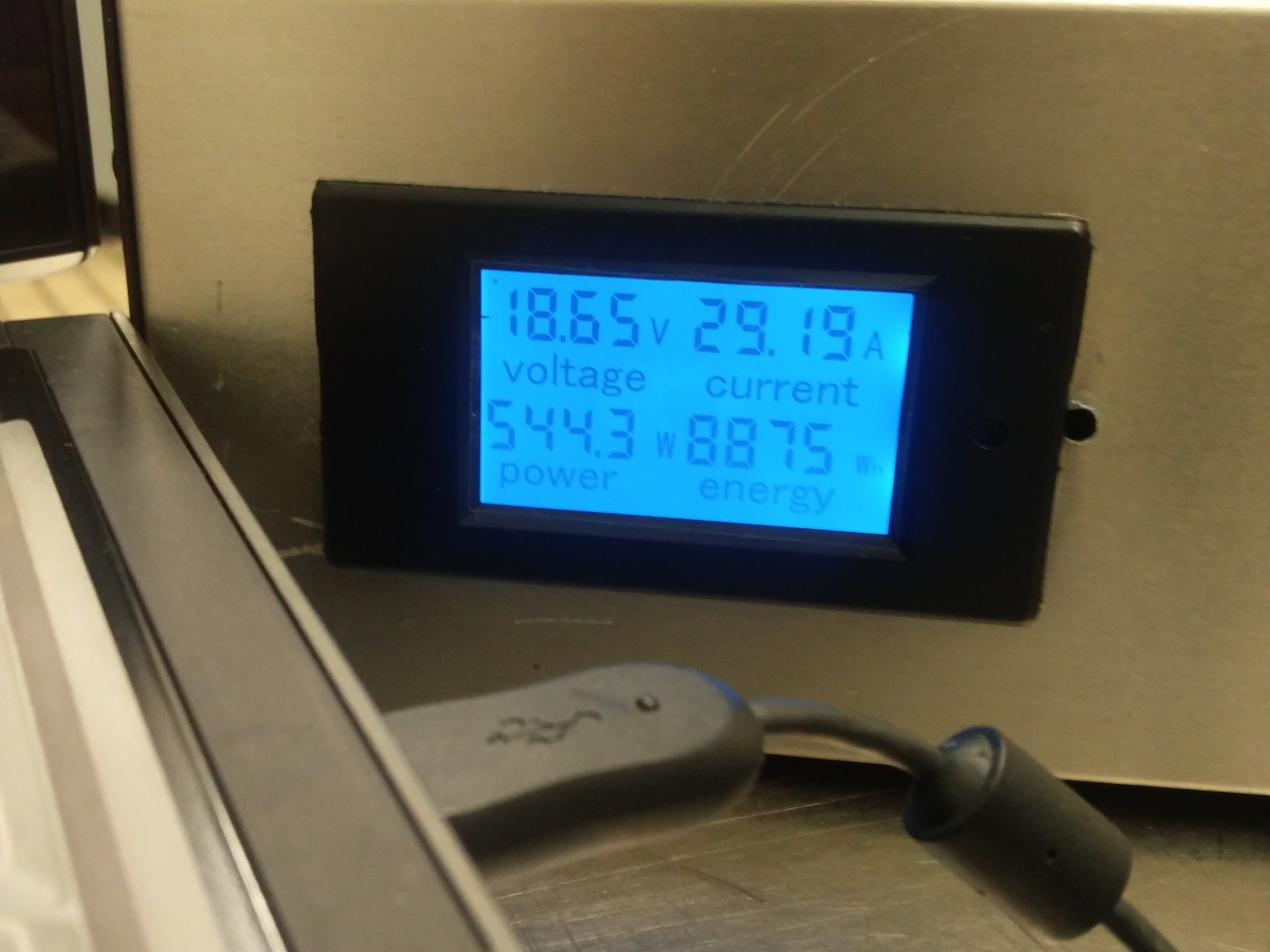

I installed this display to see what exactly is going on. It is wired after the diodes so it measures voltage, Amperage and wattage that the laptop receives, regardless the efficiency.
I have read all your posts, and I also think it is weird to have this behavior. I told you that I had the same problems, until I removed the rectifier and placed diodes. Simpler and easier method. Also, no heat!!!
