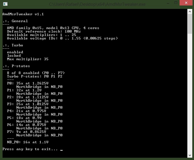

Uraz Posted June 28, 2014 Share Posted June 28, 2014 Try overclocking it. It won't overclock, but it will lock to max turbo.As for undervolting I already linked a tool that can do it. You even quoted my text with the link. Ok as for gpu overclocking, again im not familiar because I haven't done such thing before. Would you recommend MSI Afterburner? I have a R9 M290X, which is just basically an 8970M and 8650G. Is it possible to hybrid crossfire both? Since I opened GPU-Z it says crossfire available. I already have AmdMsrTweaker. Here's the SS. I'm kinda like a monkey in front of a laptop not knowing what to do with it. Trying to look for ways Quote Link to comment Share on other sites More sharing options...
