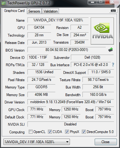

tucksha Posted August 10, 2013 Share Posted August 10, 2013 By Joe I think he's got it.... I have sucessufully managed to boot into windows normal mode. I have Onboard HD Audio OFF I have IDT DISABLED Currently using the standard VGA controller, but I am going to reboot into standard (not diagnostic) mode and try to install the Nvidia Drivers. Incidently I found that this is the only version of Phlash that works with my R2, for those that are stuck in safe mode: PHLASH16.EXE I will confirm it in a minute, but for now, I can kind of semi-confirm that my GTX 770M is fully compattible with the M17X R2 under the above settings, I will upload a GPU-z Screen soon. Thanks a lot for your help slv7, this thread has been awesome! Ash 3 Quote Link to comment Share on other sites More sharing options...

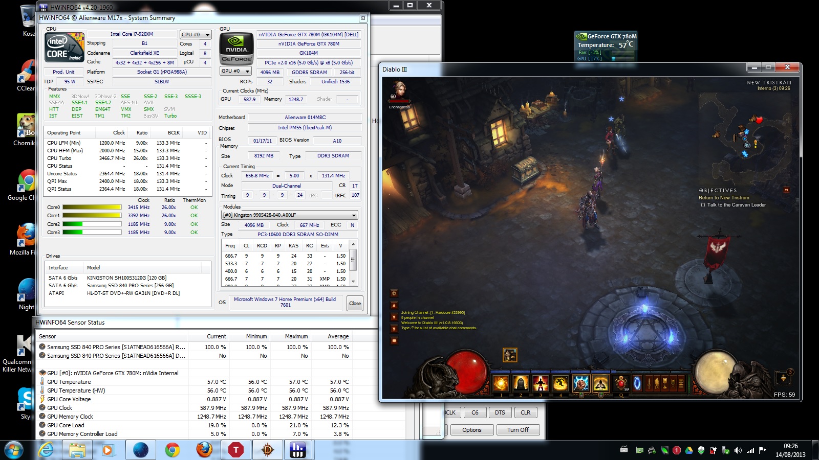

tucksha Posted August 10, 2013 Share Posted August 10, 2013 100% Confirmed working GTX 770M on Alienware M17x R2 Just done a quick WEI test, and though its by no means a benchmark, the 770M has achieved a 7.7, which is pretty darn good. Furthermore, after trying a quick game of Planetary Annihilation, my temps didn't exceed 80 degrees, thanks to the cooling mods around the web, which I think is a pretty good bonus. Just follow the above settings on my post and everything should work. A few last things, below is a copy of my current VBIOS, and a link to the driver I am using. Cant wait to see an 780M working. VBIOS: Zippyshare.com - GTX770M.ROM DRIVER: v326.29 Windows 8 64bit | NVIDIA Mobile OEM - 32x Series GeForce Driver release - LaptopVideo2Go Forums Again, thanks to slv7 for all of your great hints, tips, and software, and of course everyone else that has contributed to this thread. It's been a pleasure. Ash P.s. If anyone is interested this is the card that I bought: Nvidia GeForce GTX 770M 3GB DDR5 for clevo alienware upgrademonkey pre order | eBay 2 Quote Link to comment Share on other sites More sharing options...

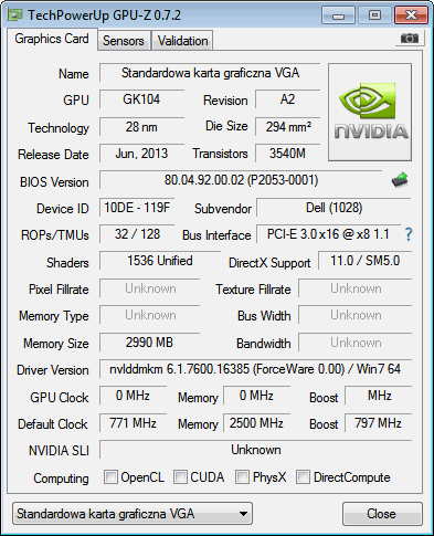

flingin Posted August 14, 2013 Author Share Posted August 14, 2013 Booted ok into normal mode but in 640x480 and then changer resolution to normal. GPU Z shows weird info look 2999mb ram on GPU ? EDIT i installed and booted into windows OK but only on EXTERNAL SCREEN - HDMI, Drivers look ok only thing i messed up is the device name Any idea why main screen is not showing anything ? MAIN SCREEN IS BLACK - NO DISPLAY ANOTHER UPDATE, can run games on external screen - have a look Can't run 3dmark as it is telling me i have an unsupported device OK AT THIS POINT - HOW TO GET MY MAIN LAPPY SCREEN TO WORK ?? Is this possible that because of the device name is wrong ? I will try to perma OFF the Driver signature enforcement, maybe it is because of this....later tonight as i am at work ... Quote Link to comment Share on other sites More sharing options...

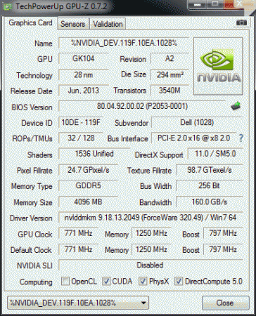

tucksha Posted August 21, 2013 Share Posted August 21, 2013 It comes to a point now where I think that it's not compatibility, and it's something to do with your card. Firstly, if it was a power draw issue, the computer would simply just switch off, if it was a clash you'd see the funky coloured screens. I can't see the gpu-z screens above, but what do they say the sub-vendor is, mine does actually say Dell, which leads me to think that it's a bios problem, if yours is flashed for a Clevo or other make would this make it incompatible with your computer? There are a few things you need to check/try now to eliminate most problems.1. Is your card actually an Nvidia GeForce GTX780M? You can tell by the size if the die, and the amount if ram chips, the card should be blue, also it 'should' have it printed on it somewhere.2. Are you running the stock VBIOS for your card, 2999Mb of ram doesn't sound right, it sounds as though its configured as a 770M or a 680M. If you're not, and you don't have it, I think [email protected] can get you it. 3. Uninstall all of your Nvidia drivers in safe mode. Or with your other GPU in.4. Reset your BIOS to default settings then set it back up.5. Get your card working plug and play first before you reinstall any drivers.It's also bugging me that you have to unplug your power supply before you can turn the machine back on after a crash, instead try just waiting a minute for the computer to shut down completely, fast power cycles are not a forte for my R2, so I think it's more of a case that it won't come on immediately, rather than at all, if it really won't come on at all after a crash, then you possibly have a power issue, I think when windows starts it performs a quick kinda POST but in a windows environment, which seems to push the frequency and voltage of everything to its max for a few seconds, which consumes a bit of power, I you are running a 100-120W GPU and a 55w Processor such as the 920XM or better, there is a small chance that you are overloading the power supply when the monitor comes on, resulting in a crash and you to have to perform a complete cold shutdown and restart. The reason that an external monitor or TV might work is that they are externally powered. But this is clutching at straws a bit, as I said before I would expect an over powered laptop to just turn off like a desktop. It's more likely though something to do with your screen explicitly, as it seems to work on an external ok, bar the freaky gpu-z screens. It sounds a bit silly, but have you tried just leaving it for five minutes, sometimes when my raid volumes are rebuilding for some reason my screen will go black, like its off, and not come back on for ages, maybee if you just leave it for a min and come back it might just come on. Something is really not right here, as you can probably guess yourself.If I had the spare cash I would buy a 780M just to see if I can get it to work, but it's a £500 card that I don't really want, and would mean that it would push my upgrade cost well into the new desktop computer price range so really not an option for me, unless laptop monkey want to send me a free one for experimental purposes ;-) haha. AFIK, I am the only person to get this working on an R2, which makes me think that my computer is a special exception to the does not work rule. If it's any help I did use a fresh windows installation to install this card, which may also point out a possible driver clash. Have little look at your hidden old drivers and delete anything that says NVidia on it.Laptop monkey will probably just send you my screens, as they are emailing me asking for proof that it works, so I'm not sure that they're telling complete truth in that they have got one to work, I think it's more one of their customers have got it to work somehow. If you're lucky you may get my crudely written instruction document from them, written by me haha.Sorry if this post is a little all over the place, I'm just racking my brains for every possible cause and solution.Best of luck when you try it again.Ash Quote Link to comment Share on other sites More sharing options...
