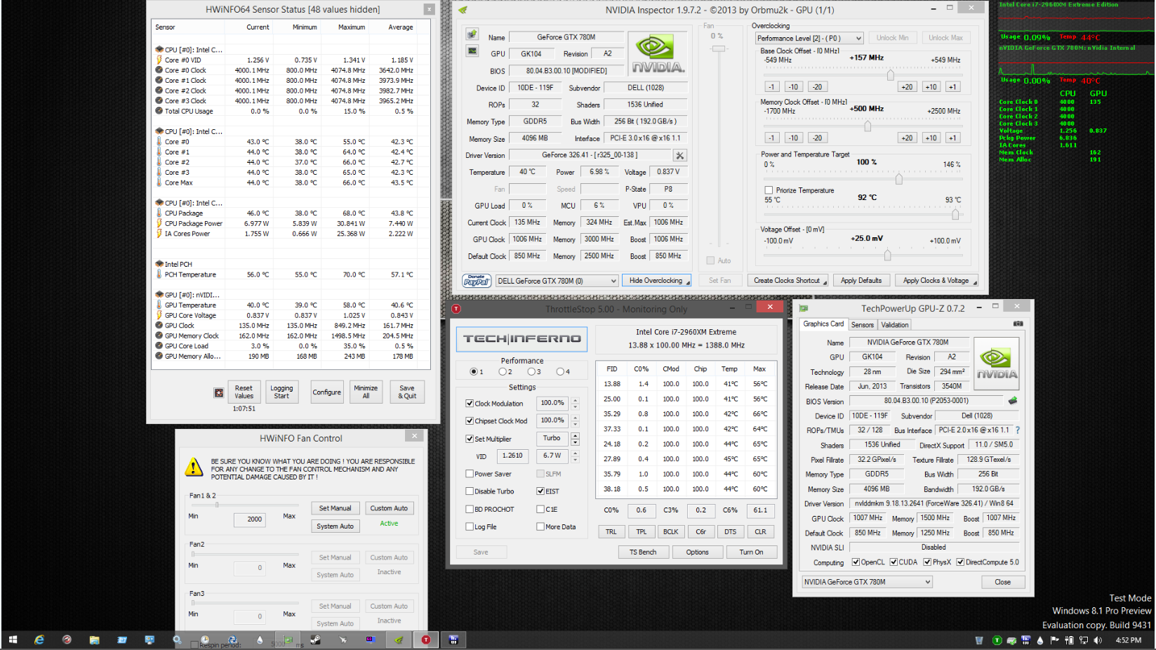

J95 Posted October 12, 2013 Share Posted October 12, 2013 Yeah with most games you don't need to OC at all....I've never ruined anything by overclocking....museum Learn about AA settings using Nvidia Inspector NVidia Anti-Aliasing Guide (updated) Quote Link to comment Share on other sites More sharing options...
link3rd Posted October 12, 2013 Share Posted October 12, 2013 Well, those temperatures seem OK. 78 degC being your highest temperature you say at stock voltage but with overclock. If you're overvolting I think you'd want it under 80 degC as a maximum temperature, so as long as your fans aren't on 100% when you saw the 78 degC, then you should be good to add a bit of voltage if you wanted.Hey, I have an interesting thopic. Maybe some people figured it out already, but I'm just putting it out there. So, to install the 780m GTX in Alienware laptops that pre-date the new 2013 lineup, we need to disable the integrated gpu right. So in the event that we're running on battery, we will not be able save as much battery life as we would if we were running the intel HD 3000/4000 right? Does it make sense to undervolt/ underclock/ whatever, while on battery in an effort to save battery life? Quote Link to comment Share on other sites More sharing options...

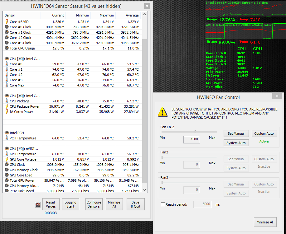

link3rd Posted October 12, 2013 Share Posted October 12, 2013 Hey, J95, in the picture that you posted above, for the HWiNFO fan control, I'm curious to know what settings you used. Can you help me pls? I dont think my cpu fans are customized nor is my gpu fan optimal. I read through a lot of this thread to get educated about it, but I cannot come to a final conclusion. HOW TO: Monitoring CPU and GPU Temperatures In-Game/In-Benchmark with On-Screen Display Quote Link to comment Share on other sites More sharing options...
J95 Posted October 12, 2013 Share Posted October 12, 2013 Aggressive fan profile, lower idle RPM. Quote Link to comment Share on other sites More sharing options...
Robbo Posted October 12, 2013 Share Posted October 12, 2013 Is fan control worth messing with for the GPU? On my M17xR3, as standard built in control, I think it switches to it's highest possible RPM at about 65degC (about 4100rpm). Or are you guys talking the CPU temperature control, because that does let the temperatures get quite high before applying maximum fan rpm? Quote Link to comment Share on other sites More sharing options...

J95 Posted October 12, 2013 Share Posted October 12, 2013 Auto start fan control edit HWiNFO64.INI add OpenFanCtrlMin=1 HWiNFO64.INI KeepTheme=0 FlushBuffers=0 OpenFanCtrlMin=1 Quote Link to comment Share on other sites More sharing options...
Robbo Posted October 12, 2013 Share Posted October 12, 2013 (I don't see why messing with GPU fan control is important if M17xR3 hits max GPU fan RPM at 65degC - that keeps temperatures plenty low enough; haha, maybe it's just mine that behaves like that!)I found out by manually setting my fans to 100% using HWInfo, that the max fan RPM for the GPU is 4100rpm. My M17xR3 switches up to this 4100rpm automatically at about 65 degC, so I don't see how a fan profile is going to lower your temperatures, because at 65 degC your GPU fan will be at 100% RPM anyway. I can't see it lowering your gaming temps, unless I'm missing something. Quote Link to comment Share on other sites More sharing options...

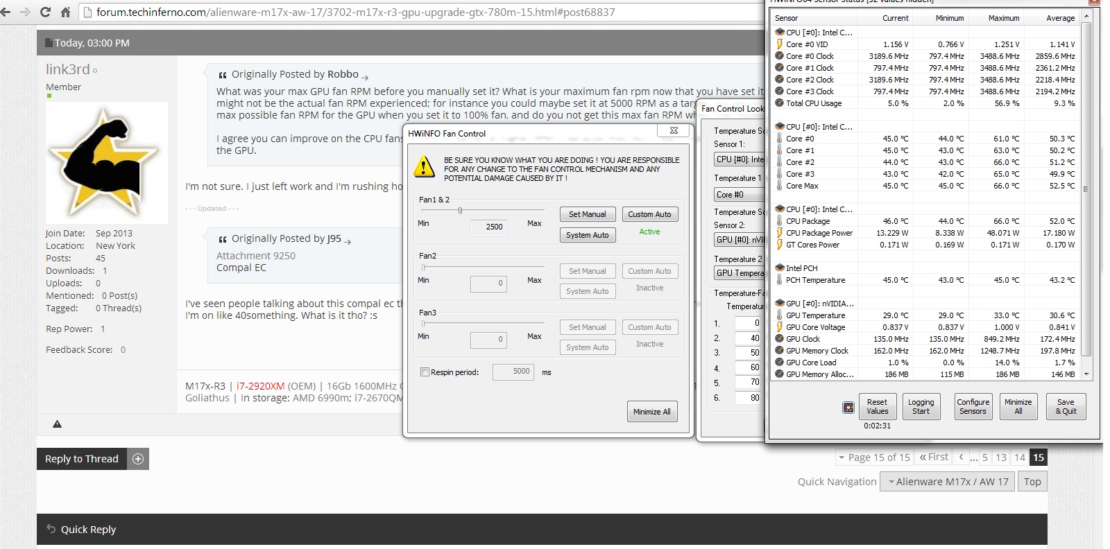

Robbo Posted October 12, 2013 Share Posted October 12, 2013 [ATTACH=CONFIG]9250[/ATTACH]Compal EC Quote Link to comment Share on other sites More sharing options...

link3rd Posted October 13, 2013 Share Posted October 13, 2013 What was your max GPU fan RPM before you manually set it? What is your maximum fan rpm now that you have set it manually? Note that the target RPM you ask of it might not be the actual fan RPM experienced; for instance you could maybe set it at 5000 RPM as a target, but would only reach 4100RPM. What I'm getting at is: what is max possible fan RPM for the GPU when you set it to 100% fan, and do you not get this max fan RPM when over 65degC? I think you do.I agree you can improve on the CPU fans to kick on earlier at higher RPM's, because they don't reach their highest RPM's until the 90 degC's, but I'm still sceptical about the GPU. Quote Link to comment Share on other sites More sharing options...

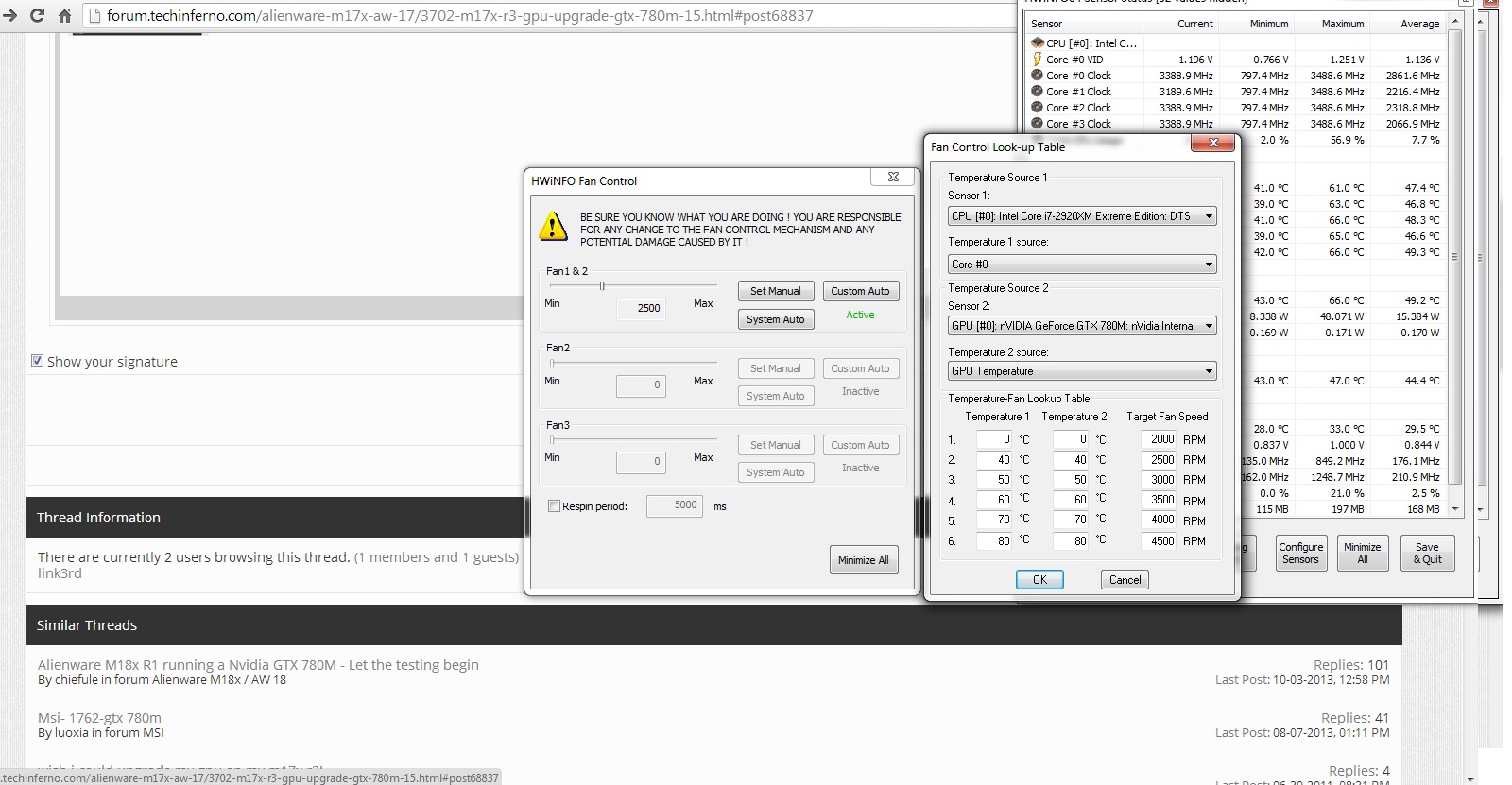

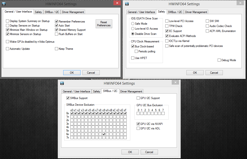

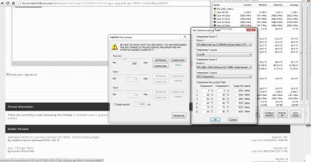

J95 Posted October 13, 2013 Share Posted October 13, 2013 [ATTACH=CONFIG]9249[/ATTACH]Wrong settings, Safety>uncheck SW SMI, set the new fan table click ok>open "custom auto" again set the fan table and hit ok, now settings will stick.Fan table http://forum.techinferno.com/alienware-m17x-aw-17/3702-m17x-r3-gpu-upgrade-gtx-780m-14.html#post68814 Quote Link to comment Share on other sites More sharing options...
link3rd Posted October 13, 2013 Share Posted October 13, 2013 [ATTACH=CONFIG]9249[/ATTACH]Wrong settings, Safety>uncheck SW SMI, set the new fan table click ok>open "custom auto" again set the fan table and hit ok, now settings will stick.Fan table http://forum.techinferno.com/alienware-m17x-aw-17/3702-m17x-r3-gpu-upgrade-gtx-780m-14.html#post68814 Quote Link to comment Share on other sites More sharing options...
J95 Posted October 13, 2013 Share Posted October 13, 2013 Right click HWiNFO>Settings>Safety>uncheck SW SMI>Hit OK>restart HWiNFO. Quote Link to comment Share on other sites More sharing options...
