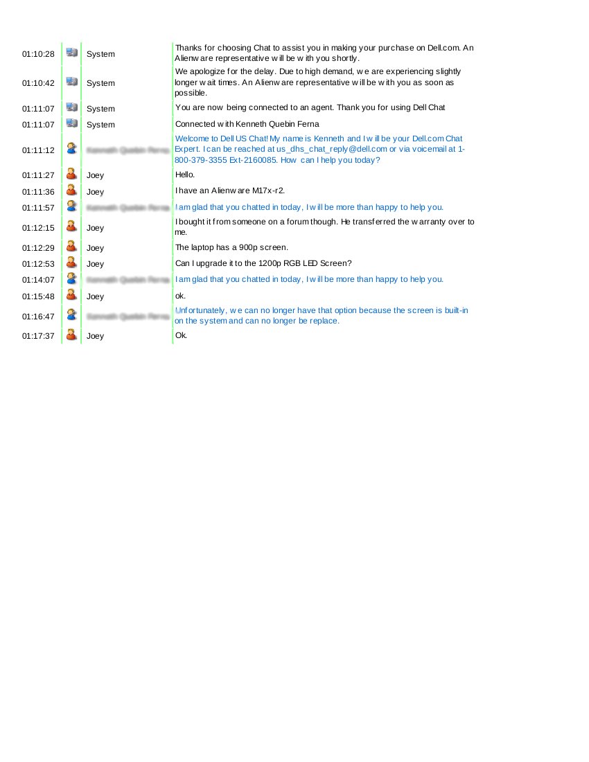

Guest bifnewman Posted May 1, 2011 Share Posted May 1, 2011 Thank you, Dell rep. This is seriously ridiculous. I just wanted to see if Dell's price has dropped since they probably want to get rid of them. Absolutely incredible that they don't know a damn thing about this. Even beyond that, the person took two minutes to make up something rather than look it up. They make the laptop, how hard could it possibly be to look it up? Quote Link to comment Share on other sites More sharing options...

Founder Brian Posted May 1, 2011 Founder Share Posted May 1, 2011 Thank you, Dell rep.[ATTACH]602[/ATTACH]This is seriously ridiculous. I just wanted to see if Dell's price has dropped since they probably want to get rid of them. Absolutely incredible that they don't know a damn thing about this. Even beyond that, the person took two minutes to make up something rather than look it up. They make the laptop, how hard could it possibly be to look it up?Although the reason he gave was stupid, Dell no longer makes the RGB LED display for the M17x-R2 since that model has been discontinued. They still have inventory for repairs but officially in North America, R2 is done as is the RGB LED. The panel is made by Samsung specifically for Dell and isn't sold by Samsung directly to consumers or other 3rd parties. Quote Link to comment Share on other sites More sharing options...
