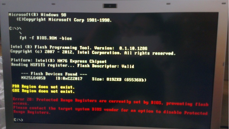

I tried flashing in Legacy mode and got this
[ATTACH=CONFIG]6048[/ATTACH]
Just follow my instructions... you didn't use my prr tool.
Okay, that's possible as well, but that would be a bigger problem. I would need access to the system in order to figure out whether I can solve this or not. If anyone (or you) is willing to let me poke around on his system with team viewer... let me know.

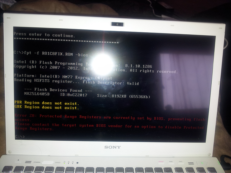

svl7, I would be willing to let you poke around on my system if I can't get it working on my own. As I mentioned before, as soon as I get 5 posts, I'll give it a shot. If it doesn't work I'll message you and give you access to do what you need to do.
Thanks again!!

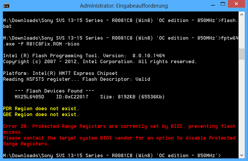

Yeah, my prr tool is useless in this case. Someone already let me take a look at his system. I think we can still flash it, I'll post here as soon as I have a solution, should be pretty soon.

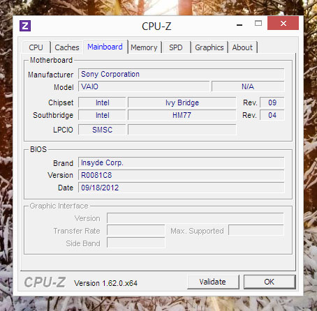

I do have a question though, how do I check the vbios number?
The only thing I could find was 80.07.4a.00.05
Thanks for all your help!
For you and the people that wants to be really sure about what bios you have, instead of using gpu-z try cpu-z. The info you need is in the ‘mainbord’ tab.
