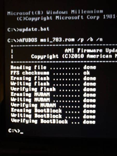

moccaa Posted October 29, 2012 Share Posted October 29, 2012 Flashed without Problems Now i have to thank xonar and check the new options and how they work 1 Quote Link to comment Share on other sites More sharing options...
