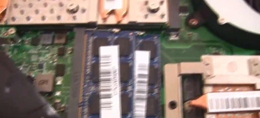

Xonar Posted May 31, 2013 Author Share Posted May 31, 2013 @stoja I can't tell from that picture. Could you zoom out? If you don't see the cable there then it is on the other side of the motherboard. @Dlob708 Do you have a MSI branded GX60 or a whitebook? If you have a bad firmware flash you need to RMA the laptop. Quote Link to comment Share on other sites More sharing options...
stoja Posted May 31, 2013 Share Posted May 31, 2013 Please help!When I started to sew their GX60 I have a black screen at the end of the firmware! After that I did not run the laptop. I've done everything according to the instructions from the MSI website. Is it possible to reset the BIOS? Sorry for my English I am from Russia. the same situation - - - Updated - - - @stoja I can't tell from that picture. Could you zoom out? If you don't see the cable there then it is on the other side of the motherboard. @Dlob708 Do you have a MSI branded GX60 or a whitebook? If you have a bad firmware flash you need to RMA the laptop. yes of course, Quote Link to comment Share on other sites More sharing options...

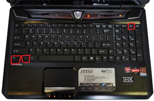

Dlob708 Posted June 1, 2013 Share Posted June 1, 2013 I restored the BIOS GX60 AC1!!! You NEED! 1.download RECOVERY BIOS(Its not original bios) http://www.mediafire.com/download/5b15mybzas3lnfb/E16FKAMS.508 2.Format flash card to FAT! 3.Place the downloaded file to a USB flash drive. 4.Insert the flash drive in usb 2.0 5.Hold the button Ctrl + Fn + PgUp 6.turn on your laptop and release the buttons and wait... 7.You will be in recovery mod 8.Select a recovery flash bios and wait finish. During the process, the computer really hot! It is necessary to cool the processor... 1 Quote Link to comment Share on other sites More sharing options...

stoja Posted June 1, 2013 Share Posted June 1, 2013 I restored the BIOS GX60 AC1!!! You NEED! 1.download RECOVERY BIOS(Its not original bios) http://www.mediafire.com/download/5b15mybzas3lnfb/E16FKAMS.508 2.Format flash card to FAT! 3.Place the downloaded file to a USB flash drive. 4.Insert the flash drive in usb 2.0 5.Hold the button Ctrl + Fn + PgUp 6.turn on your laptop and release the buttons and wait... 7.You will be in recovery mod 8.Select a recovery flash bios and wait finish. During the process, the computer really hot! It is necessary to cool the processor... i dont have luck ! Please , how do yo format to fat ? Quote Link to comment Share on other sites More sharing options...
stoja Posted June 1, 2013 Share Posted June 1, 2013 i dont have luck ! Please , how do yo format to fat ? PLEASE , can you take photo marking " Ctrl + Fn + PgUp " ? What program is used for format usb ? Quote Link to comment Share on other sites More sharing options...
Dlob708 Posted June 2, 2013 Share Posted June 2, 2013 PLEASE , can you take photo marking " Ctrl + Fn + PgUp " ? 1Turn off notebbok 2.Plug in flash drive to usb 2.0 3.plug in AC 4 HOLD BUTTON "Ctrl + Fn + PgUp" 5.press "power button" and release the "Ctrl + Fn + PgUp" 6.Wait recovery mode What program is used for format usb ? In standart format WINDOWS. I use W8. Good luck! 1 Quote Link to comment Share on other sites More sharing options...
stoja Posted June 2, 2013 Share Posted June 2, 2013 1Turn off notebbok2.Plug in flash drive to usb 2.0 3.plug in AC 4 HOLD BUTTON "Ctrl + Fn + PgUp" [ATTACH=CONFIG]7751[/ATTACH] 5.press "power button" and release the "Ctrl + Fn + PgUp" 6.Wait recovery mode In standart format WINDOWS. I use W8. Good luck! Dlob708 , thanks for all your answers and help. Fuck fuck fuck , i dont have luck. It had to break some internal component Tomorrow i send to MSI for repair , and wait minimum 3 weeks . Again, I really appreciate your help and the photo Quote Link to comment Share on other sites More sharing options...
