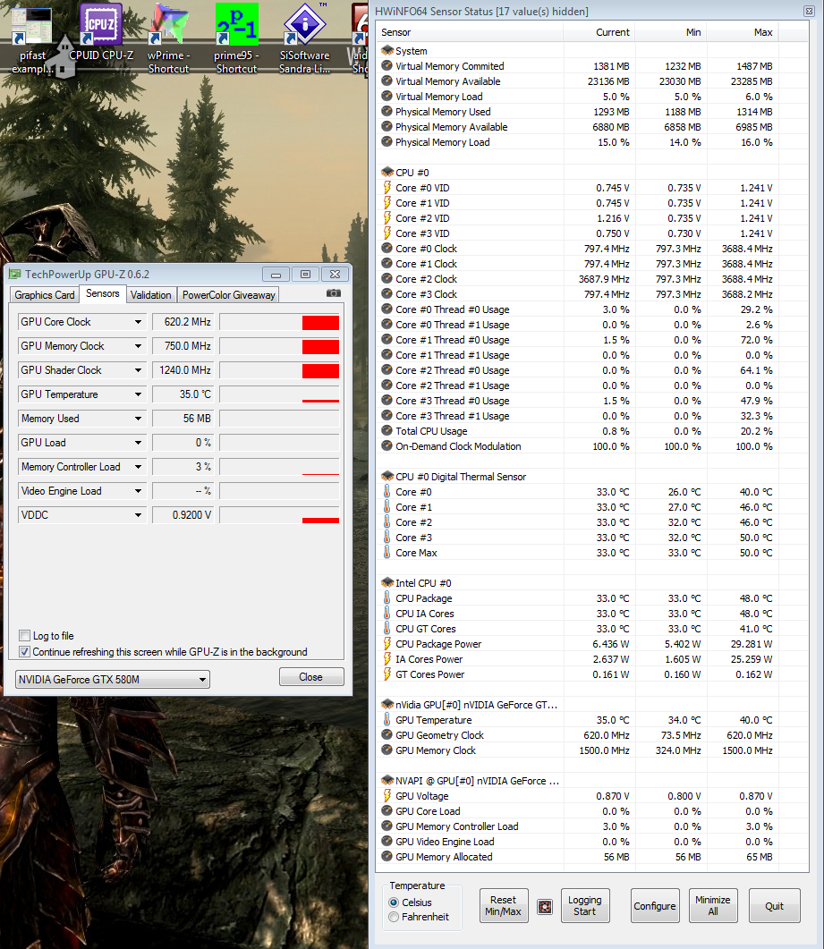

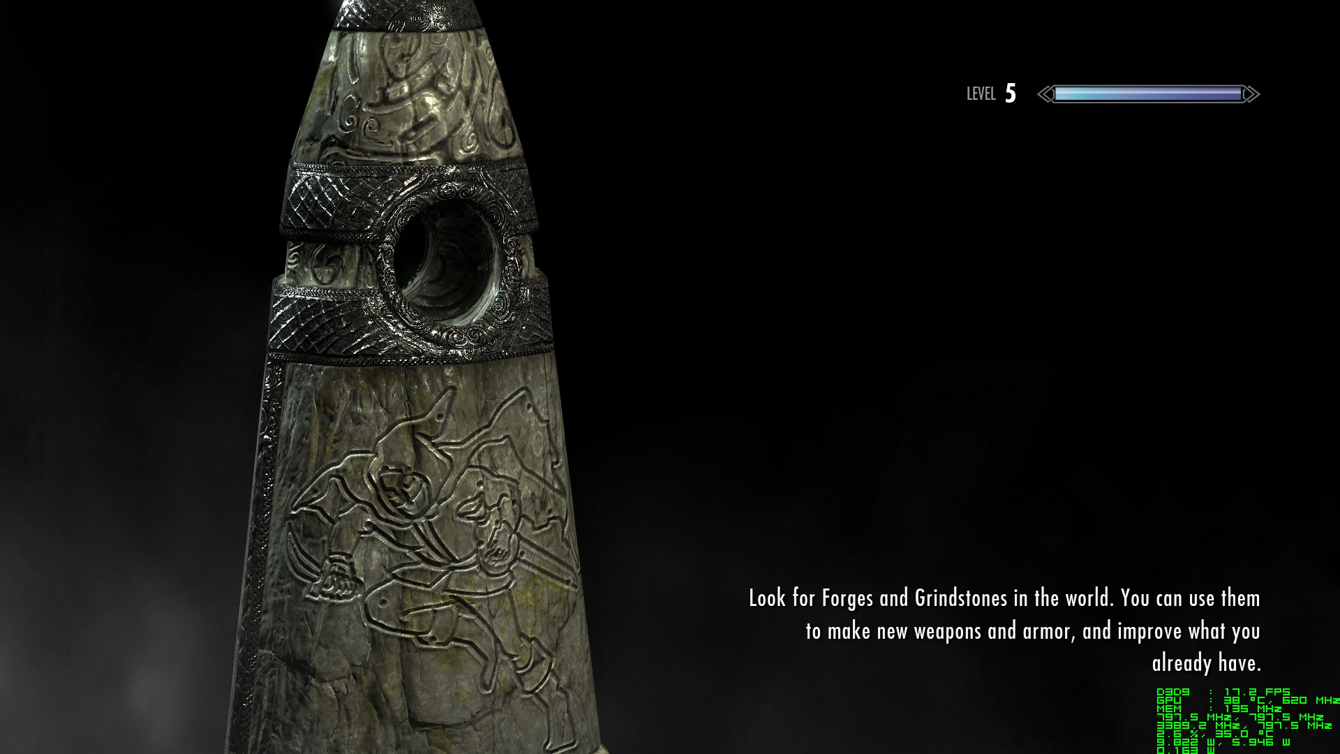

see the following the system didn't shutdown on the 1866 now... for now but look what happens?
my 580m is now running the ram ultra low? is this a driver issue or ram or video card? its only when I am in the 1866 and i'm not sure if its everytime
is this a glitch in gpuz? i'm on the .87v vbios with P1 and P0 matched?
post-34-14494993222504_thumb.png hwinfo shows .87v and gpuz .92v

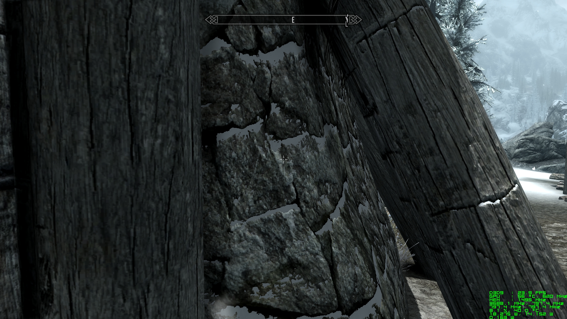

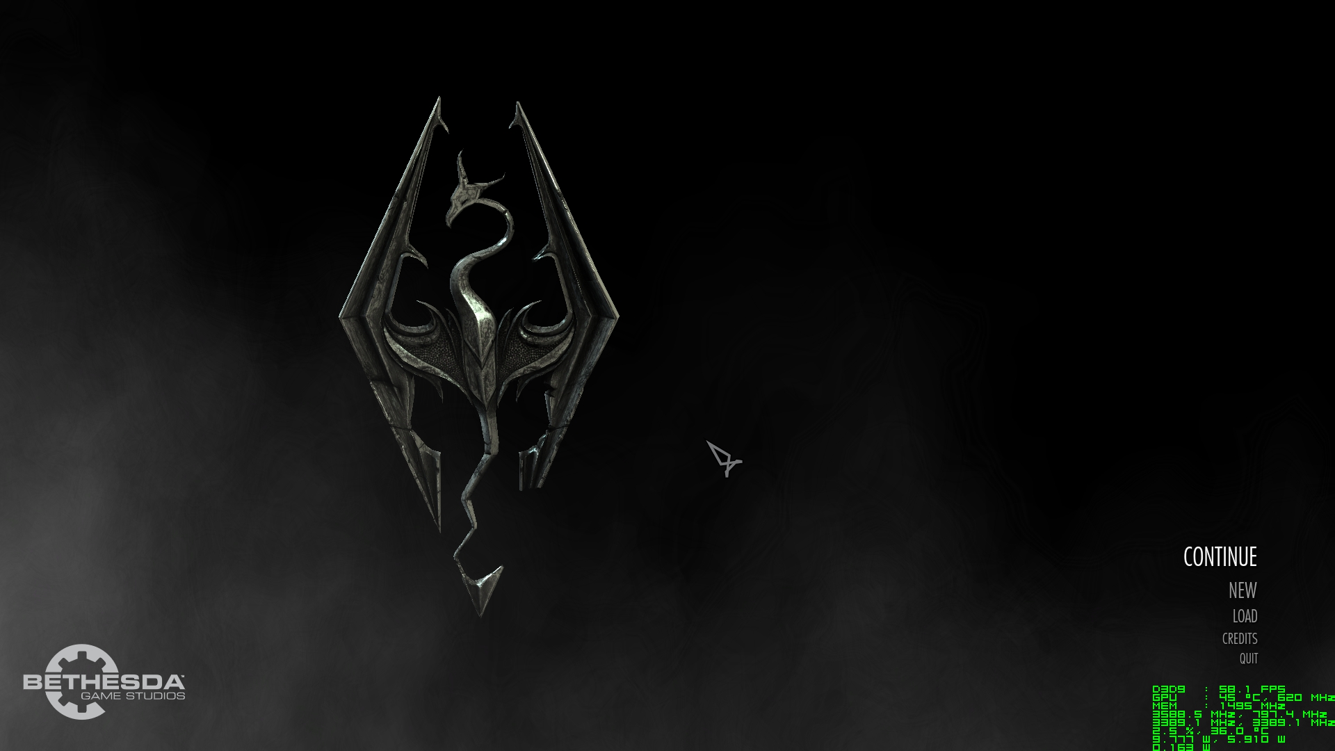

hmmm still have the low mem clocks once i enter a game and if you look at HWinfo on desktop i am locked at 3d clocks not sure why but again if i enter the game i have like 100-300mhz on the vram?
Edited by mw86

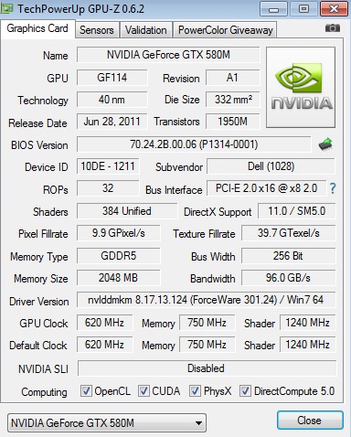

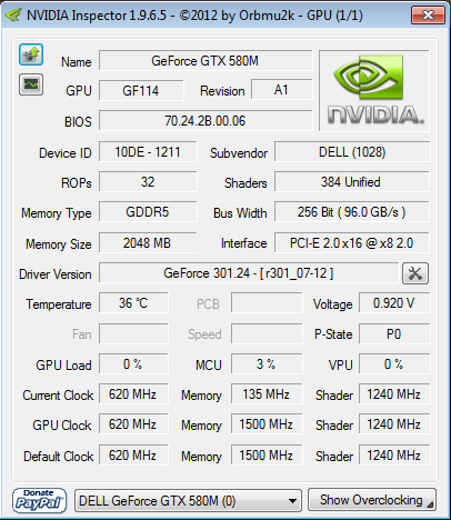

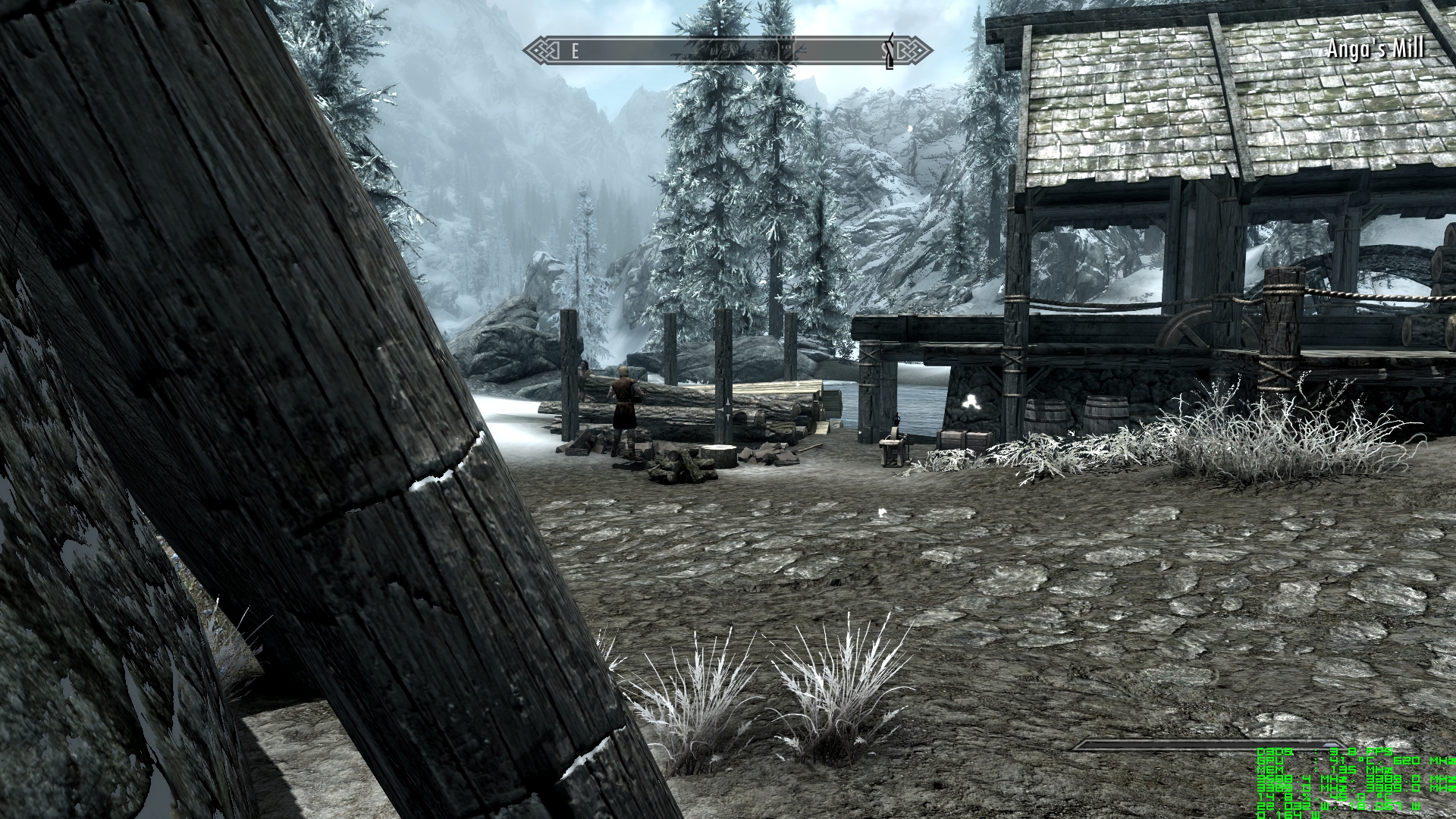

here single 580m and set 1333mhz on ram and gpu mem and clocks are fine. @Jimbo @widezu69 @GeoCake any of you run into any of the above scenarios before out of the above posts on 580m and or using 1866 ram?
here is the pics of it working correct when at 1333mhz ram
