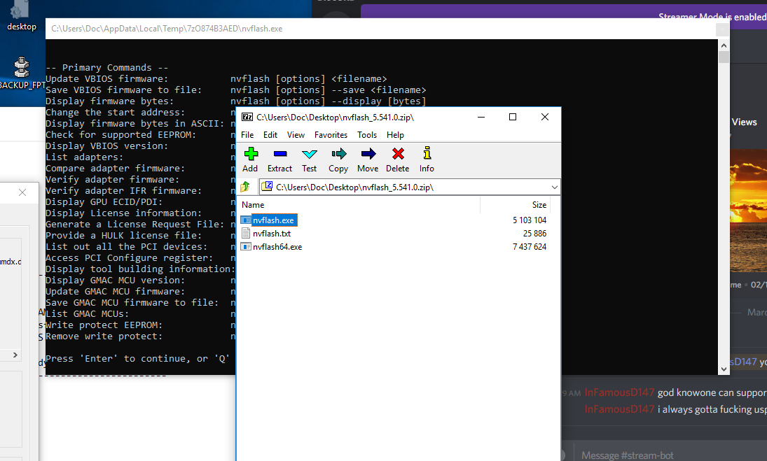

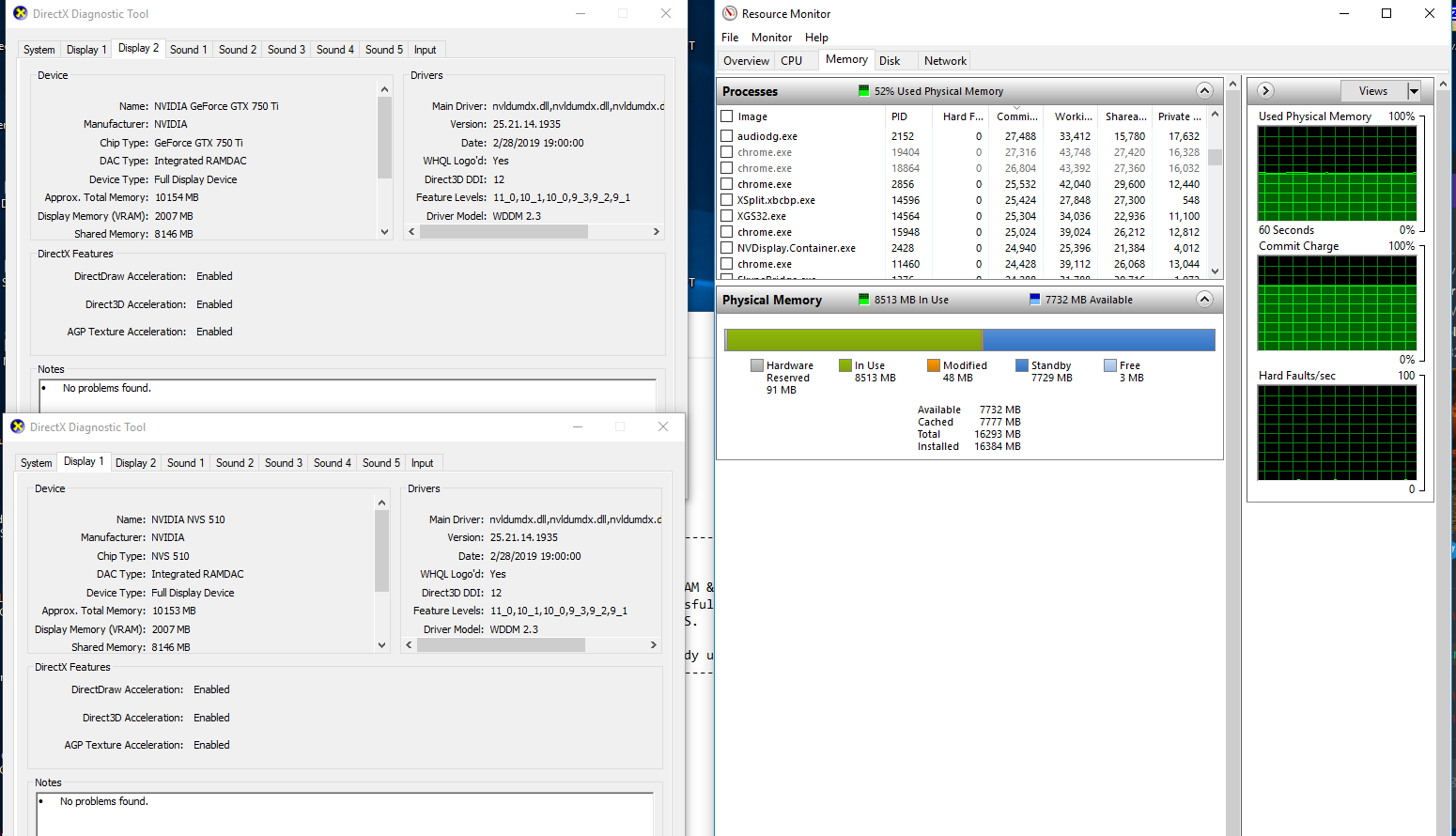

dont forget even if you have a egpu you still need to make sure the bandwith mhz dont bottleneck with your ddr4 im assuming so if you clocking 2334 x4 @ 8gb sticks 32 @ that CLK needs to be 256k so make sure if your going to do dual graphics be it external or internal the drivers must be a different ark. take a look at the screen shot I have look here https://www.pcgamer.com/dealing-with-memory-leaks/
