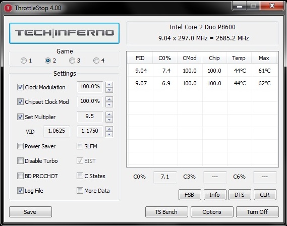

mw86 Posted February 16, 2012 Share Posted February 16, 2012 Can you post a screenshot of what Throttle Stop looks like for you? If EIST and Cstates are not greyed out and checked you can uncheck them so they are both off... If you can do that it wont matter that you dont have those options available in the bios Link to comment Share on other sites More sharing options...
he_iz_legend Posted February 16, 2012 Author Share Posted February 16, 2012 Can you post a screenshot of what Throttle Stop looks like for you? If EIST and Cstates are not greyed out and checked you can uncheck them so they are both off... If you can do that it wont matter that you dont have those options available in the bios Here it is, I can check/uncheck C States, but EIST is greyed out. Link to comment Share on other sites More sharing options...
mw86 Posted February 16, 2012 Share Posted February 16, 2012 yeah that sucks we need both to be uncheckable because one step is have both unchecked... And hit dual ida and i think recheck eist sorry bro i see it says higher than a stock cpu of your model you should see 2.4ghz at 9 multi and 2.53ghz at 9.5 so you have your baseclock overclocked perhaps via bios or some boost function of the R1? Either way thats cool in its self Link to comment Share on other sites More sharing options...
he_iz_legend Posted February 16, 2012 Author Share Posted February 16, 2012 yeah that sucks we need both to be uncheckable because one step is have both unchecked... And hit dual ida and i think recheck eist sorry bro i see it says higher than a stock cpu of your model you should see 2.4ghz at 9 multi and 2.53ghz at 9.5 so you have your baseclock overclocked perhaps via bios or some boost function of the R1? Either way thats cool in its self Yeah i have my CPU and GPU overclocked ATM. Link to comment Share on other sites More sharing options...

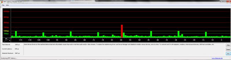

he_iz_legend Posted February 19, 2012 Author Share Posted February 19, 2012 Here is a screenshot of my DPC latency checker, that red bar is the first time I've ever seen it, i was running an installation. Is that a problem? Are the other latency's normal or is there something? Link to comment Share on other sites More sharing options...
mw86 Posted February 21, 2012 Share Posted February 21, 2012 (edited) @Brian k Is more knowleged on the R1... but i beleive any red at all is a sign of the latency issue and seems it could be the cause of the fps drop. But best hear from an expert on this its probably a driver of some hardware either gpu or even sound card and wifi can cause these. Edited February 21, 2012 by mw86 Link to comment Share on other sites More sharing options...
Founder Michael Posted February 24, 2012 Founder Share Posted February 24, 2012 The graph looks fine. Some actions (press eject button for example) will trigger a dpc red bar. In a problematic system most of the bars would appear yellow/red. Since the dpc in that model is caused by nvidia drivers I would Try to run a furmark bench and watch dpc. Sent from my GT-N7000 using Tapatalk 1 Link to comment Share on other sites More sharing options...
