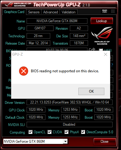

Klem here is the wall I am hitting with getting my stock vBIOS saved. SOrry this took me so long to respond to. I know there is a Prema vBIOS already made for this laptop but for the life of me I cannot find a working link to it anywhere.
The VBIOS on Asus laptops is not on the GPU itself but in the MB BIOS that's why it doesn't work, you need to extract it using MMTOOL.

  • Bios Modder
This is not true. In this laptop discrete Nvidia graphics card, and its videobios separately from the main system BIOS.
  • Moderator
Ah my bad :)
