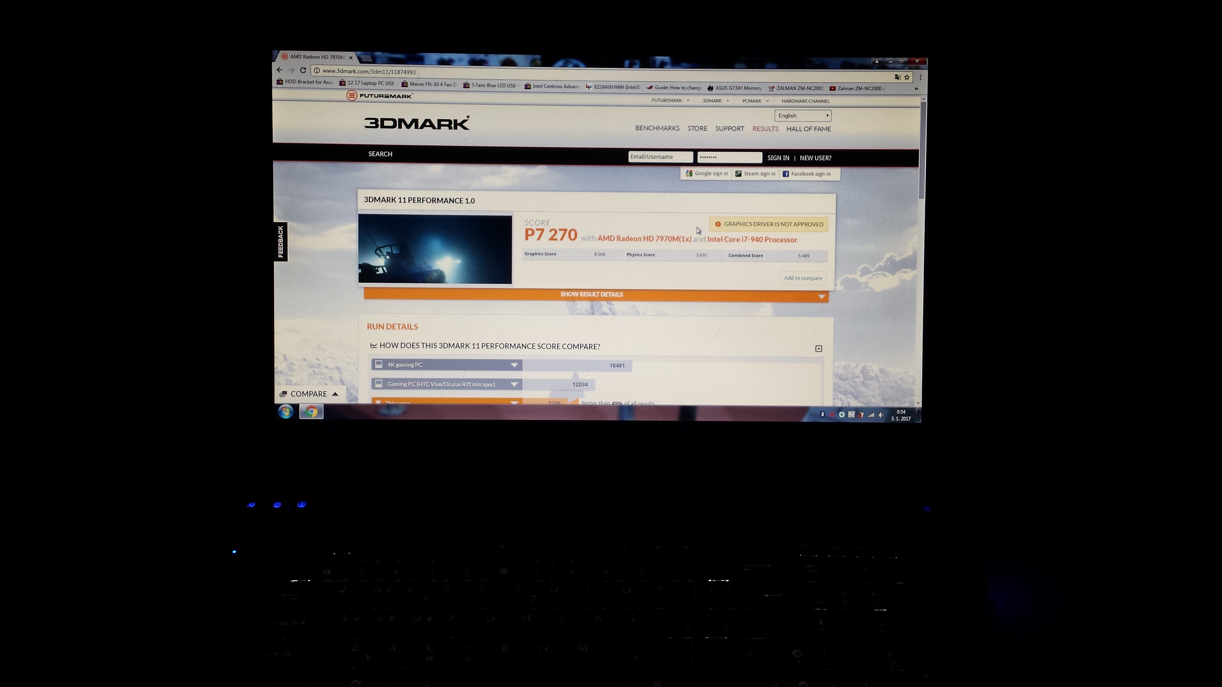

Some News !
I received the DELL 330W power adapter and I manage to "convert" it to G73jh jack.
It work well but didnt solve anything...
BUT ! I flash another vBIOS, a Clevo one (enduro disabled) and now the GPU run at max frequency !
So for the GPU part, its all working well..
Still have problem with CPU, my PC still instant shut down if I go after 70W tdp (while executing prime95)

So... My 920XM do not want to eat that much power ! Or maybe may MB do not want to feed it.. That would be strange since the 7970m work just fine. I am even able to overclock it (975/1400 from 850/1200, stable 1H FurMark (95° top temp)).
