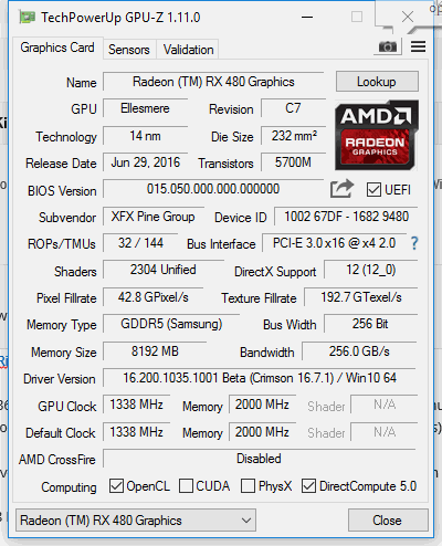

I manage to get it work on Windows 10 now thanks to Tech Inferno Fan and FricoRico  for advice :)
It because of PCI Express Slot power draw. I use Highpoint RocketStor 6361A that have 2 molex, first one main x16 board and second one x4 Thunderbolt board.
First setup I use 1 Rail to connect both ( I saw this setup before with GeForce ) it give me system shutdown after login Windows (if driver works)
Then after some advice about power, I put one rail per board. This give me stability to boot. Anyway with x16 riser (no molex) system crash half way thru benchmark, with direct x16 connect everything work fine.
My Rx480 is XFX GTR RX480 Black Edition a bit heavy overclock with 1338 MHz GPU Clock. Only Crimson 16.7.1 work for me, other one give me troubles.
