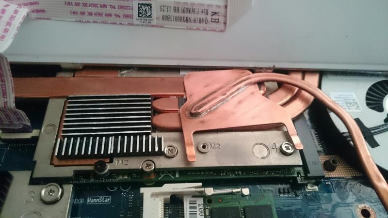

DellThinkpad Posted April 24, 2017 Share Posted April 24, 2017 (edited) Your heatsink is the same like mine, I just did some modification. Take a closer look Yes, I have installed modded drivers a few times before but I never tried a different driver with the 880m yet. And it's not like I 'want' to buy the 870m but if I don't get this piece of crap to work then I have to look for something different. Don't really wanna go back to the 770m. A maxwell-chip would be jackpot but they are hard to find or just overpriced. 10 hours ago, szumial said: the m6800 might be the last one to play with as we do now... I feel you man. There are still good models out there but the trend to solder everything for 0,000134mm thinner laptop is undeniable. I'm afraid I have to get one of those ugly 'gaming' laptops in the future xD Edit: What's the white flex cable at the bottom that goes below the EC-slot? I don't have that one^^ SC-card option? Edited April 24, 2017 by DellThinkpad Quote Link to comment Share on other sites More sharing options...
szumial Posted April 24, 2017 Author Share Posted April 24, 2017 Right! So you've added something more to the heatsink. Where does this new line go? I'm impressed it fits the laptop The picture is not actually mine (I was too lazy to open the palmrest) so I am not sure what the purpose of that white cable is, but I have it in mine m6700 and it is also not connected, but seems protected with a seal from the bottom side. I'll check it out when I get home from work (yes, I am planning to open the laptop again today - there's something wrong with my mSATA slot at the moment) and let you know what I've found out. Not that I don't fancy having a thiner laptop, but being able to modify parts and customize it's performance is something that appeals to me more. These gaming laptops are good enough, though I wish they didn't make them look as supercars... As for the drivers, BIOS and vBIOS: - Have you checked whether your GPU comes from an Alienware or Clevo laptop? I believe there might be some compatibility issues between vendors, so flashing a different vBIOS might be a way to go... And it's easy too. - You can download the latest nVidia drivers for GTX880m from their website and try what I did: add 880m to the INF file and replace all Alienware 880m codes with m6700 ones (for example 05AA --> 153F, 05AB --> 153F). I don't really know why, but in my case I had to replace all Alienware codes and only then the drivers installed properly... Let me know if you managed to sort this out Quote Link to comment Share on other sites More sharing options...
DellThinkpad Posted April 27, 2017 Share Posted April 27, 2017 (edited) It doesn't really fit yet I just added it for testing. My GPU already has a Dell BIOS. I managed to install my drivers but I'll give it another shot with a different version. I still can't download files from download section Edited April 27, 2017 by DellThinkpad Quote Link to comment Share on other sites More sharing options...
