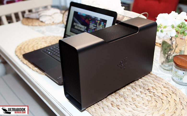

Design and exterior
The overall design of the Razer Core is absolutely perfect.  The look is completely professional and could easily blend in with any desk setup.  The all aluminum construction really makes it look a high quality product that will likely last a long time.  Even with the lighting, I would certainly feel comfortable having this on my desk.
What’s most appealing is the size.  Compared to my current desktop, this thing is so tiny, but it’s still a little larger than I was expecting.  Rest assured though, all that space is necessary for the internal cooling fans, power-source, IO output and wiring.  It seems like Razer put an excessive amount of fans in this thing, but I’d rather be safe than sorry.
The top of the unit has a large passive vent.  On the underside is another vent, with three cooling fans to circulate the air up to the card.  The front has what looks like a vent grate, but it’s actually just for show.  At the bottom portion of the front there’s a light which can illuminate to any color of your choosing or can be switched off.
On the right side of the unit there’s an embossed Razer logo, centered on the face.  On the left side there’s the main vent that the GPU fans will blow through.  When lit up, you can see your GPU with Razer’s chroma lighting color of your choice.  It actually looks pretty cool when lit up.  Of course yours would look differently than mine, depending on what GPU you put inside. On the back, you’ll find 4 USB 3.0 ports, a Thunderbolt 3 input, an Ethernet port and a power socket.  There’s also what appears to be the PSU vent.
A single handle holds the internals in and if you lift it 90 degrees, everything pulls right out.  There are no screws at all, with the exception of the single screw that will hold the GPU in place.  I was a little skeptical of the locking mechanism, but it’s actually pretty solid.
I think many will probably want to put the Core on the right side of their desk to enjoy the lighting.  Stealth owners may not have a choice though, since the Thunderbolt 3 cord provided with the Core is extremely short, a mere 18 inches long.  Apparently making the cord longer would cause problems with performance and you would need a more expensive “active” cable.  Your options with a cord this short are extremely limited.
So with the Razer Blade Stealth’s Thunderbolt 3 port being on the left side, you’d have to have the Core on your left, which puts the lighting out of sight.  The other option is to turn the laptop to its side and put it on the right, but the screen would not be facing you.  For me it wouldn’t matter, because I don’t plan on ever using the laptop’s screen with the Core.  Plan accordingly.
Razer Blade(14”) users will have their Thunderbolt connection on the right side, so it will be a little easier.  But keep in mind that the Core does not charge the Razer Blade, only the Razer Blade Stealth.  So you’ll have to hook up your power adapter to the Razer Blade as well, which is on the left side of the laptop.  That means wires on both sides – bummer.  For me, it’s still kind of a mess because the laptop is now where my mouse was.  My quick fix is to put my mousepad on top of the Blade.
These are small things to complain about, considering what’s being done.  In all retrospect, the setup is a lot cleaner than the DIY external graphics enclosures I’ve seen in the past and overall, I’m really pleased with the Core’s design and ergonomics, even with the small sacrifices that had to be made to make it work.

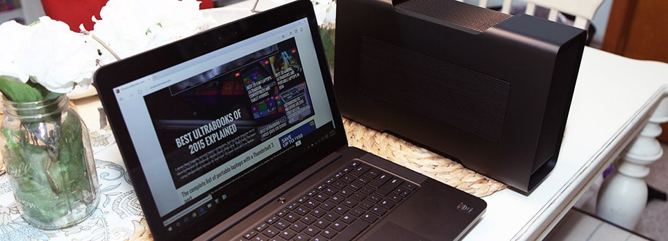

Setup
Installing the graphics card was just as easy, if not easier, than installing it on a desktop.  The card goes right into the slot and all it takes is one screw to hold it in place.  Then you attach your PCI-e power connectors. Then you just slide the card into the enclosure and fold the handle bar to lock it in.  It’s as simple as that.  For my testing, I used a MSI GTX 970(and later the 1070) graphics card.
Things get a little more complicated after that and I ran into some issues that I can’t recreate, since I now have everything up and running.  Being a Core owner, Razer emailed me some directions on what to install.  I downloaded and installed the software required, but the instructions weren’t very clear on the order I was supposed to install everything in. So all I can do is tell you what I did, what problems I ran into and how I fixed them.  Hopefully it will go better for you.
The first thing I was supposed to install was an updated version of Razer Synapse, which is compatible with the Core.  I already own a Razer Blade though, so this was already installed.
The next thing to install is the Razer GPU Switcher Beta Tool.  This opens a little program that switches the GPU either automatically or manually, depending on your preference.  The launcher icon is in your quick launch toolbar, but it does nothing without the Core attached.
The last piece of software to install is Nvidia’s desktop graphics drivers.  The instructions indicate that these should be installed with the Core plugged in, but this is where I ran into problems.  When I plugged the Core in, it would lock up ALL my inputs, including the keyboard, mouse and touch.  So there was no way to install the drivers!
I did a hard reset and installed the drivers without the Core attached.  They installed fine and I rebooted.  I tried attaching the Core and this time the Razer GPU switcher popped up with an option for me to switch to the GTX 970 I installed.  Yay!…wait.  My inputs were all locked up again.  So I couldn’t even select the option to get it to work.
I tried it over and over again with the same results.  The ONLY thing that worked was when I booted the laptop with the Core attached – then everything mysteriously started working correctly.  Synapse then prompted me for an update and then the Core was recognized by Synapse.  Somewhere in the mess, Intel’s driver popped up and notified me that the Core was attached to Thunderbolt 3 – I can’t remember when exactly that happened.
So after it finally worked, I was able to set it up for multi-monitor support.  Instead of 3 screens, I chose to turn off the Razer Blade’s display and operate with it closed.  The short Thunderbolt cord really makes your options limited on where to put your laptop, so again, be prepared for that.
My GPU successfully outputted to my dual QNIX 2560 x 1440 px monitors, which are dual-link DVI only.  Prior to this, I have never been able to connect these displays to a laptop, so this was kind of exciting for me.  The default refresh rate was set to 60Hz but I’m able to set custom resolutions with higher refresh rates.  Unfortunately, it doesn’t work some of the time though and it goes back to 60Hz.  I haven’t yet pinpointed why this happens, but rest assured I plan to find out.
One other thing I’ll mention concerns those who want to operate with the laptop’s lid closed, like me.  There are only two ways to do this so far.  The first is to disable sleep mode when you close your lid.  Then you can turn it on and flip the lid closed.  I happen to rely on sleep mode when closing my lid, so I chose not to use this option and leave this feature on.
However, if you choose to leave sleep mode on when closing the lid, attaching the Core will not wake the laptop from sleep.  And closing the lid obviously puts the laptop to sleep.  Unfortunately, the Core is powered off while the laptop is off or in sleep, so none of your attached devices will wake the laptop.  So the only other option I have gotten to work so far is to use my USB mouse I have attached directly to the Razer Blade, to wake the laptop from sleep.  As soon as I find a way to wake the laptop from sleep by attaching the Thunderbolt cable, I’ll be sure to update this as well.

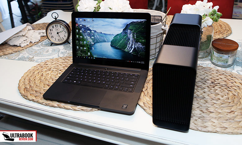

Support for non-Razer Laptops
The Razer Core is specifically designed for the Razer Blade and Razer Blade Stealth.  Even Razer’s CEO mentioned that it would not be plug and play for non-Razer laptops.  But he did say that they weren’t closing the door on the option and the software was going to be open source.
Of course I’m going to give it a try though – it’s what I do.  The whole point of me getting this thing was to eliminate my desktop and my wife doesn’t (and won’t ever) use a Razer laptop.  So I went ahead and installed all the software on her Dell XPS 15.  Let’s just say for now that I got mixed results.
First off, I have no idea what actually made it work right off the bat, but it did.  I installed the GPU switcher, Razer Synapse and then installed the desktop GPU drivers.  Then I connected the Razer Core and I immediately got multi-monitor support.  That wasn’t even that easy for my Razer Blade…  but it didn’t last.
Once I unplugged it, the XPS 15 locked up with a blank screen.  Every attempt after that resulted in either a BSOD with an error with nvlddmkm.sys or a complete input hang, where the mouse and touchscreen would stop working.  I tried booting with it attached, but it would just hang at the log in screen and I couldn’t do a thing.
Currently, the only way I’ve been able to get it to work is by going into the Device manager and manually disabling the mobile GTX 960M inside the laptop.  Once I did that and connected the Core, it works… sort of.  I’m able to get the GPU to display on my monitors, but I still don’t have interface with all the USB devices attached to the Core.  Also, Razer Synapse doesn’t recognize the Core, so there’s definitely something up.  To make it worse, unplugging the Core causes the laptop to sit at a blank screen indefinitely unless you reboot.
Needless to say, the support for non-Razer laptops isn’t there.  But the capability certainly exists and I’ll be continuing to mess around and try to get things working.  I think there’s a possibility that laptops without a discrete GPU will fare better, but I don’t have one to test.  Doug is also getting a Core soon and will test it on his XPS 13, so hopefully he’ll chime in with his progress soon.
UPDATE 5/31: I’ve done some extensive testing with the XPS 15 and I can’t seem to get it to work properly.  It outputs to both monitors and I can verify that the graphics card is driving them.  But what I can’t figure out is why the performance is choking so bad.  As you can clearly see in my benchmarks above, the performance with the XPS 15 and the Core is almost equal to the performance with the 960M.  There’s definitely some firmware or driver changes that have to be made to get this thing working properly.  I’ll be working on it some more, but I don’t think this thing is ready for Non-Razer laptops without some major tweaking.
UPDATE 6/2/16:  As you can see from the lined out mess above, I had some challenges getting the XPS 15 to work properly.  Long story short, there are some Thunderbolt drivers and firmware that must be installed in order for things to work properly.  I actually figured all this out after a fresh install and I ended up getting things running rather quickly, the second time around.  Here’s what I did.
First things first, make sure ALL your Dell drivers are installed and up to date.  This especially includes the Thunderbolt driver and the Thunderbolt updated firmware.  I think the updated firmware was the bigger part of my problem before.  Also make sure the 960M is fully updated, but before you do sso, uninstall the old driver and completely delete it.  This is important because when the GPU switcher disables the 960m, it will randomly try to reload the old driver which isn’t compatible with the Core.  It took me forever to learn about this…
Next, install Razer Synapse.  This will not be up to date right away, but it will automatically update once it detects the Core. Once that happens, you might also be prompted to accept the Core for Thunderbolt.  Do so and Things will start to happen on their own.
The last thing you’ll need to do is install the desktop graphics driver provided by Razer(I had Nvidia).  It will then detect your desktop GPU and everything should shift to those monitors once it does so.  If it doesn’t, manually disable the 960M in device manager and things should start to pick up.  Note that if things lock up for whatever reason try this again with the 960M disabled from the beginning.
Update 7/4: {You’ll also want to make sure you’re on bios version 1.1.19.  The latest is bios 1.2 but has been found to be a little more buggy in regards to GPU performance.  Credit goes to Doug for finding this out.}
You can also use the GPU switcher at this point, which works ok but is still kind of buggy.  I’ve noticed it likes to keep my 960M disabled if I shut down while plugged into the Core.  It’s not perfect yet but it’s a good start.
So if you’re caught up with me now, you’re able to output to both monitors and all your peripherals Attached to your Core are working ok.  I am able to connect and disconnect pretty much the same as the Razer Blade now, which is great.
I took some benchmarks and put them into the table above.  As you can see, it’s not quite as powerful as the Razer Blade and the Core but it’s really close.  This is most likely due to the i5-6300HQ processor and 8GB ram configuration I have.  Still, this might be something that will swing you in one direction or the other, if you’re having trouble deciding between the Razer Blade and the XPS 15.
I did notice that the fan noise was a little louder than the Razer Blade.  I definitely heard it when the temps started to rise, whereas with the Razer Blade, I could not hear the fans at all.  It’s not terrible, but something I wanted to note.
So there you have it folks, a non-Razer laptop working pretty decently on the Razer Core.  Sometimes I still have trouble getting the Core to load properly when plugging it into the XPS 15, but I think I figured out a routine to get it to work on a regular basis. The key component is making sure the 960M is disabled.  Booting with the Core plugged in works about 50% of the time and I can’t find out why it doesn’t yet.  I’ll be sure to keep you guys updated if I run into any bugs or anything.  But if this section stays as it is, assume no news is good news.
Update 6/21: {After a couple more weeks of on and off use, I’ve come to a happy medium with the XPS 15.  It still gives me trouble occasionally but a reboot and a second try usually does the trick.  I do notice that Chrome doesn’t perform as well, which I find very strange.  It’s tolerable but seems sluggish.}
Update 7/4{: Doug and I have been collaborating since he also now has a Razer Core.  He has been using it with an i7 version of the XPS 15 and a GTX 970.  He did a lot of trial and error with different bios versions and found that version 1.19 was the most stable.  I’ve been on 1.2, which has been somewhat stable but, as I mentioned before, I sometimes had to reboot because of sluggish performance.  Version 1.1.19 seems to be a lot more stable in terms of performance.
We still both have different experiences, even though our firmware versions are practically the same.  I can’t boot 100% of the time with the Core attached for some reason, but Doug can.  But I can wake my computer from sleep and he can’t.  He also sometimes has disconnect problems but I haven”t experienced any yet.  Chrome for both of us is still a little sluggish but Edge works just fine.  So there’s still some bugs to work out with the XPS 15.}
As for other laptops, I gave the Alienware 17 a try but I didn’t get it to connect.  After a little research, I think Dell needs to update the firmware on the Thunderbolt 3 hardware.  The AW 17 doesn’t even have any firmware on their support page, so I’m assuming it’s out of date for the specs the Core needs to operate properly.  The XPS 15 had multiple firmware updates for their Dell dock, which is probably why it is somewhat compatible.  I wouldn’t hold my breath with Dell doing this for Alienware though because they probably intend for you to just use the Alienware graphics amplifier instead.
Another laptop that works with the Core is the MSI GS40.  I haven’t tested it personally, but hart breaker in the Razer Insider forums started a thread to try to get his to work.  At first, he wasn’t able to get it to work but after installing the Thunderbolt 3 driver on Razer’s website, he got it to connect fine.  He was able to run a Firestrike benchmark and get a score of 8651 with a 970 in the Core.  That’s pretty much identical to what I got with the Blade, so that is very promising for GS40 owners.
Update 8/25/16:  I recently got my hands on an MSI GS73VR.  I’m still forming up my review on it, but I couldn’t wait to  try it out with the Core.  Long story short, it works just as if it was the Razer Blade.  It’s actually kind of nice because since the GS73VR is equipped with a desktop variant GTX 1060, the drivers are exactly the same.  Without the Core I got a Firestrike score of 9497 and a Time Spy score of 3579.  With the Core and GTX 1080 attached, my Firestrike score rose to 12980 and Time Spy hit 5733.  It’s still a very significant upgrade, granted you put the 1080 in there.
I think it’s safe to say that MSI is leaving the eGPU capability of their laptops open.  Of course if you get one with a 1070 or 1080 in it, the Core is practically useless, especially since those versions are MXM and are upgradable anyways.  But if you go for the thin and light versions like the one I have, you can still see the benefit of having the Core attached and still enjoy carrying around a somewhat light laptop.
