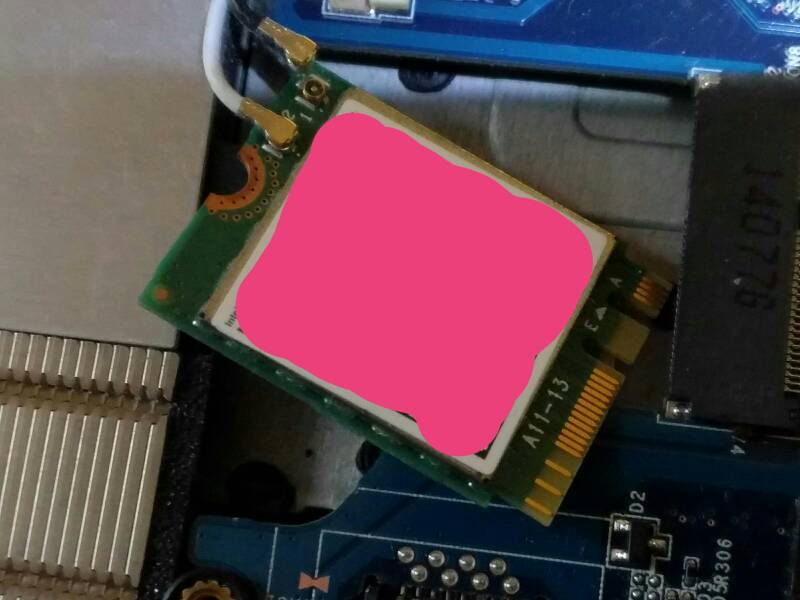

Just found out about this awesome world of eGPU's. Been googling and reading like crazy but some questions have not been answered.
I have planned on building myself a eGPU rig with Nvidia 1060 (or 1070), exterior, an appropriate ITX-psu and perhaps a better cooling system.
But I'm not sure which of the two docks would suite my need the most. Personally of what I've seen the PE4C seem to be more robust, but I have no clue.
The only slot I have is a NGFF/M.2 slot? (Not sure, pic below)
And I can't seem to find info on speed comparison/numbers between Mini PCI-e, Expresscard and NGFF/M.2
Will performance be nerfed by the fact that I have that slot?

Hi omenchild,
What you have is either M.2 A or M.2 E slot (doesn't really matter). NGFF is an older name for it, when it was just introduced. If buying PE4C, go for the one with M.2 A/E connector. If EXP GDC - look for "NGFF EXP GDC", it has a A/E connector as well. I'm waiting for the latter to be delivered actually.

Hello.
I have been researching heavily since I started this thread and a lot have been answered and cleared up.
I have an M.2 A/E slot and it provides x4 lanes so the nerfing(?) Will be minimal with current High-end cards only losing around 3-8℅.
